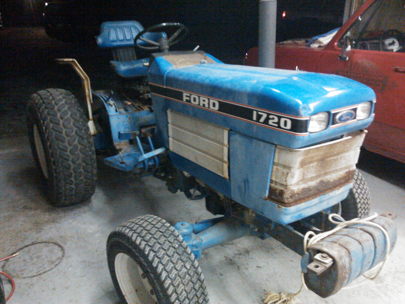

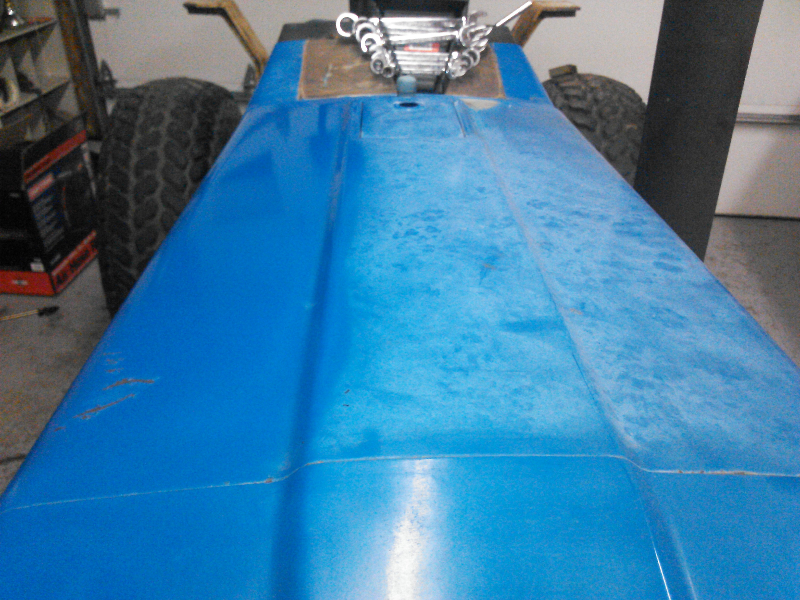

I was working on a buddy's Ford 1720 diesel. He had some of a brand called whites number7 wax on the shelf. It took faded chalky paint, and made it to where I could see my reflection. Highly recommend. Will put up a finished picture when the whole thing is done.

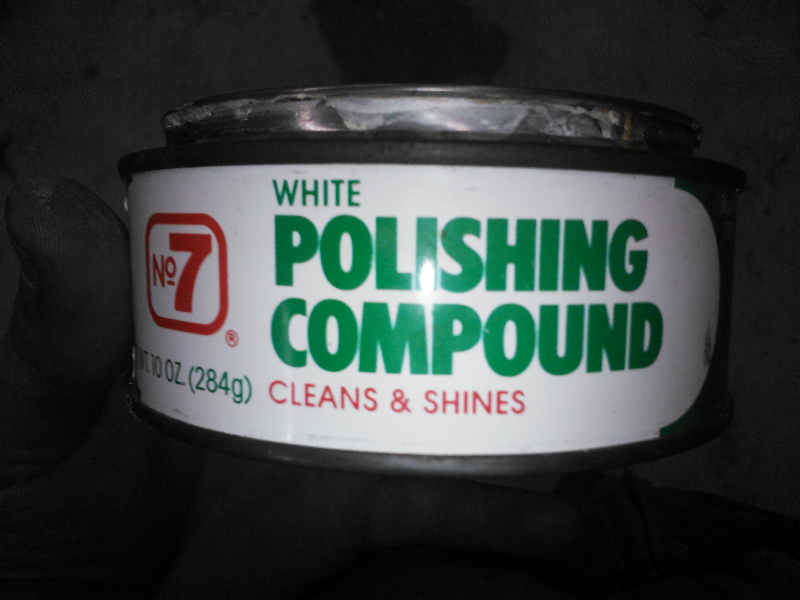

Here is The product I was using. Good stuff. I went back over it again with some turtle wax, super hard shell, and man it looks even better. More pics to follow

It is not a wax but a fine grinding compound. Have to apply a wax after using it or the shine will not last long. Use to use it all the time in the old days when you used nitro cellulose paint. Always compounded it to the final shine.
