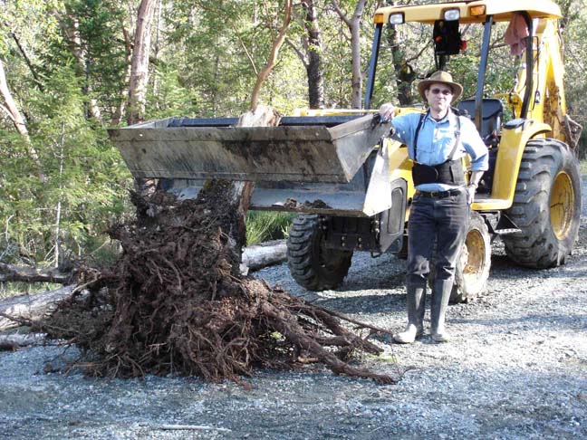

This stump took about an hour to get out, when I first got the machine, probably half an hour today.
The root ball is heavy enough that it would tip the tractor forward when I carried the stump down the gravel driveway. It is a little hard to see, but my ground is very rocky and the roots are intertwined around a lot of football-volleyball sized rocks.
My manual is in Oregon and I am in CA, but I think the top speed of a 110 TLB is 13-14 mph. Don't know have fast the Ag tractors are.
The yellow machines are built for moving dirt. Day in, day out, move dirt for years. The green ones can be used to move dirt, but are built more for ag use. Move dirt every day for a year and they will not last as long.
