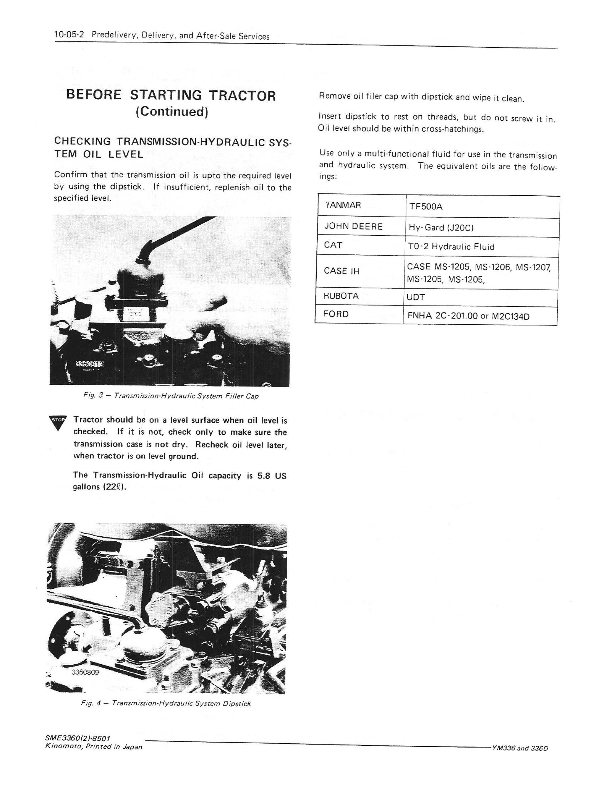

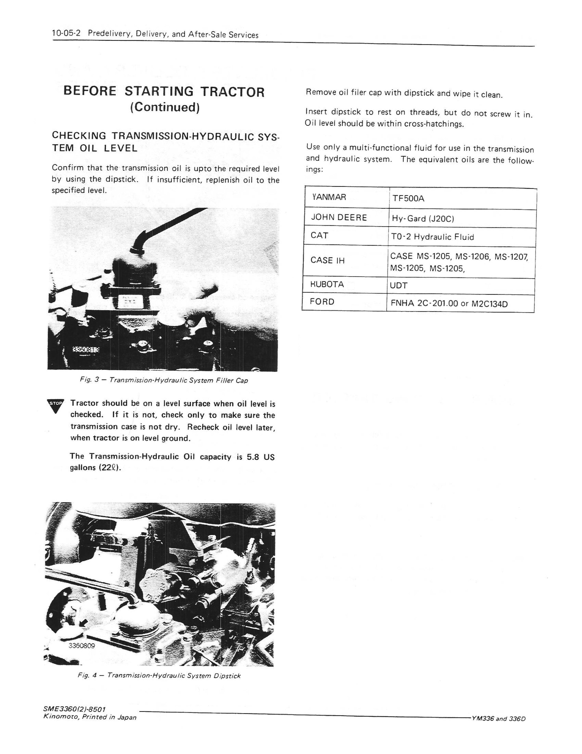

Oh, one important question, what hydraulic fluid are you using? The wrong fluid will not lift heavy loads.
Only these JDM J20C fluids work.
