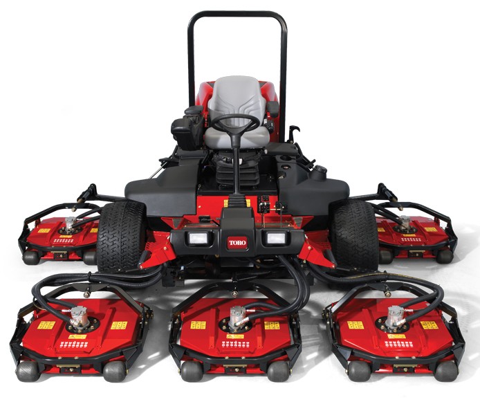

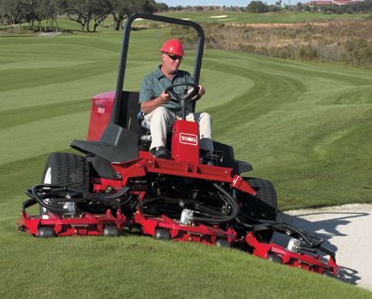

How about this one?
TORO Groundsmaster 4500
