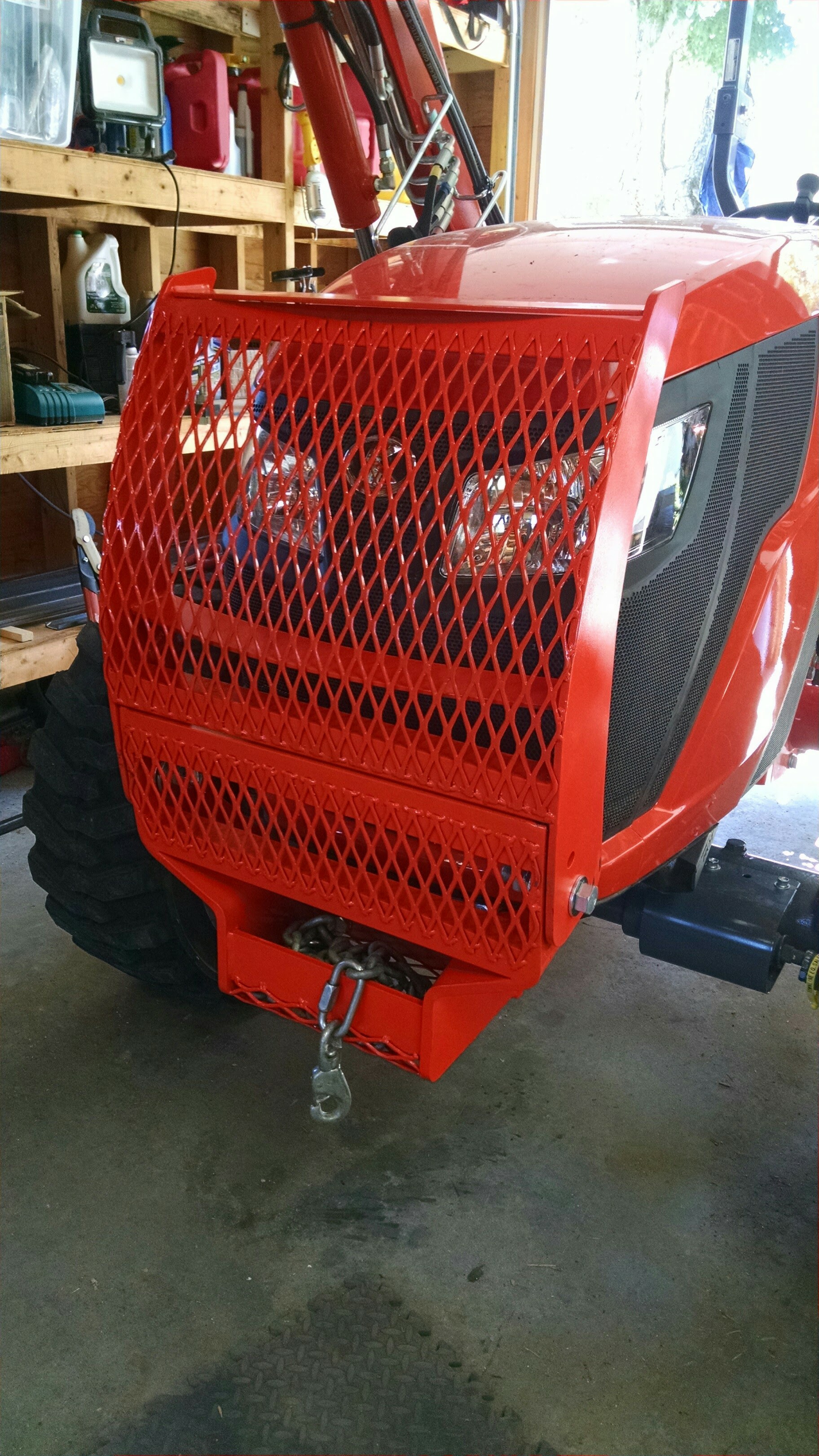

Still needs painted and it’s nothing fancy but after extensive brush and grapple work and replacing and upgrading the bottom part for a 3rd time its works great. 1/2 thick by 12 inch tall bottom section hangs down quite a bit to help prevent those low lying branch sneaking under. All of it hangs out on the sides as much as I could and still not interfere with front end loader.
Keep in mind you need a bit of gap between top and bottom so you can still tilt the grill to open the hood.
/ Grill guard - temporary #12
Here is how I fabed mine. Be sure to use 9 gauge expanded metal not the cheap flimsy stuff.
