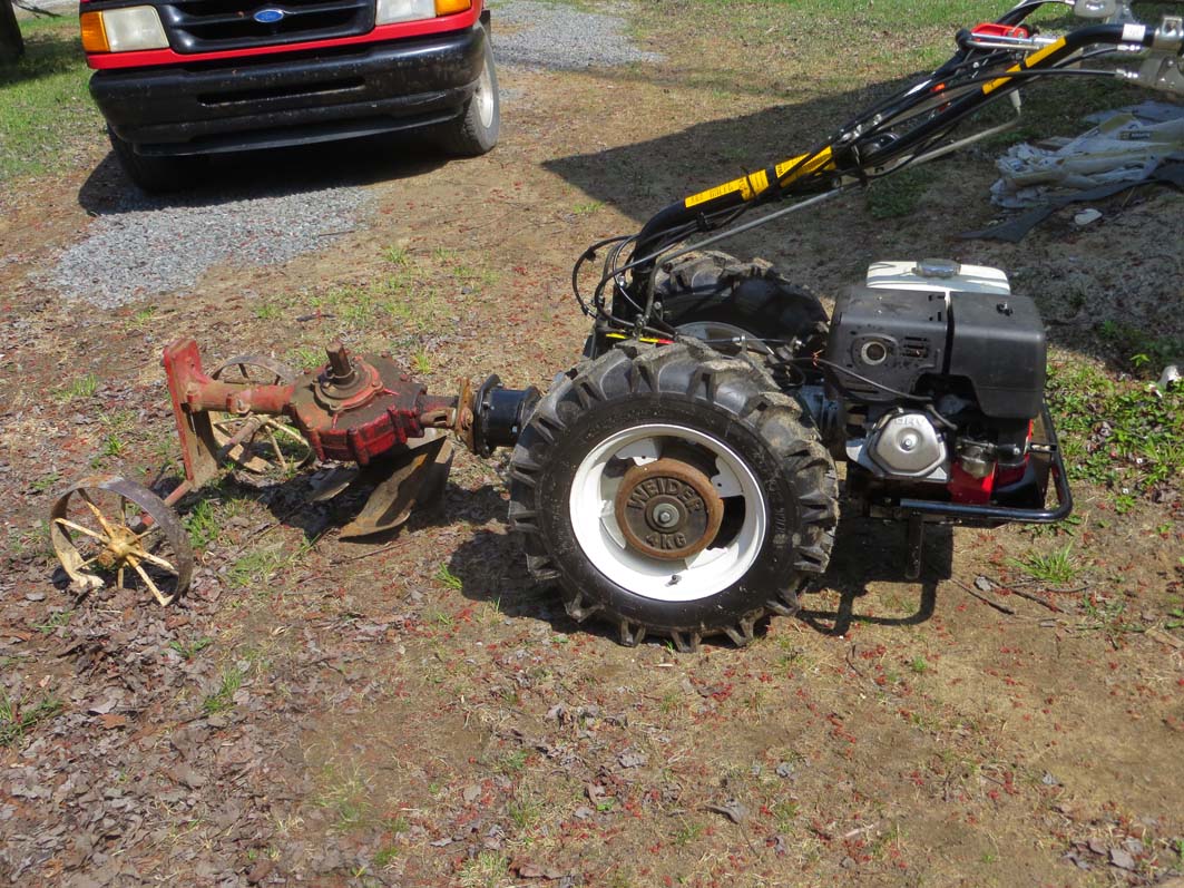

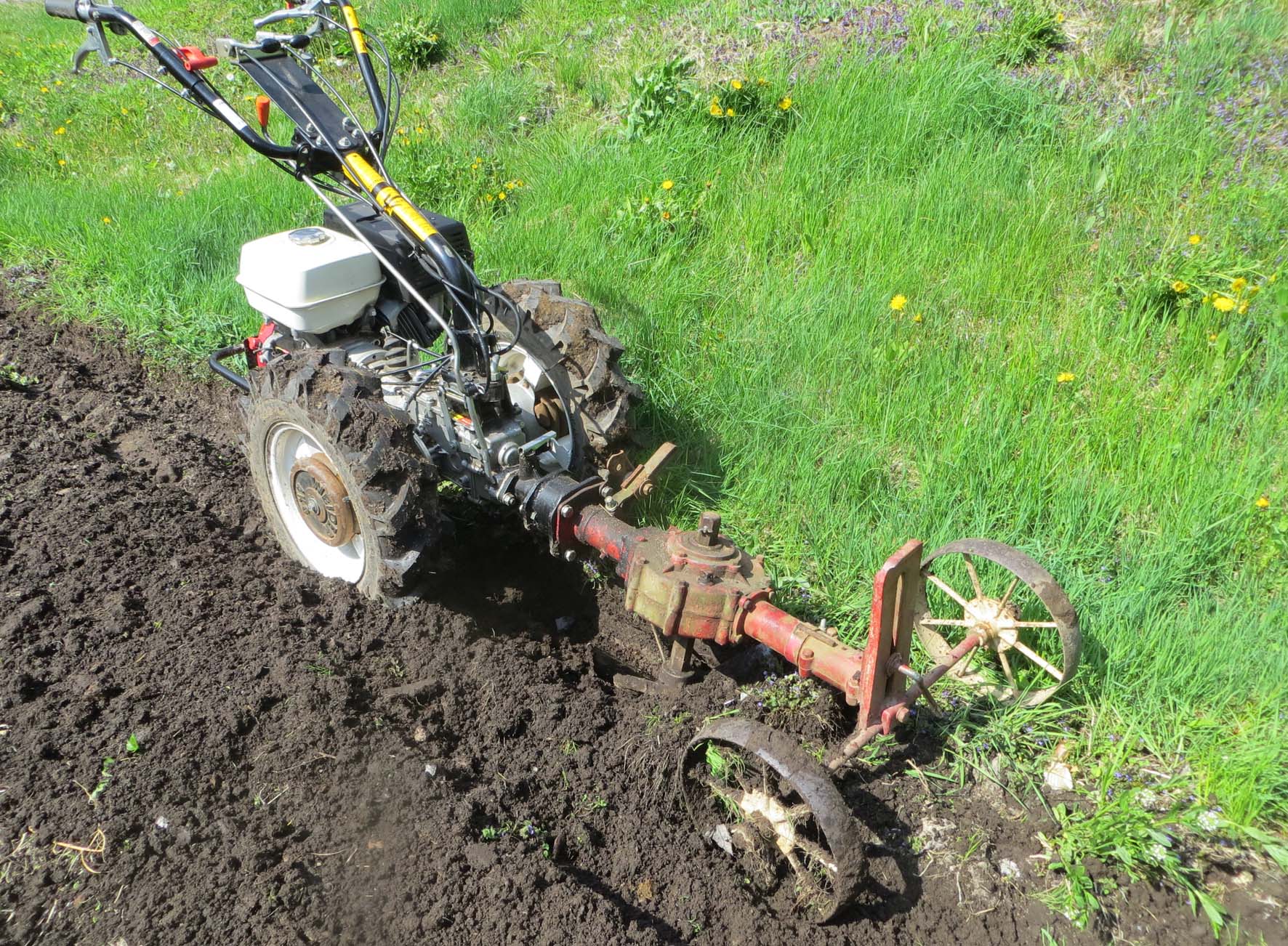

grirota.jpggrirota2.jpgHi! I can use Old Gravely implements with my Grillo via my homemade adaptor.
I try the rotary plow for first time this year. Run pretty well.. I like old Gravely implements. They have one adjustable safety clutch. So I can adjust the clutch for slip on big rocks or big roots . Can protect gears and shafts on tractor and more safe for operator.

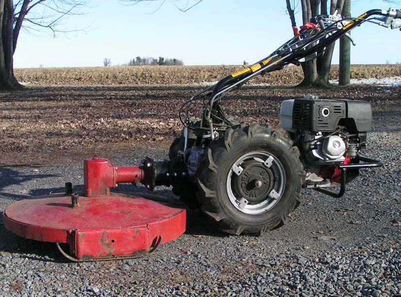

For Gravely rotary mower 30 in. I dislike because if you press Grillo clutch lever the tractor dont stop. The heavy 3/8x3 in.x30 in. rotary blade act as a flywheels and push the tractor front. Can be dangerous. You must press clutch lever and pull PTO lever off for stop the tractor. On Gravely the PTO is live and truly independent .With Grillo (and may be BCS) the PTO and driving gears are on the same shaft. Grillo and BCS mowers have a ratchet device so when you stop the mower turn free and dont push the tractor. Good luck! Oldmechgrigramo.jpg

Love the reuse of older implements. Thanks for the pictures.
   / Grillo with Gravely rotary plow #3
Nice pictures. That soil looks good too - please send me some :)
