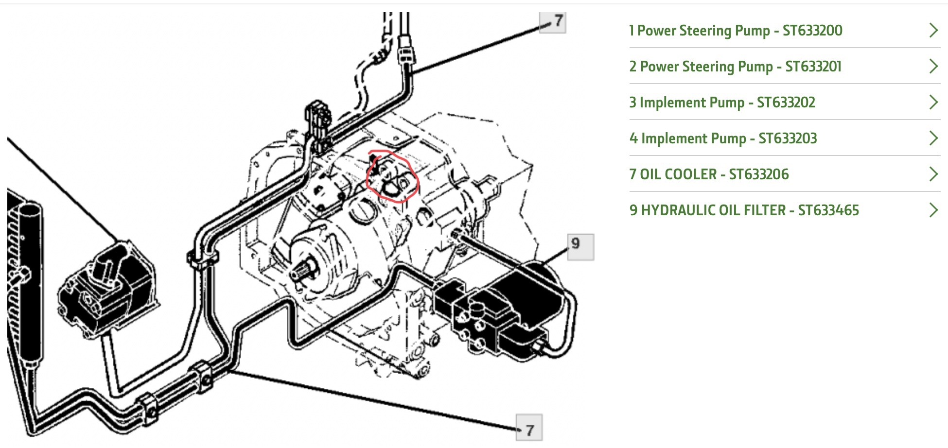

I picked up a JD 4600 this summer (I already had one and just wanted a familiar spare) and it runs pretty well (1400 hours) but in high range in reverse the HST really groans and doesn't have much power. Lower ranges seem to be fine, and high range in forward seems to be fine. I haven't yet drained the hydraulics or changed the filter (it appears to be recently serviced) Any thoughts on why this may be happening. I'd hate to change the fluid with the expensive HyGard and filter and such only to have to drain it again to split the tractor to repair something in the hydraulics. My other 4600 HST that I'm in the process of overhauling (5000 hours), the HST works flawlessly. On that tractor I had some difficult to repair due to the location engine oil leaks and just decided to overhaul it due to the hours.

Based on your description I would also have you pull the high pressure relief valve for the reverse direction out of the hydro and inspect. You may have a piece of contamination partially holding open the valve. In the lower ranges the system pressure is also lower so a high pressure leak isn’t as obvious. This could also explain why you don’t experience this in the forward direction because that is a different high pressure relief valve.

Thank you. I'm guessing this requires splitting the tractor?
   / Groaning sound in reverse in 4600 HST #9
Maybe, sometimes you can access them without. Do you happen to have a tech manual for the tractor?
If not, those valves are really right under the seat but you have to access them from the front direction. I don’t know if Deere put in any access holes in their tunnel.
I took a picture of the layout and have attached it. The fwd and rev valves are circled in red. I don’t know which is which.
