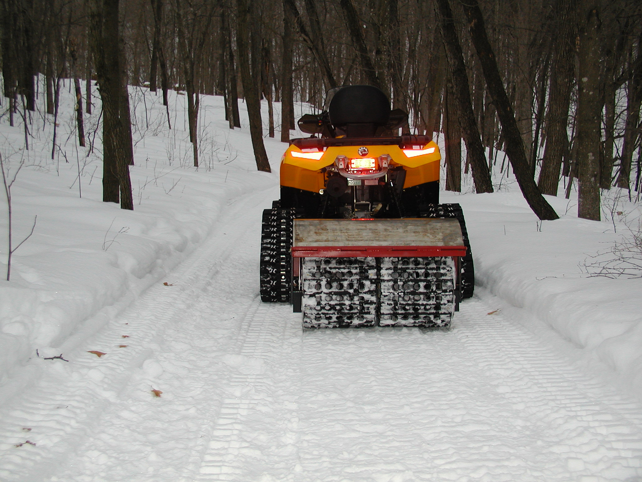

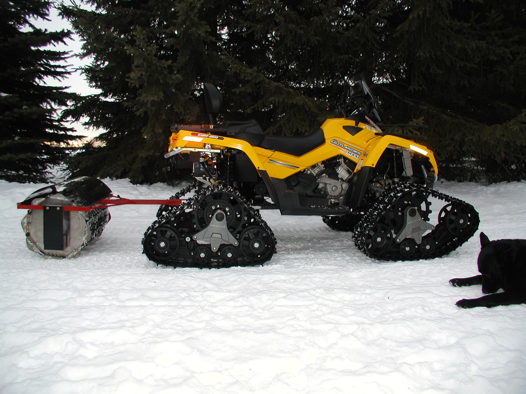

DSCN0463.jpgDSCN0464.jpgDSCN0467.jpgDSCN0468.jpgI have been building snow groomers for about five winters now. The last couple have been roller groomers because I find that mostly I want to pack what falls so it is more dense to support traffic (Wheeled ATVs, walking, down hill sliding, etc.). The past two seasons I finished and tested Groomer4, which was a 31 inch wide roller type. That one was pulled by a tracked CanAm ATV. That was a great small rig and very capable in any amount of snow, super manuverable, dependable. There were a couple things about it that bothered me though. On some of my extreme sidehill trails, the 31 inch roller would occasionally flip over upside down in deep snow because it was a bit too narrow for its CG. Also, the lack of power steering on the ATV bothered my elbows after extensive grooming sessions of several hours each time to cover all our private trails. And, I always made a couple passes to widen the trails out, which took extra time of course.

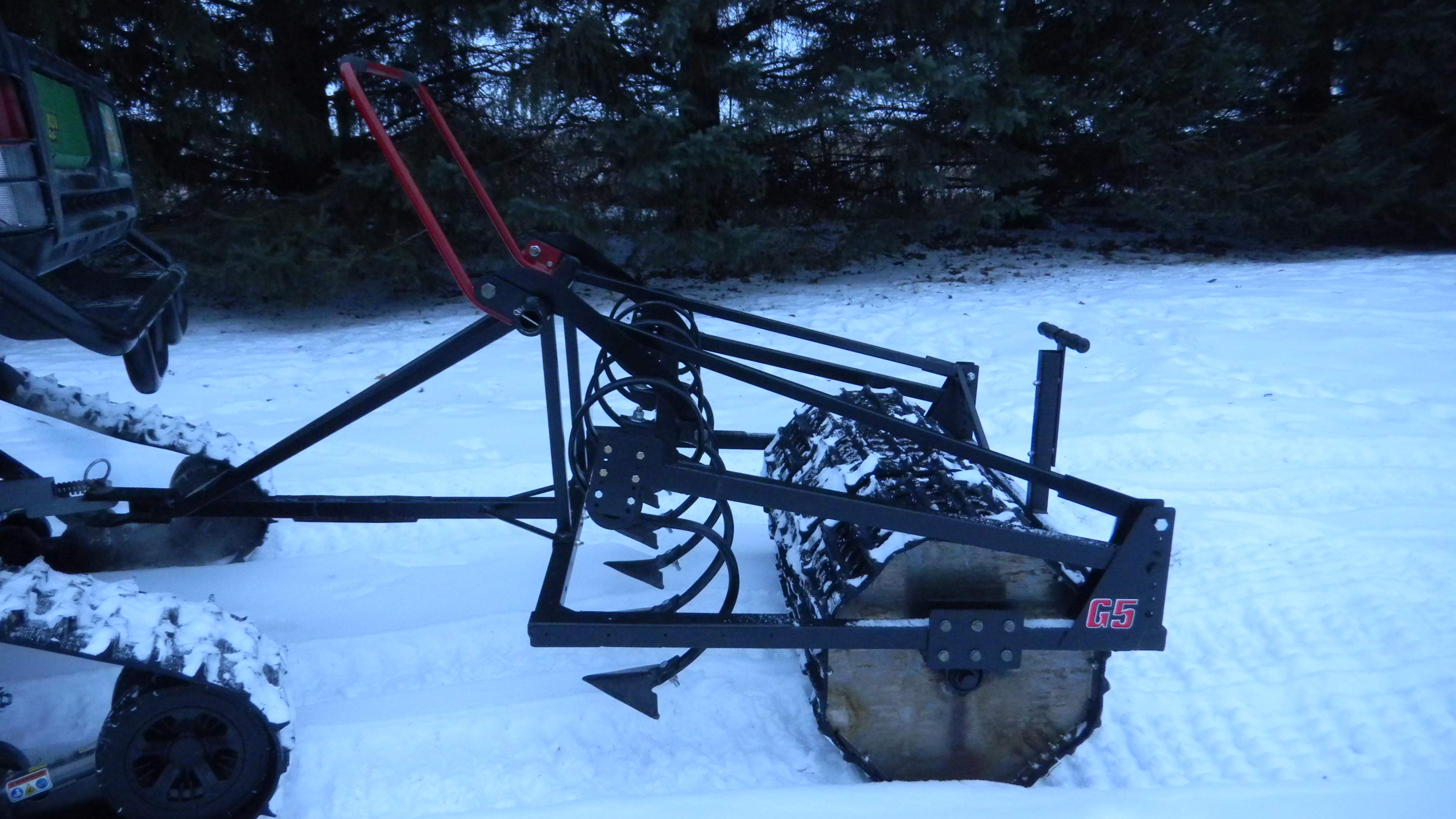

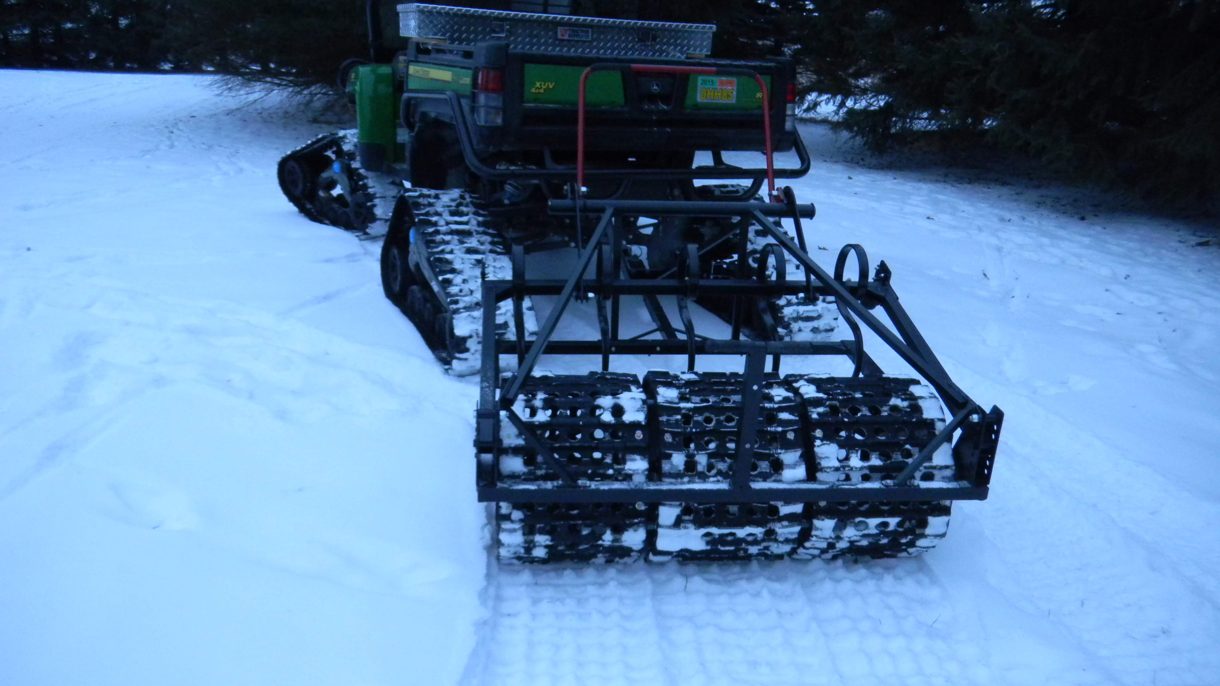

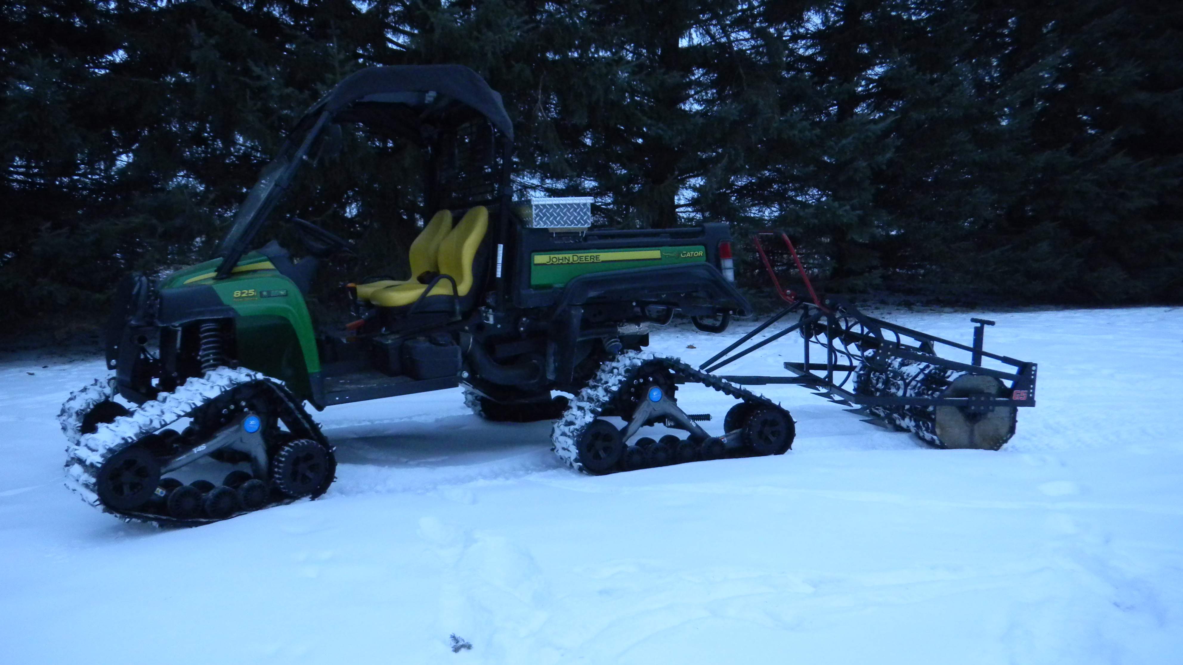

So last year I sold Groomer4 and began designing and construction of Groomer5, with the intent of making it wider, and pulling it with a tracked Gator with power steering. This has finally all come together, and is working very well. I am now grooming six feet wide in a single pass (up from the four feet of Groomer4 and CanAm), I have power steering, the Gator is warmer with half windshield, I can haul along a buddy to help clear downed trees, the chainsaw and other tools ride in the box neatly, and the roller groomer is wide enough to not have the roll-over tendency that Groomer4 had.

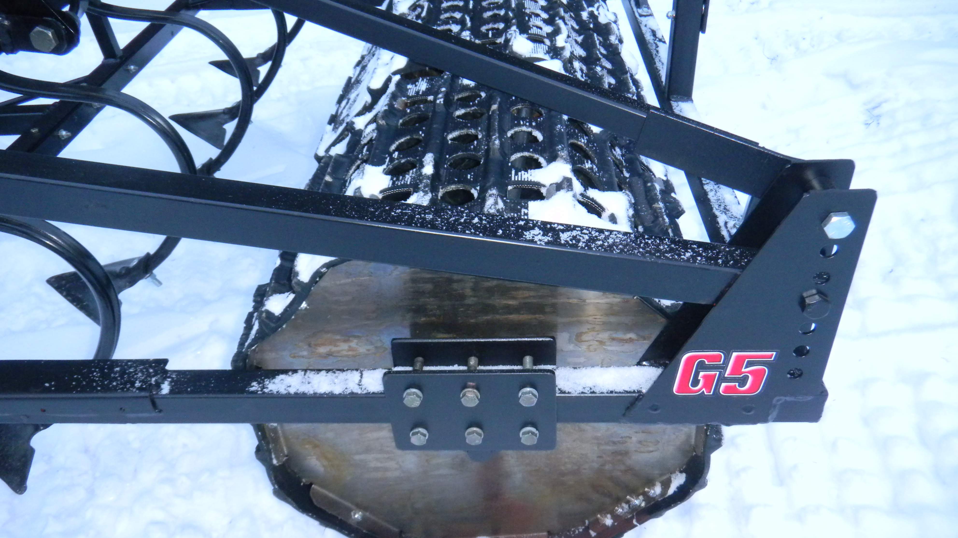

The roller parts of these groomers have been built with snowmobile tracks which are too far worn or torn to be used on sleds anymore, so very low cost. There are a few other tricks to the idea, which make them more effective at packing the air out of snow. Groomer5 is now experimenting with a variable-height toolbar, on which I have mounted Danish tine springs and sweeps as a first pass "tillage" tool. I have a couple more ideas of shapes that will mount on the Danish tine springs instead of the sweeps, and as time goes by I will try those ideas. When the "toolbar" is not being used, it is raised and provides needed weight to the rolling assembly. I guess its time for some pictures. The CanAm and Groomer4 have appeared on TBN before, so may look familiar.

Snow depth: It works out best ( I get the most durable surface) if I get out and roller groom after every 4-6 inch snowfall. I have waited longer and groomed a foot, but it does not pack as well of course.
Weight in drum: Yes, becasue it fills with snow as I go.
Support Tractor? Yup, it sure does. Of course it breaks down with traffic or spinning of tires, its only icey snow. some care is need if operating tractor in woods trails on hills when icey of course.
Reduce ruts? This type of groming is more to prevent the rutting by packing first, before the traffic. The "tillage" bar that I added to this Groomer5 may do some remediation of rutted areas, it is yet untested.

Used the tracked Gator quite a bit in deeper snow last weekend. Drove it thru as much as 2 feet deep, without problems. The snow was very light and flew all over, and by the end of the day the CVT cooling inlet had inhaled enough snow and melted it that the belt began slipping. So I am going to have to snorkle the CVT cooling air inlet to a location up high under the canopy.
Also, it looks like the engine air cleaner inlet will also need to be snorkled, as some snow ended up inside the air filter too.
Other than these issues, overall it works well. I groomed a local snowmobile trail over plowed ground, which finally had a foot of snow on it to effectively cover the dirt. I let it freeze a day or so and its now really nice. Rode snowmobile over it last night and it is bump free finally.
Sometimes when the snow is too deep (10-12 inches of fluff), the roller stops turning and starts plowing. It is tough to see the roller, so I might need to add some kind of monitor, like a bicycle speedometer or something, to the roller to verify it is turning. If I notice it stops turning, I can stop the Gator, back up a few feet, then take off again to get the roller turning again.
