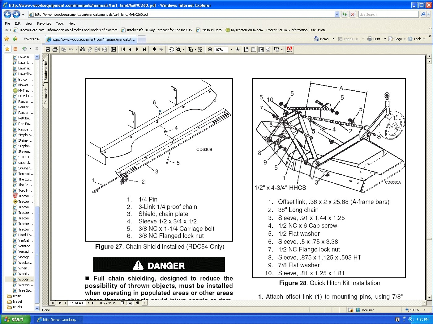

I put on the imatch bushing kit for my Frontier grooming mower(GM2072R) and was just wondering if it's right that the toplink connection of the mower, which has a floating connection, just sets in the imatch- seems like if the mower were to bounce or hit something it might bounce out of the toplink connection- and it's a little difficult to hook up by myself if the mower isn't perfectly level. Thx,

You need a imatch conversion kit for the grooming mowers. I think it is WP1005400
This will convert your top link to a fixed point and give you flexibility to the rear of the mower.

Here's a diagram of the conversion kit. It has a couple of vertical pieces that hold the top link down into the iMatch hook.

Thanks for the info, that makes a lot more sense- I got hold of my dealer and he forgot to get that piece :D
