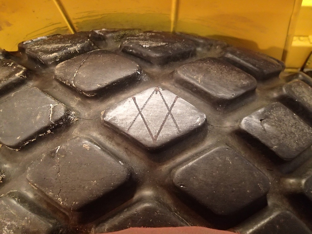

A box cutter with a new blade, if dipped in gasoline will slice right through rubber.
That is how we use "Sharpen" the tires on dirt bikes.

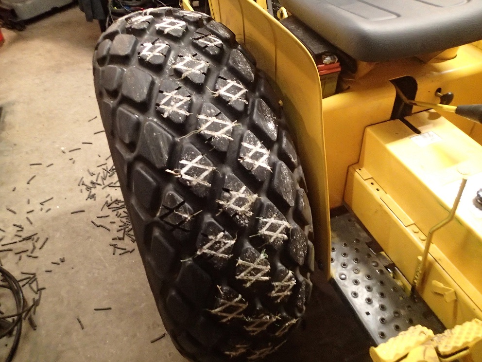

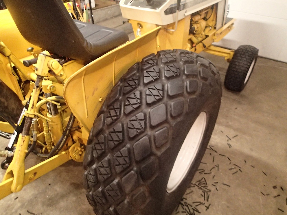

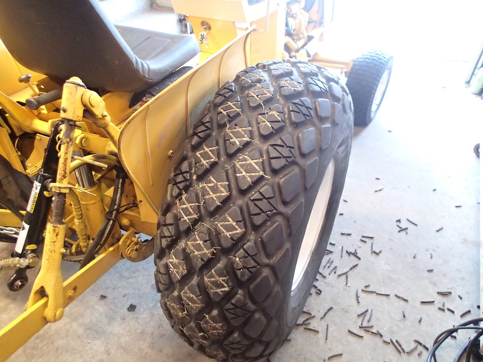

The one tire took about 1.5 hours to cut, but there was a learning curve and I did it over 2 days. I'd be willing to bet I could do the other in an hour now that I know what I'm doing and I only have to rotate it once.

Update:
Since grooving the tires we've received 10-15" of snow. Without a plow my only option was beat a path around the house. The grooved tires pushed through the drifts with ease. When I did spin the tires I would simply back up and make another pass at it. Once packed down it was as good as grass.
With confirmed snow traction my desire for a plow increased daily. With 10" -14" in the forecast I need a plow and I needed a plow Quick. With no time to fabricate a proper plow the focus shifted to how fast / how cheap can I push snow. That night I made a couple of inserts that would fit in my multi-hitch receivers and bolted on a 60" piece of 2x12. All in all, probably $30 bucks worth of materials and an hour to build.
Yesterday was the test. By the time I got home there was 10" on the ground and another 5" -7" expected over night. Eager to test it out I fired up the tractor and got plowin'. The 60" plow made quick work of the snow, plowing the driveway in 35 min (a 90 min job with the blower). With the driveway cleared I started on working on the path to the wood pile. Again the plow exceeded my expectations; I could push the 10" from today plus the 10" -15" already on the ground from previous storms.
This morning I was greeted by 5" of fresh snow SOAKED by a midnight rain. You know the kind of snow that's so dense you can walk across the top even when it's not frozen. Yea that stuff. Normally in a situation like this I'd call in late to work and spend a few hours clogging the snowblower, I mean clearing the driveway. However with the tractor sitting in the garage I turned around and said "here's your chance". I backed out of the garage, dropped the "blade" and pushed a 60" wide path 117 feet down the driveway & across the (unplowed) street. Smiling ear to ear I proceeded to plow the driveway in 15 min, put the tractor back in the garage and still got to work on time.

I'm thinking that grooving your tires will improve traction in just about any situation without decreasing flotation at all. Good idea.

It would be interesting to see how a forstner type drill bit would work for "grooving". I'm thinking maybe a series of holes maybe 3/4" diameter at about 1/4" depth.
The forstner type bit, for those unfamiliar, is flat bottom. A depth stop on the bit would be almost a must, I'm sure.
Edit: Looks like I accidentally resurrected an old thread.
   / Grooving / Cutting R-3 Turf Tires For Better Snow Traction #20
It would be interesting to see how a forstner type drill bit would work for "grooving". I'm thinking maybe a series of holes maybe 3/4" diameter at about 1/4" depth. The forstner type bit, for those unfamiliar, is flat bottom. A depth stop on the bit would be almost a must, I'm sure. Edit: Looks like I accidentally resurrected an old thread.
I'd say it would fail. A router might work though.
