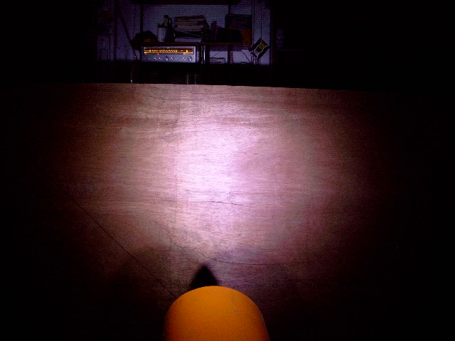

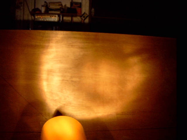

I ordered 2 1156 base 30 l.e.d. arrays from superbrightleds.com. Had to modify the bulb housing slightly to get them to fit. Here are pics of bulbs versus l.e.d.s with exactly the same lighting conditions in garage. Not a very scientific test but so far I think I like the leds slightly better-more concentrated light. Cost was decent, I thought, at $15 ea plus shipping. A heck of a lot cheaper than Grote. Thanks to milkman for the original lead on superbright.

I have a B7100. The metal housing around the lights is formed to the glass so it won't come apart. The 30 led array is too large to fit through the bulb opening so I made several small cuts around the perimeter of the opening, bent them up enough so that the array would fit through, inserted the bulb, connected it to the socket, then rebent the housing and twisted the socket in and then replaced assembly. I didn't really want to cut the housing either but in my application, I didn't see any other choice except going to a smaller array that would fit but then you sacrifice output.
