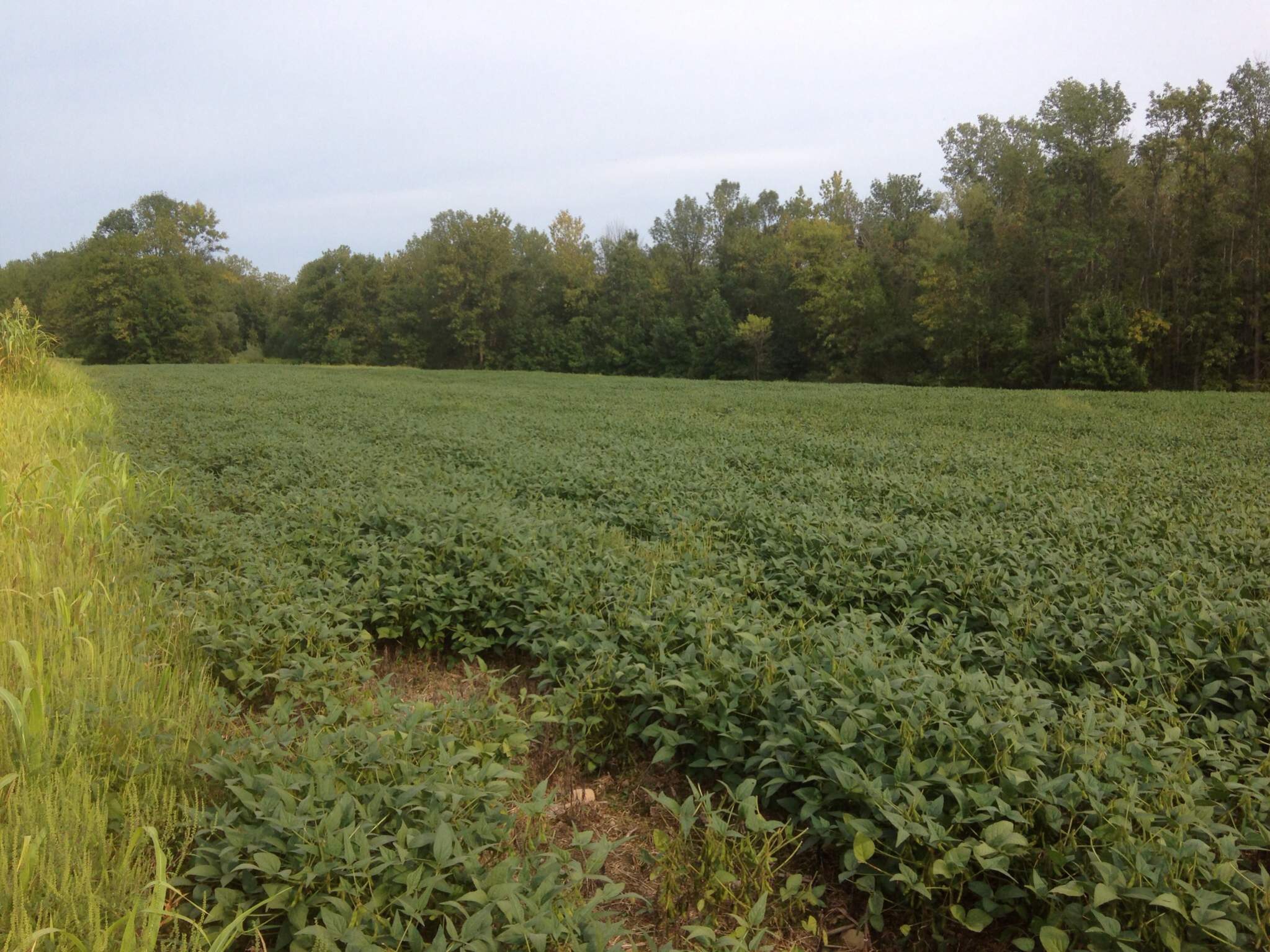

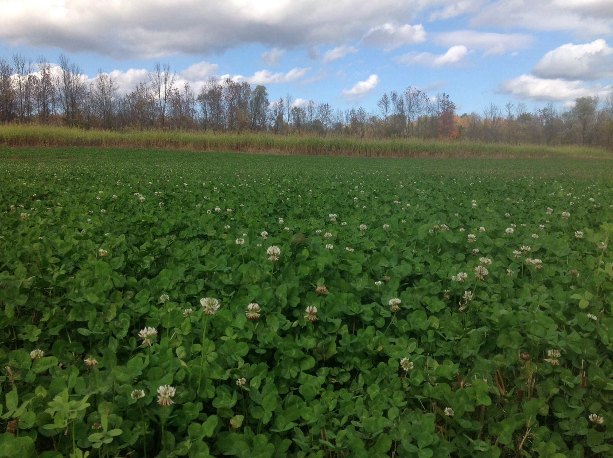

I use a 7 shank on my 88 hp tractor and I wouldn't want to go any bigger, but I use the turning blades and that adds to the drag. I can turn stubble/sod with no problem and hitting it a time or two with a heavy disc dragging a harrow and it's good to go.
Depending on your soil, take a serious look at getting scrapers for your disc, I would be dead in the water without them. Good luck!
Here's that same field 4 months later with clover and Egyptian Wheat
I use the Egyptian Wheat to divide the field up and on the other side is soybeans.

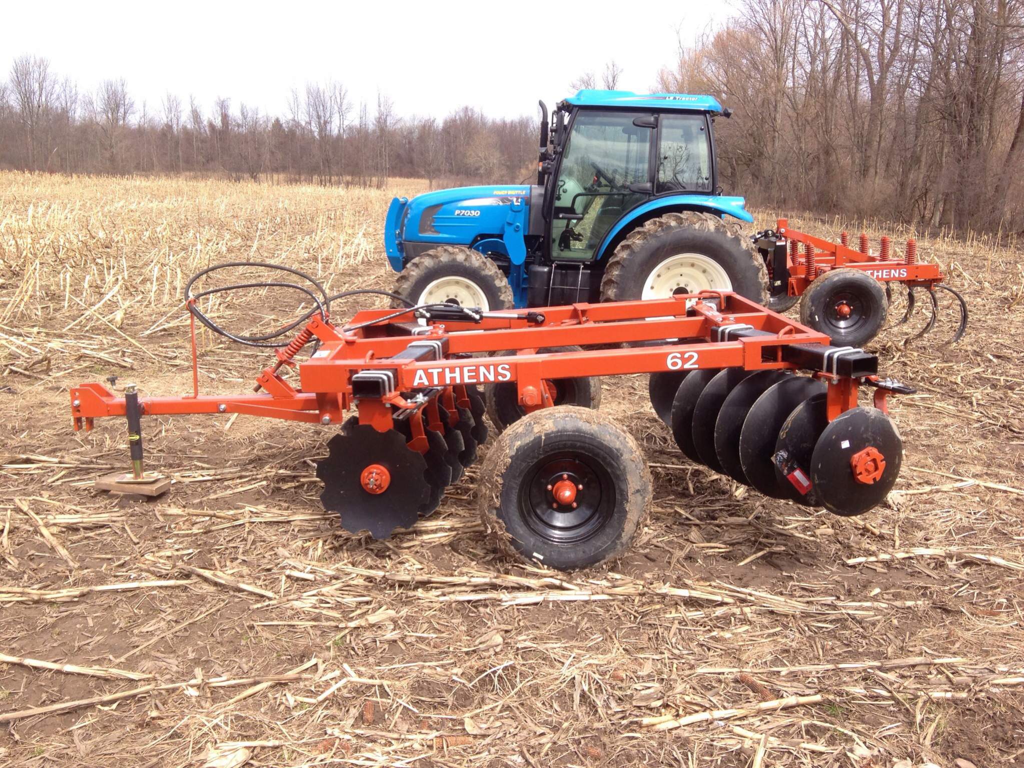

I have about 5-6 acres that I do in food plot rotation and I have a plow, disc and a tiller. 90% of my tillage for my food plots is done with my 6 1/2 disc. It's a little light but 500# of weight got it to the point where I can get the soil worked up enough in two passes on virgin ground to be ready to plant. The good thing about 90% of the seeds used for food plots are extremely competitive against weeds and for the most part very forgiving planting.
   / Ground Breaking Advice #20
What is a 6 1/2 disc? Spacing between pans?
