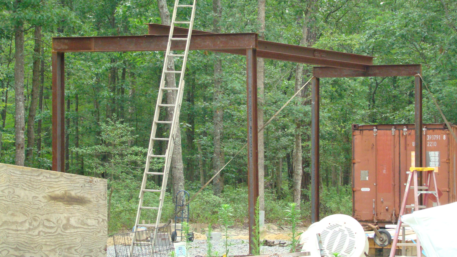

Thanks! Yes, I have read ten thousand pages that say you don't have to install new gr rods for a sub panel in a detached building.....other than of -course the gr rods required at the SE of the detached building. I am good with that but my installation is a little different than most as I have this big steel structure running through it and a 20' steel container in there as well. I extended the #6 wire from my two gr rods at the main panel to an extra one next to the steel tower. I planned to pull off that rod and connect it to the tower and on the other end, 30' away connect another wire and it go to another gr rod at the container and tie them together. I had planned to install another sub panel in that area to feed lighting and equipment in the back part of the building. I wanted to install this panel either next to or on the outside of the container and then the #8, 4 wire lead that feeds this panel will loop the ground wire back to the main panel at the front of the shop.
This picture does not show much but it does give and idea of how the layout goes with regard to the tower and the container I want to tie together. I thought I had more pics that showed every thing now that it is under roof but I can't put my hands on them right now. This picture does show just how much extra steel that is inside the building and it seems to me it should be grounded in some sort of way.
