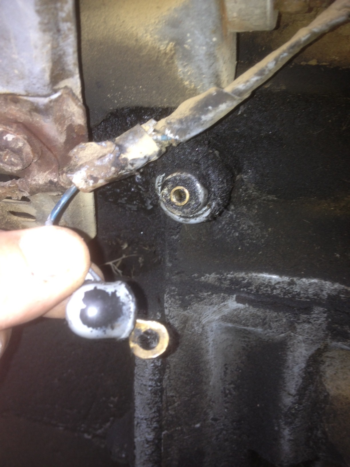

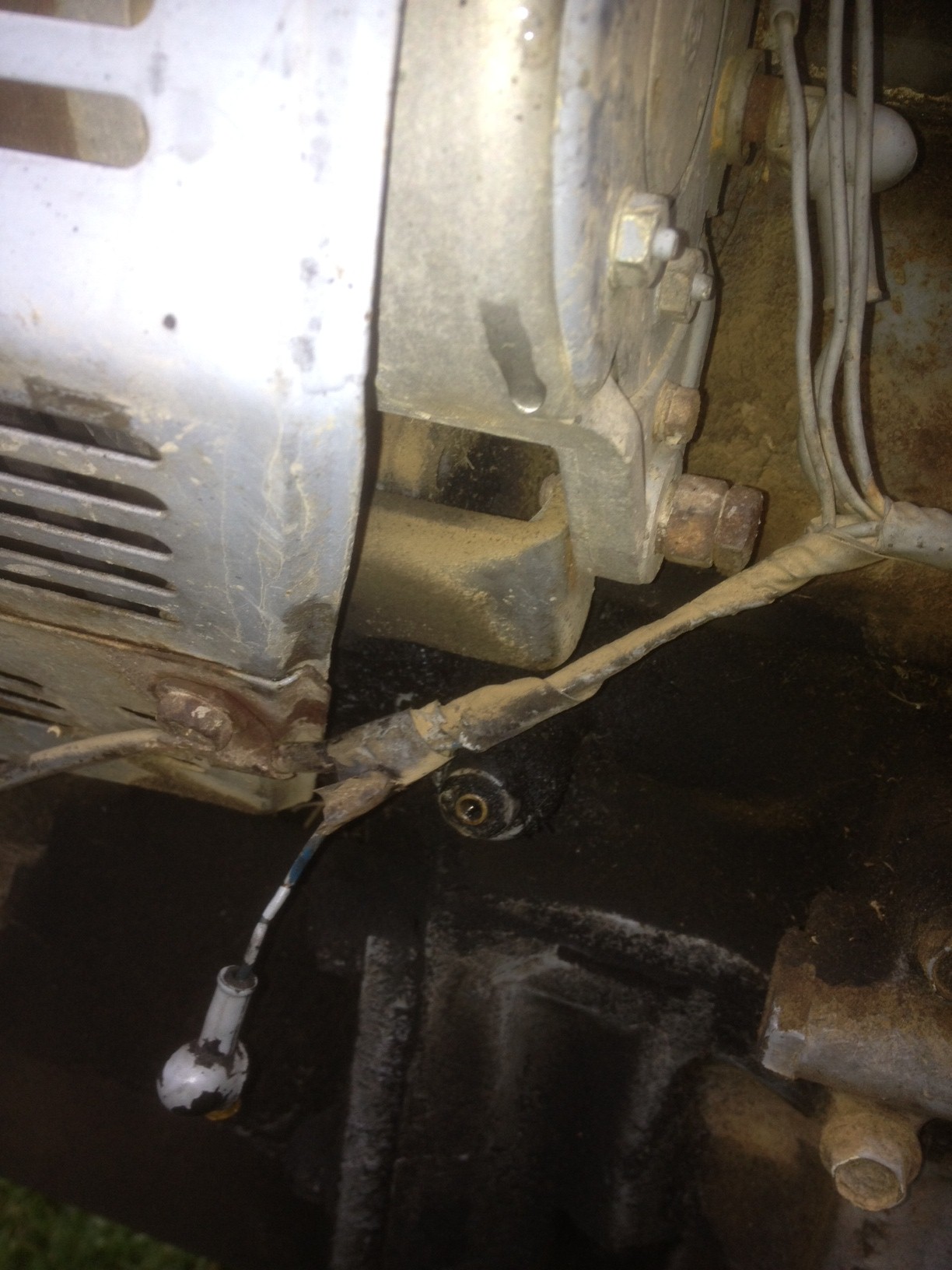

Hello everyone, I'm a diesel tractor and farming noobie. One of the new generation who has said "Goodbye city life" and moved to the country, trust me, I've heard every "Green Acres" reference possible. As a result, I'm great with computers and theory, but on a huge learning curve with any practical applicaton of that theory. I'm hoping one of you guys can help me out here. About a month ago I purchased a 1983 MF 210 to do some things around our new small farm and it worked great for three weeks but now, all of the sudden, it won't start. It turns over, but won't start. I start looking around and find a wire hanging below the alternator (generator?) and below that a place on the engine block where it looks like the wire should be attached. I'm thinking it's a ground wire that came loose but I'm not sure. I don't remember seeing it hanging loose like it is now but I don't remember seeing it attached either. I've included pictures. Can anyone help? I don't want to attach it, if it's going to cause a problem...

Well you can't start it now. I would attach the wire and see if it starts. It appears to be a ground because it's A) Black and B) seems to go to a ground location (engine block?) If it's the ground and it starts then there's no harm, no foul. If it doesn't then again no harm, no foul. Wires with connectors like that don't hang around unused.

I'm not familiar with your model of tractor. Is it gas or diesel? That wire doesn't look like a ground wire to me and I wouldn't attach it until I figured out where it really went. You might let the smoke out of something! If you have a volt meter, check the voltage between the terminal and a good ground (engine block) with the key ON. If there's voltage there then you'll need to find out where it goes. Even if there isn't voltage, you don't want to hook it up until you know what it's for.(This is where wiring diagrams from a shop manual are helpful. they have the color codes for the OEM wires listed in them.) trace it back to see what the other end is attached to.

I'm not looking for someone to diagnose the root cause of the problem, I don't know if that could even be done in a discussion forum. I was just hoping that someone else has a MF210 and could tell me, based on the pictures, if the cable that's hanging is supposed to be attached to where it looks like it should be attached.

I know nothing of that Massey, however, that sort of looks like a sender unit of some kind in the block, and that wire looks like it snaps on to that..That does not seem like a ground to me. perhaps someone disengaged the wire before you got the tractor and you just now notice?.. As for the cranks but no start condition. Lets start at the basics.. You did not run it out of fuel did you? And then put fuel in and tried to start it again? Unlike gas engines diesels will not start if ran out of fuel without bleeding out the air first.. Does the tractor have an automatic shut off solenoid that is activated by the key or was/is there a fuel shut off lever to pull or push to shut down the engine. As you know diesels are not shut off by removing ignition as there is none, but later models will shut off by the key by activation of a fuel shut off solenoid. Another photo of that wire and possible destination would be good... The fuel shut off solenoid is normally attached to the injection plump. Things to remember: If the diesel can suck in air, and has timed fuel being injected into the cylinders. (mechanical injector pump) and has compression, and you can crank it over reasonably fast, it MUST start, it has no choice. Lets have another photo or 2 to kinda look around a bit, and tell us about the fuel situation..

the more I look at that wire, and where it might go on the block.. maybe oil pressure sender? Could there have been a brass screw that went thru the screw terminal under that rubber cap (is that what I saw?) and screw into the brass threaded? portion of an oil pressure sending unit? I just cannot be sure from the photo's

Your tractor is made by Toyosha in Japan, have smaller model 205 with 2 bottom plow I use for garden tractor plow days. Check just under alt, oil pressure lite switch should have a wire on it as mine does, could have gotten knocked off. How long are you holding glow plug switch on, will need at least 30 to 60 seconds preheat to start engine depending on temperature. Also make sure shut off rod is in run position if it has one, some tractors shut off with throttle lever instead.
That's what it looks like to me. Now, if the tractor thinks it doesn't have oil pressure, would that make it shut down or not start?
