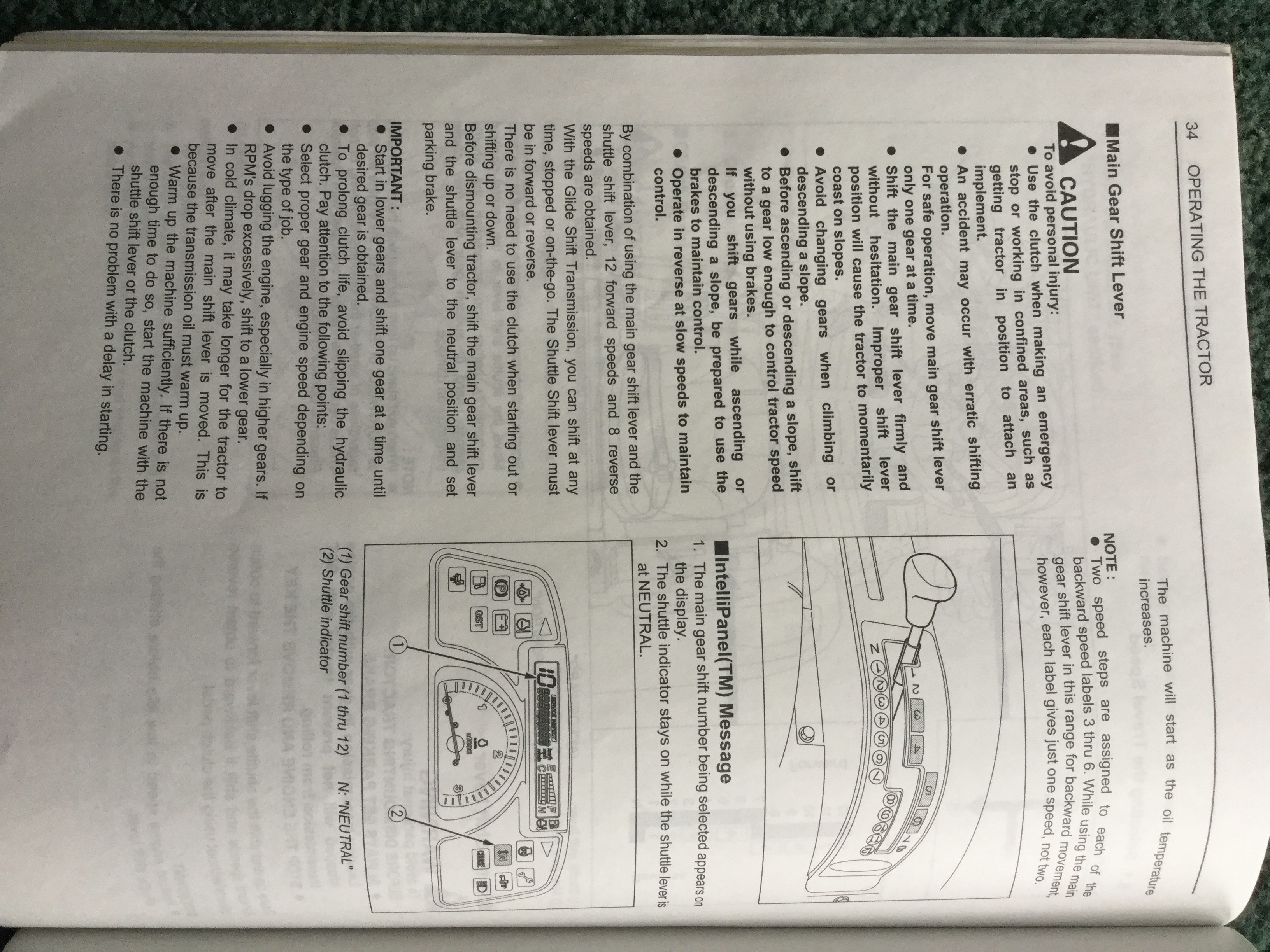

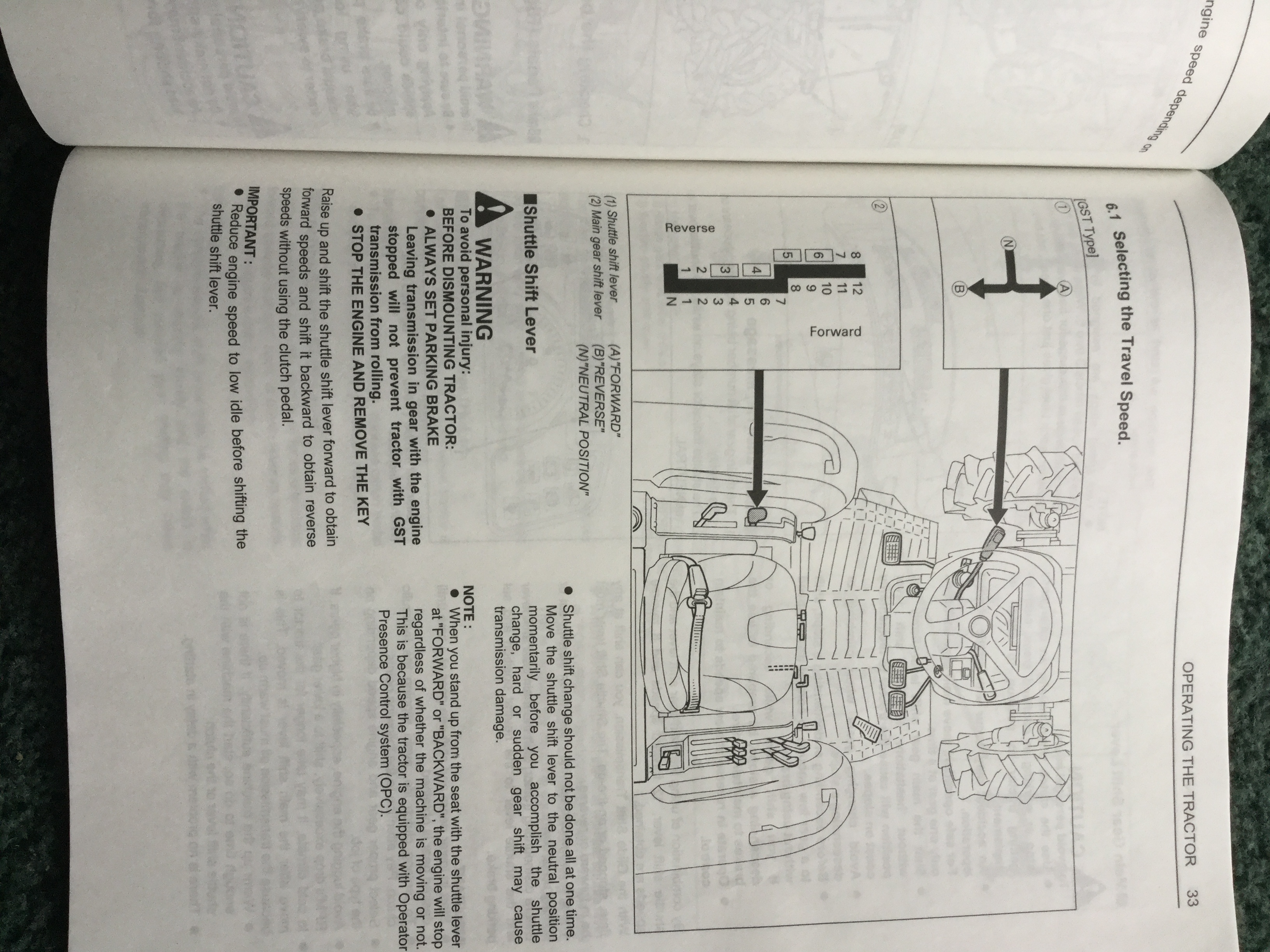

Here's my GL4330 manual info on the GST transmisssion. Sorry they are rotated:

If bush hogging and I needed to drop down a gear can I do that without lowering the rpms with the GST, but it will have a slight hesitation correct?
Does the tractor free wheel during this slight hesitation when going uphill?
No need to. It will help prolong the wet clutch life, but they are pretty robust & designed to take it for years.
