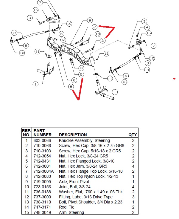

Just bought a used 2011 gt 2000 with 93 hours on it. Front axle has some slop, I don't think the previous owner ever greased the zerks on the steering or front axle. Anybody have a fix for this?

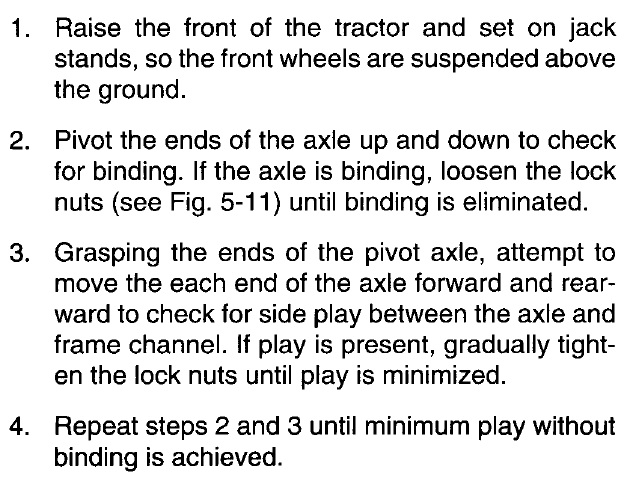

Cub usually has an adjustment to eliminate movement fore and aft in the front axle pivot. The bolts through the axle to limit its pivoting action are gradually tightened to eliminate any play and still pivot smoothly

Thanks Dave, I will give this a try.
