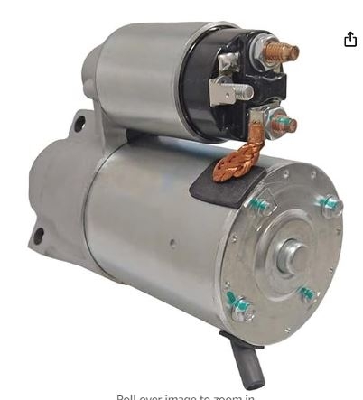

Thanks a great deal. I have a really dumb question; I know the battery POS terminalk, but where exactly is the starter terminal? Not sure i KNOW

On your starter you likely have what they call a piggyback solenoid. If that is the case, the solenoid is mounted on starter itself. Your + lead goes to the starter lug direct and then when the key is turned, a smaller trigger wire (right next to it) should have 12 volts when the key is turned.
On models w/o this style, you have separate solenoid. The big lug on the starter is all there is. You could jump direct to the starter lug w/ a separate battery or the + lug in the tractor. It will likely spark- so make the last connection at the starter and not with fuel in the area to ignite.

OK I looked up the starter for the CC GT2550. Here is a photo of it.
If you put a jumper from the battery positive post to the lower terminal on the start solenoid, the starter should spin. Make sure that the off/on/start/ switch is in the off position. You don't what the engine to start while doing this.
There maybe some sparks, don't panic. Also be careful no to touch the jumper cable to any of the starter or engine metal.
