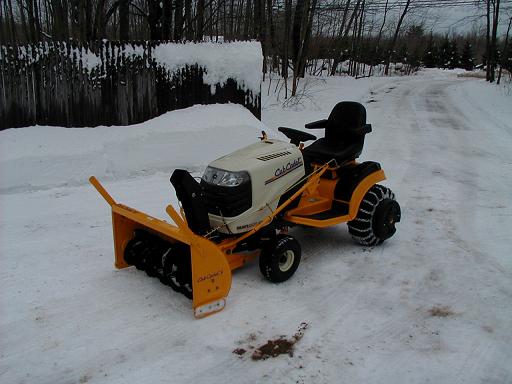

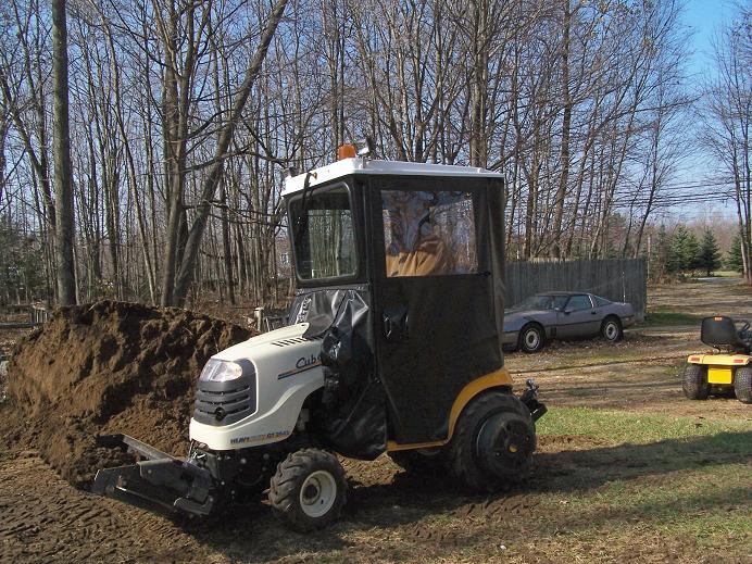

I have the same tractor and snowblower.
The dealer also mounted mine last snow season (I purchased it in Jan/06)
I just mounted the snowblower on the tractor last weekend.
I also have a bad back.
I took my time and followed the manual, it wasn't too bad.
I did have one problem with the snowblower last season...the exhaust melted the plastic covering on the chute control cables, when the cables cooled off the plastic would harden and the cables would be stuck...anyway, the dealer fixed it right away.
I am VERY pleased with the GT2542...it is a work horse and saved my back all year ;)
