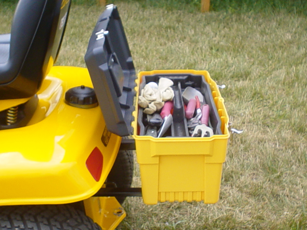

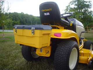

Hope you do not mind , the box on the back of your mower could you get a closer photo please :thumbsup:
   / GT2550 PTO Problem
Tracter, here you go. It is just a Stack-On tool box from Tractor Supply and couple of pieces of angle iron bolted to the frame rails.
