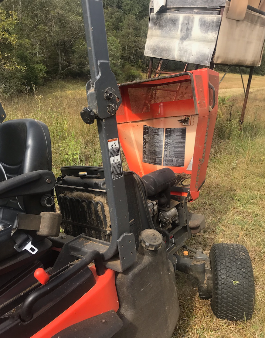

Only the second time this has happened. First time was the first year I bought it off of a member from here and scared the living crap out of me. Just kept riding not even thinking about it this weekend. Ironically enough, horn stil scared the crap out of me when I heard it and I'm pretty much deaf LOL

What are we looking at there?
   / Guess what went off and scared the crap out of me? #3
Is that in front of the radiator?
   / Guess what went off and scared the crap out of me? #4

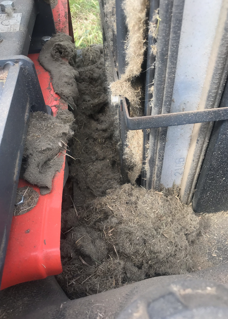

it looks like crap, but not from a human.. what made this happen?..
   / Guess what went off and scared the crap out of me? #5
How does that make you deaf?
I'm deaf to begin with, but I could hear that dog gone horn going off.
Hi temp "horn warning". Out back mowing (or bush hogging with the F mower) and just kept mowing thinking about things that needed to be done with work, and never once looked down at the gauges.
Had to walk back to the house, get the truck, get some anti freeze with the back pack blower to clean everything out.
Just a reminder, always check your temp gauge when mowing bigger stuff...
