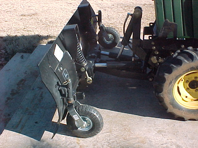

About a year ago I posted a thread on guide wheels for a front blade/snow blade
<font color="red">"Guide Wheels" replace Skid Shoes on Front Blade</font>
Here's a picture from last year with wheels mounted on the blade:
These small solid tires are just not sturdy enough for the weight of the blade. Dry runs on the pavement to just check the system out was tearing the tires up pretty bad. Last weekend I remounted the brackets on the blade to accomodate larger tires. Here's the result:
I hope these tires will hold up better. No snow yet, to try 'em out.

OkieG just a side note but you can get most air filled tires foam filled. It will prevent future flats and support weight easier. The ones we had filled on our RFM were about 10 bucks apiece. They track better over uneven ground now as well.
So how do the wheels work on the blade? yes, no, maybe? /forums/images/graemlins/grin.gif

I like the looks of that second set of wheels.
I use my rear blade going in both directions, so I mounted my wheels further from the blade to allow them to swivel and in case I don't lift the blade when I switch directions.
Your setup looks like it would work very well and with a front blade you probably don't need the tires to spin, unless you backdrag...

Looks like your first set didnt have enough caster to them. In other words they wont correct themselves properly and quickly enough. The second set must have a greater distance from the blade otherwise they will jam. Or so it appears. They look like they have enough caster or "angle to do the trick though /forums/images/graemlins/wink.gif
