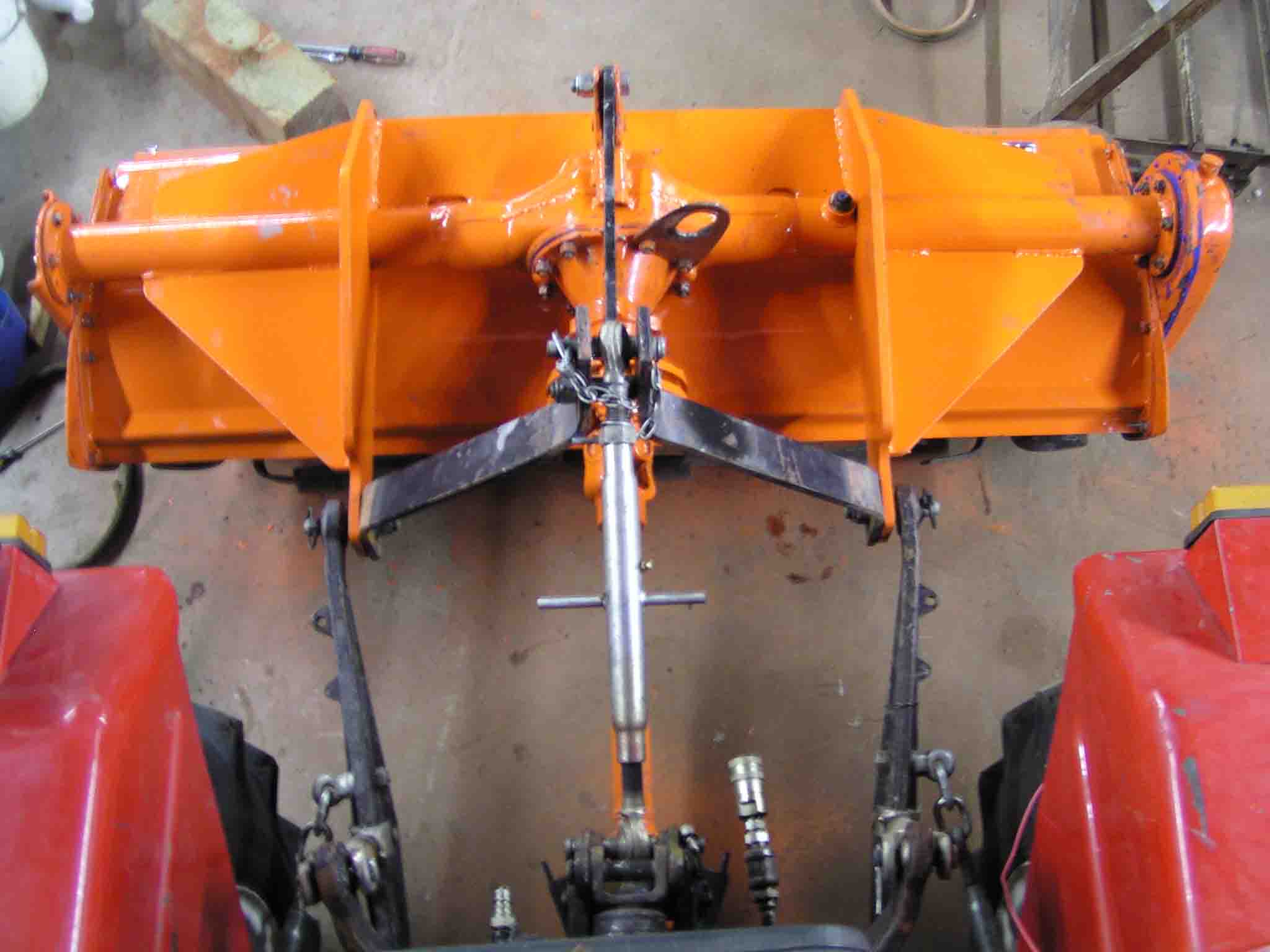

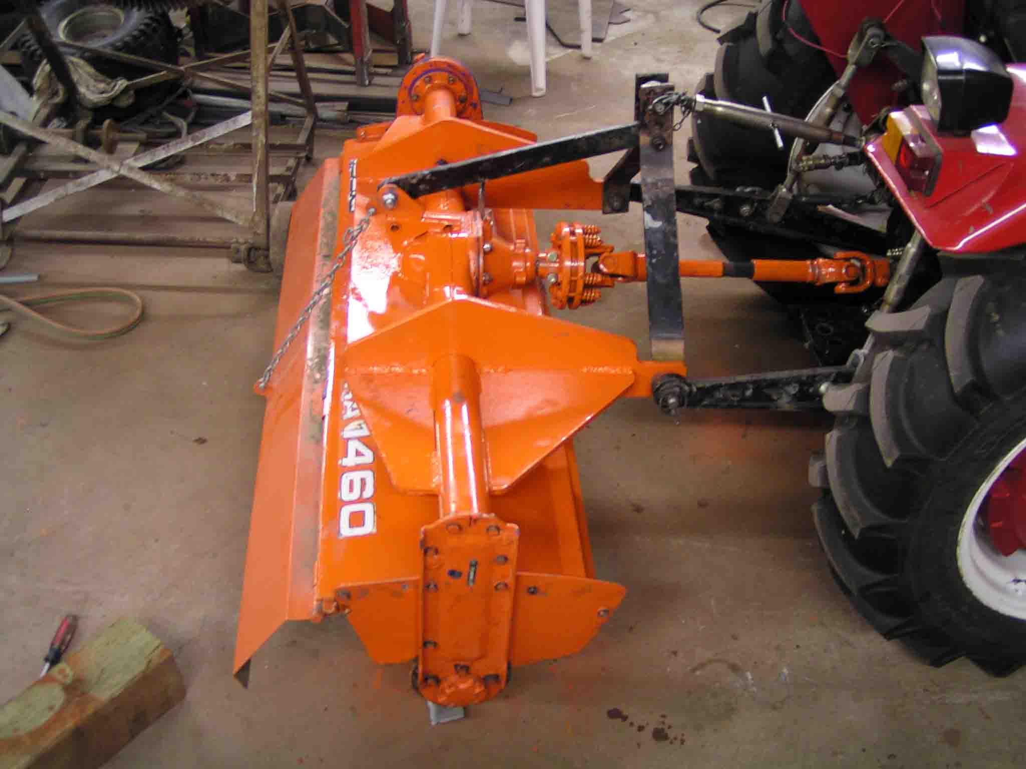

I don't know what a gx 120 tiller is? Is it a grey market tiller? I have grey market 5' and I have a JM354 tractor. I wound up having to seriously modify the mounts both upper and lower. I extended the pins to 15-1/2" from tiller housing center to pin centers to get enough room for clutch and proper drive shaft angle. A lot of compact tractor tillers mounts are too close. I used some serious 1/2" plate and made substantal mounts. If you don't, that Tractor can tear up weak 3pt mounts in a heart beat when a unseen object is hit with the tiller. Been there. Agri-Supply was the best price on PTO clutches, just make sure you know drive shaft makes styles & sizee. bjr
   / GX 120 tiller hook-up #4
Picture One
Finally got picture size down for posting, so you can see what I did. bjr

Picture Two
