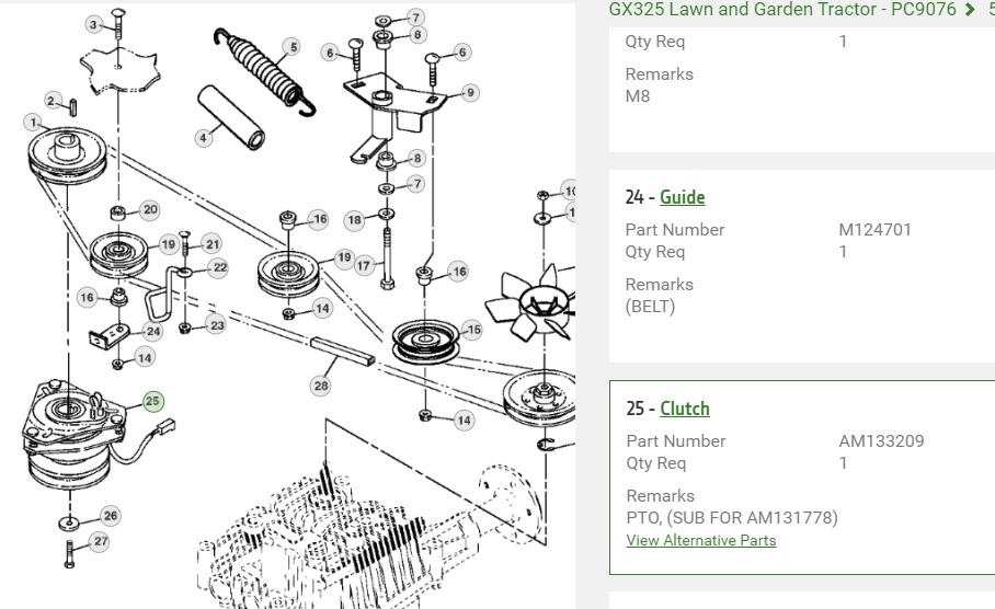

Anybody know the part # or have a photo/drawing that shows the PTO clutch anti-rotation pin/bracket/brace for a GX325?

Schematic of the clutch, and part #
Remove the bolt (self locking screw key #27), drop the clutch, and inspect it.
Metric sockets needed, likely a 13mm, maybe 14mm

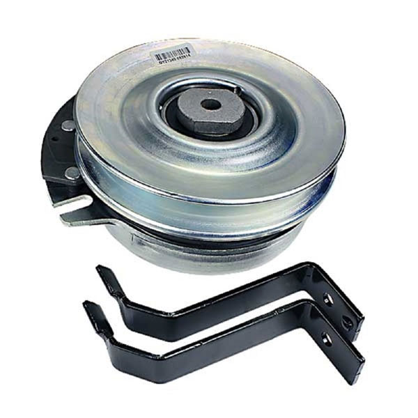

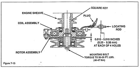

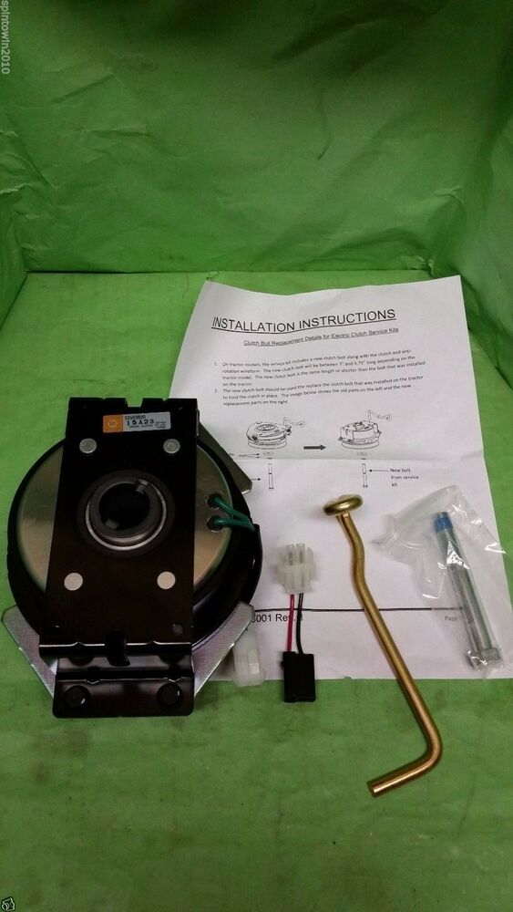

In my quest to determine the identity of this part I have come across several different retention methods.
Here are some PTO clutches, from various lawn tractors, with their "Thingies" proudly exposed:
I have also seen another style that is a long, shouldered stud, secured to one of slots in the housing with a nut.
It extends up a few inches and goes into a hole in the underside of the frame. Eh, sounds a bit racy, no?
Whoa. How'd that get in there?
Part number? Picture? Bueller? Anyone?
Again, thanks for taking the time to read & respond!
