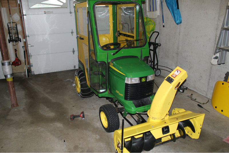

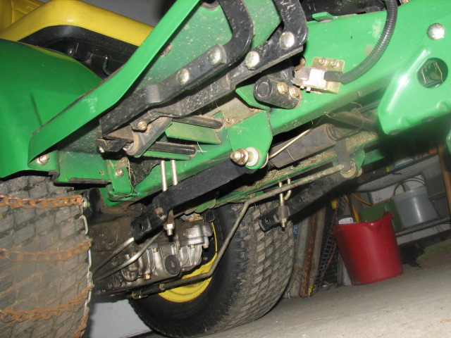

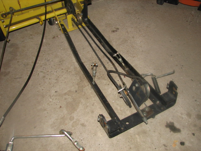

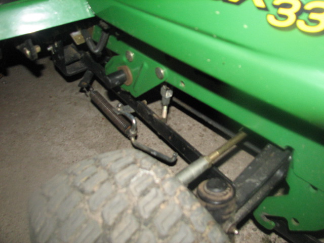

That just made my day, I was moving a few stones with the small trailer yesterday and going over a few hills the front end of the snowthrower was scraping the grass and I was saying a few more inches would have cleared it. I adjusted the deck to zero and that allowed me to tighten up the yolks to where they were when I got it and in turn raised the front to 6 or 7 inches, yahoo!! Thanks Thanks and Thanks again! :cool2:

You're very welcome, always glad to help. "GreenRules" told me about zeroing the deck, 2 years ago, when I was having the same problems as you. Now lets just hope we get some snow so you can try it out. Happy Holidays
