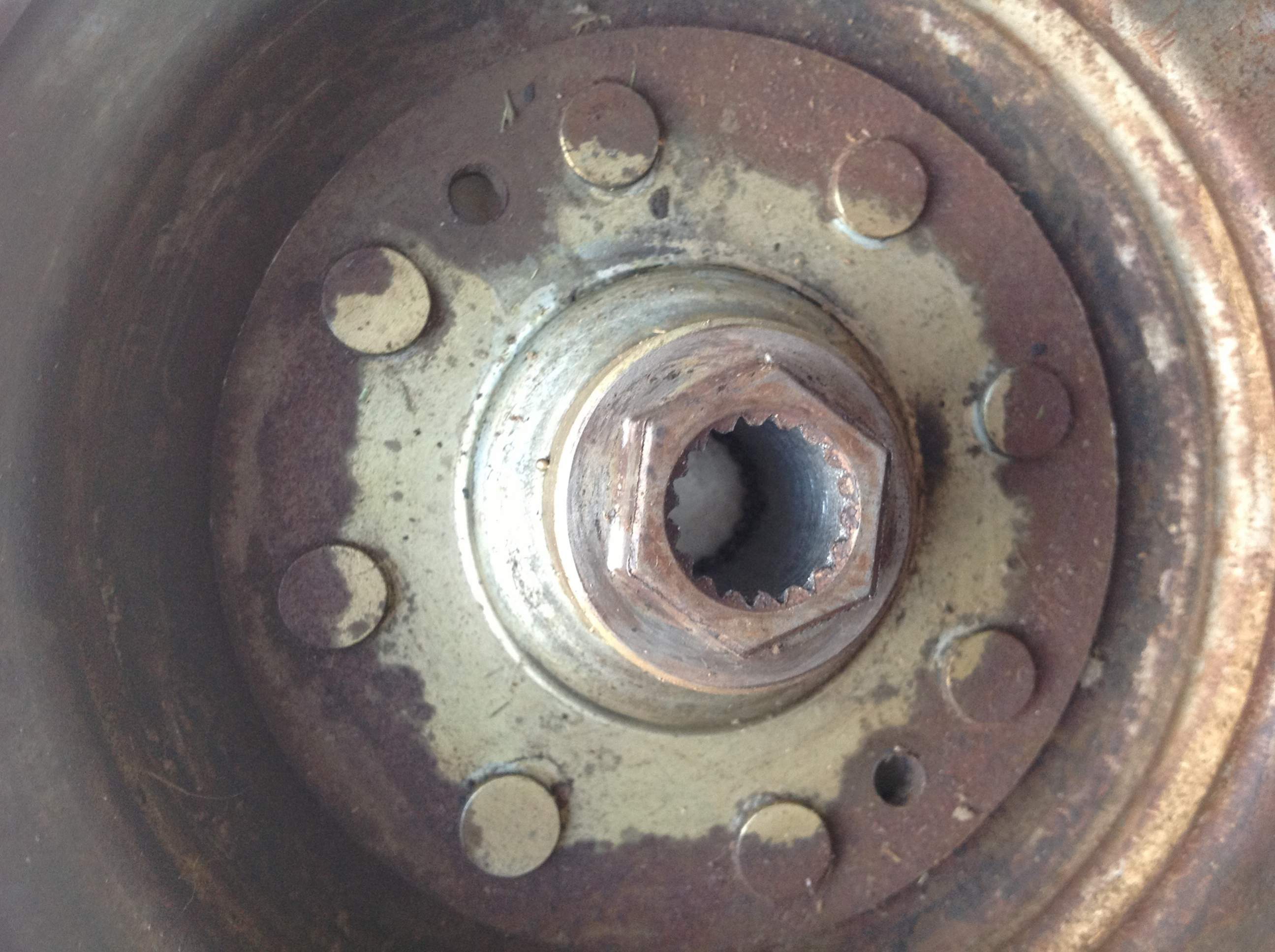

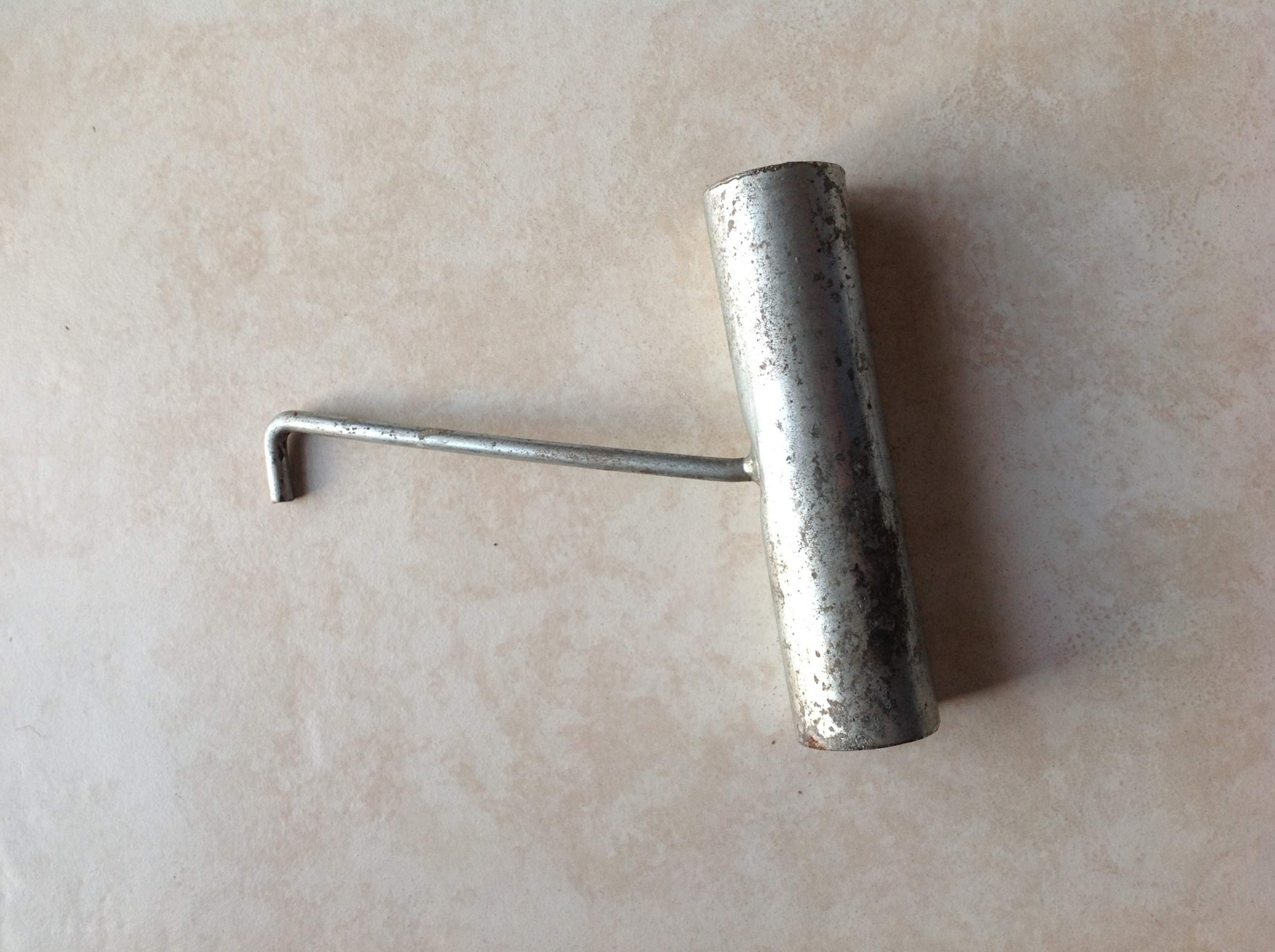

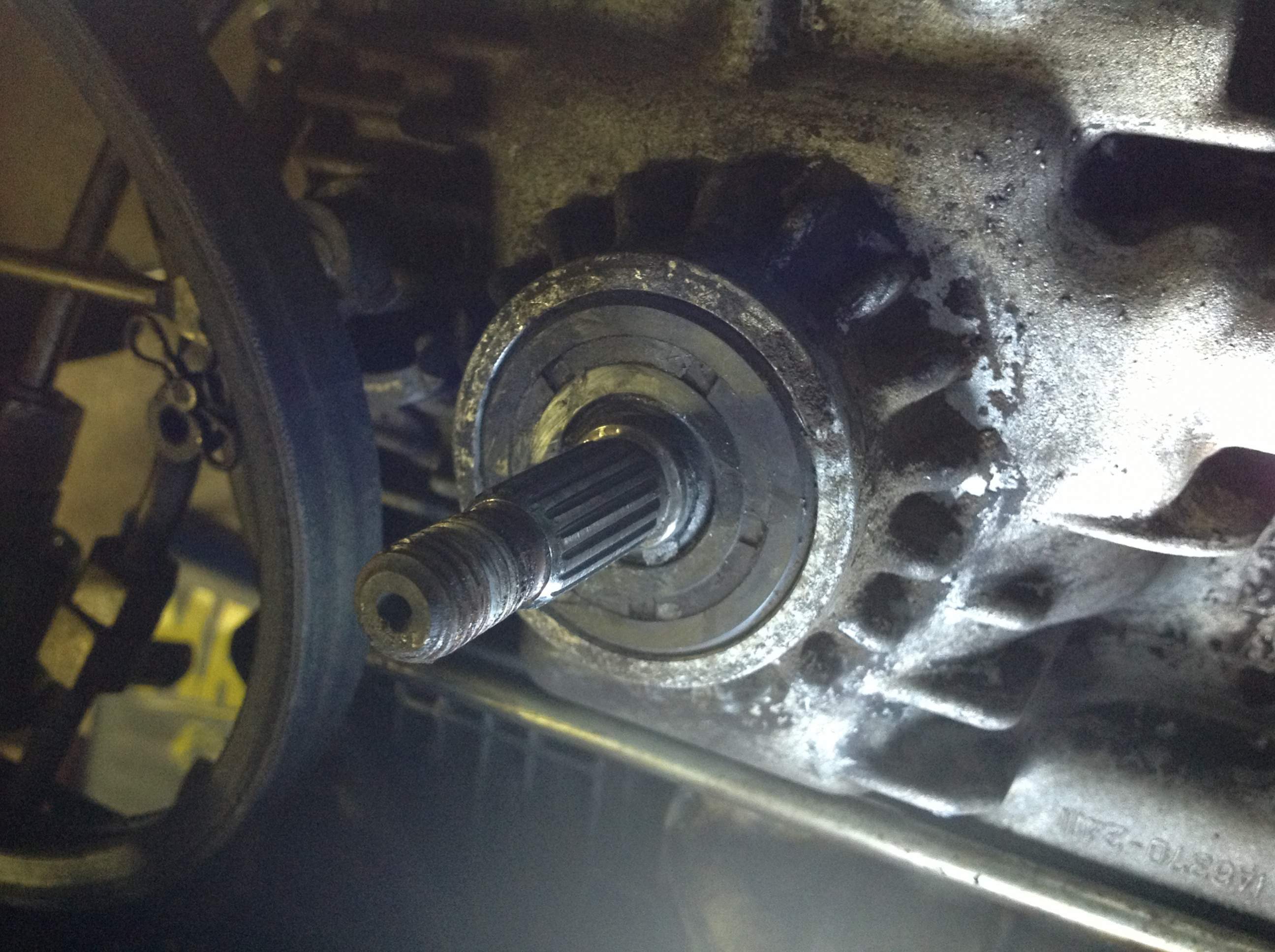

Finally had some time to work on the tractor today. I removed the tension spring using a spring puller that came with the trampoline I bought for my kids years ago (used to install all the springs used on the trampoline). It really made removing the spring simple. I noticed the drive pulley on the transmission was canted so I looked closer and noticed that the grooves inside the pulley that fit on the spline of the transmission were stripped. That was my problem. The material in the pulley is softer than the spline so that it strips rather than the spline. The spline is not replaceable so if was stripped, I would have to weld the pulley to the spline or buy a new transmission ($2600 according to my dealer). I will visit the dealer tomorrow to pick up a new drive pulley. With the tension released after removing the tension spring, I thought I would check the sheaves and idler pulley to ensure they are in good condition. I checked them by spinning them. If they spin freely and with noise, the bearings inside are no longer lubricated and it's just a matter of time before it seizes up & you should replace it. If they don't spin at all, the bearings are shot and the part needs to be replaced. If they spin but not completely freely, that's a good sign showing there is a little resistance from the bearing grease. The front sheave on mine spun freely with a little noise...I will be replacing that too.

The spring puller from my kids' trampoline- it made it really easy to remove the tension spring.

The drive pulley off the transmission- notice how smooth it is inside. The spline on the transmission stripped it. image.jpg

Picture of the spline that mates the transmission and the drive pulley. image.jpg
