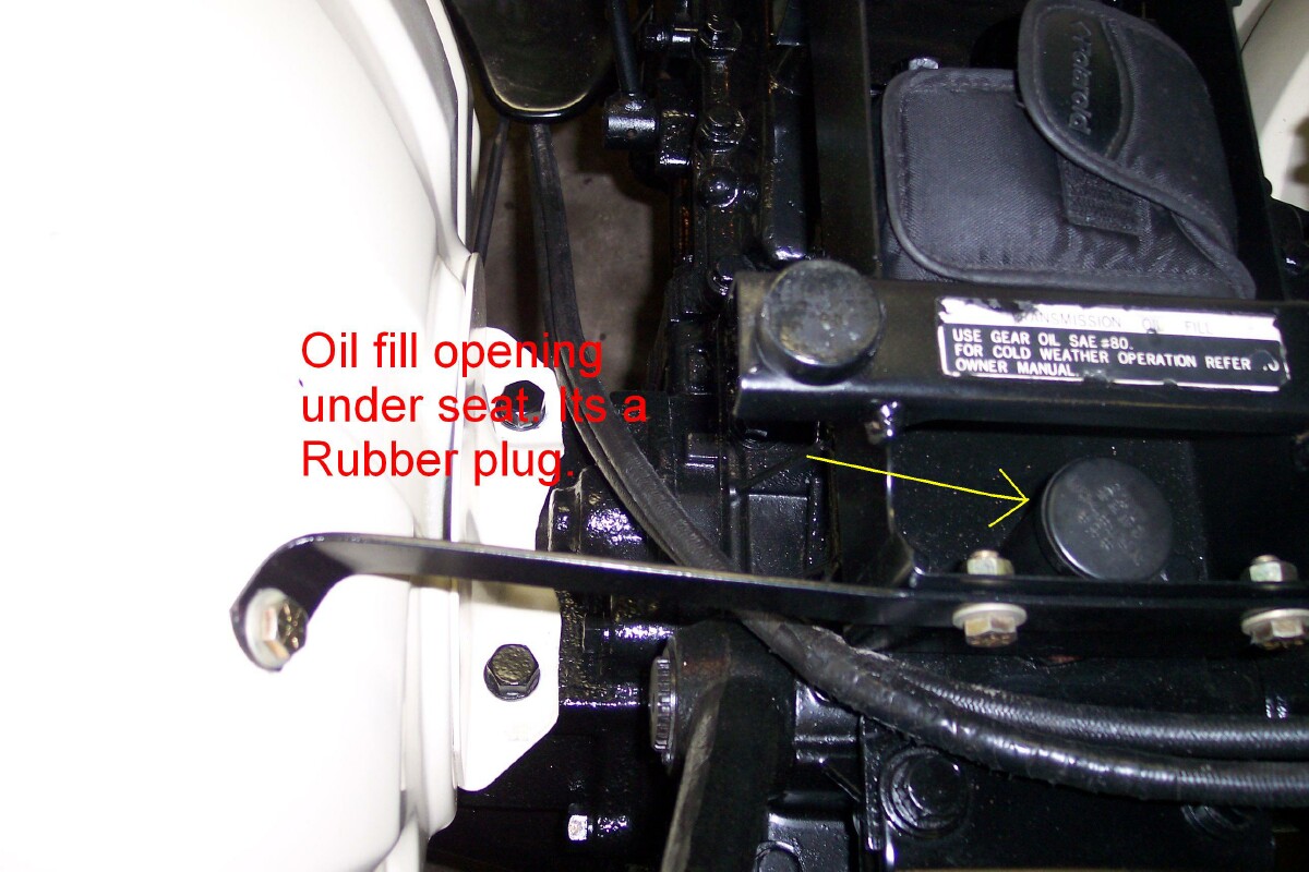

Need advice on how to service and refill hydraulics in my tractor. I dont see a fill tube anywhere

The refill spot is under the seat which is visable with seat up. There is a rubber plug in the base that seat rests on that you need to pull off then you can add or refill .the dipstick to check level is just in front of seat base ,real small ,but is a small rubber topped plug with stick attached.
   / H1502 hydraulic oil service #3
Here is a picture of fill plug on a TX1300F.

There is also a screen in the hydraulic line to filter debris upfront on the right (as you are sitting on the tractor) near the radiator, it looks like a long canister. The screen comes out and can be cleaned. There is also a spin on type of filter under the seat. I used to have a hard time finding the spin on filter, however since I got one I have seen about 6 on ebay. And as much as I use this machine, the spin on I wont need to change for sometime. I think in four years I only did 30 hours since I mainly use it to pull logs and plow snow.
