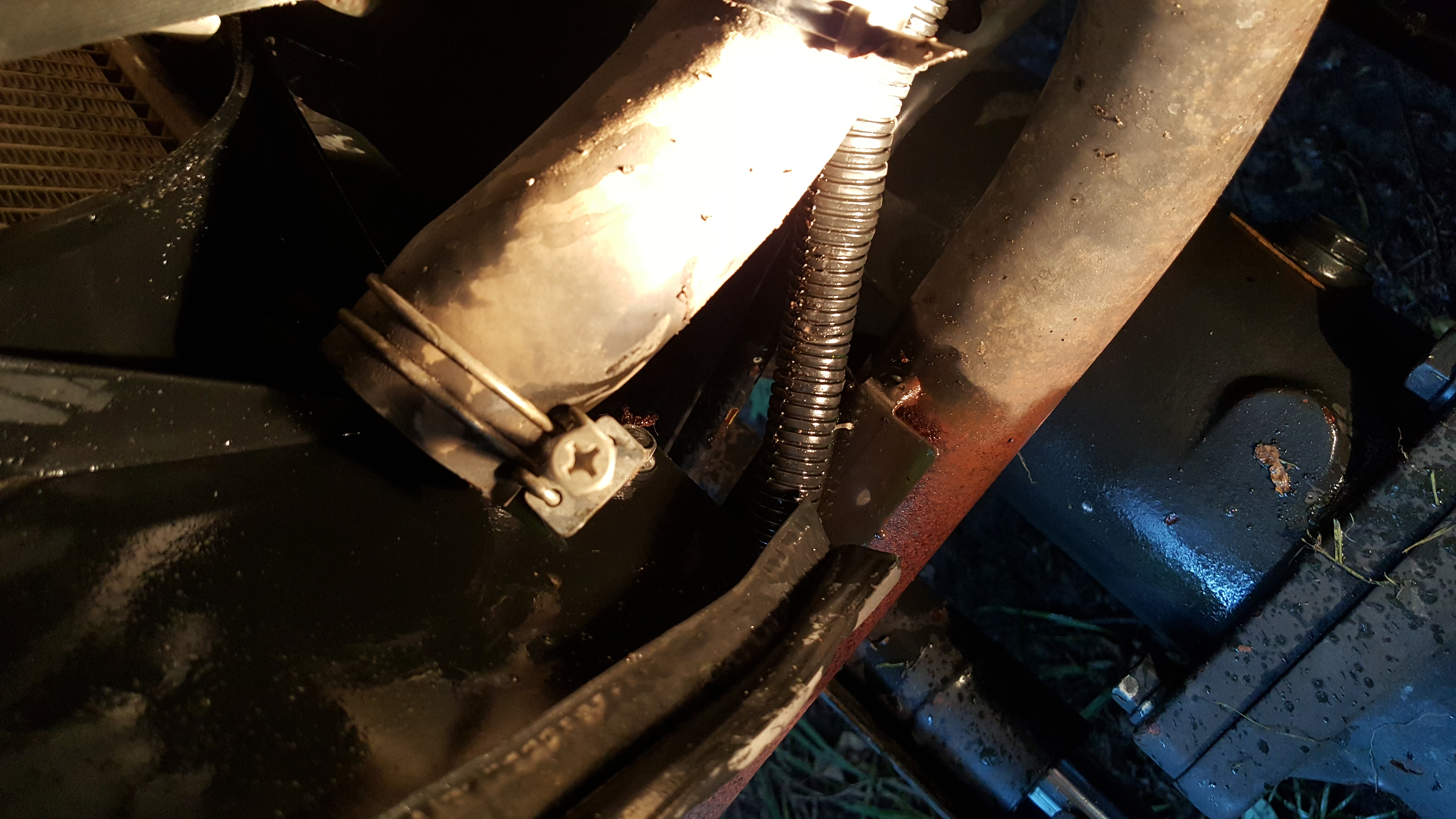

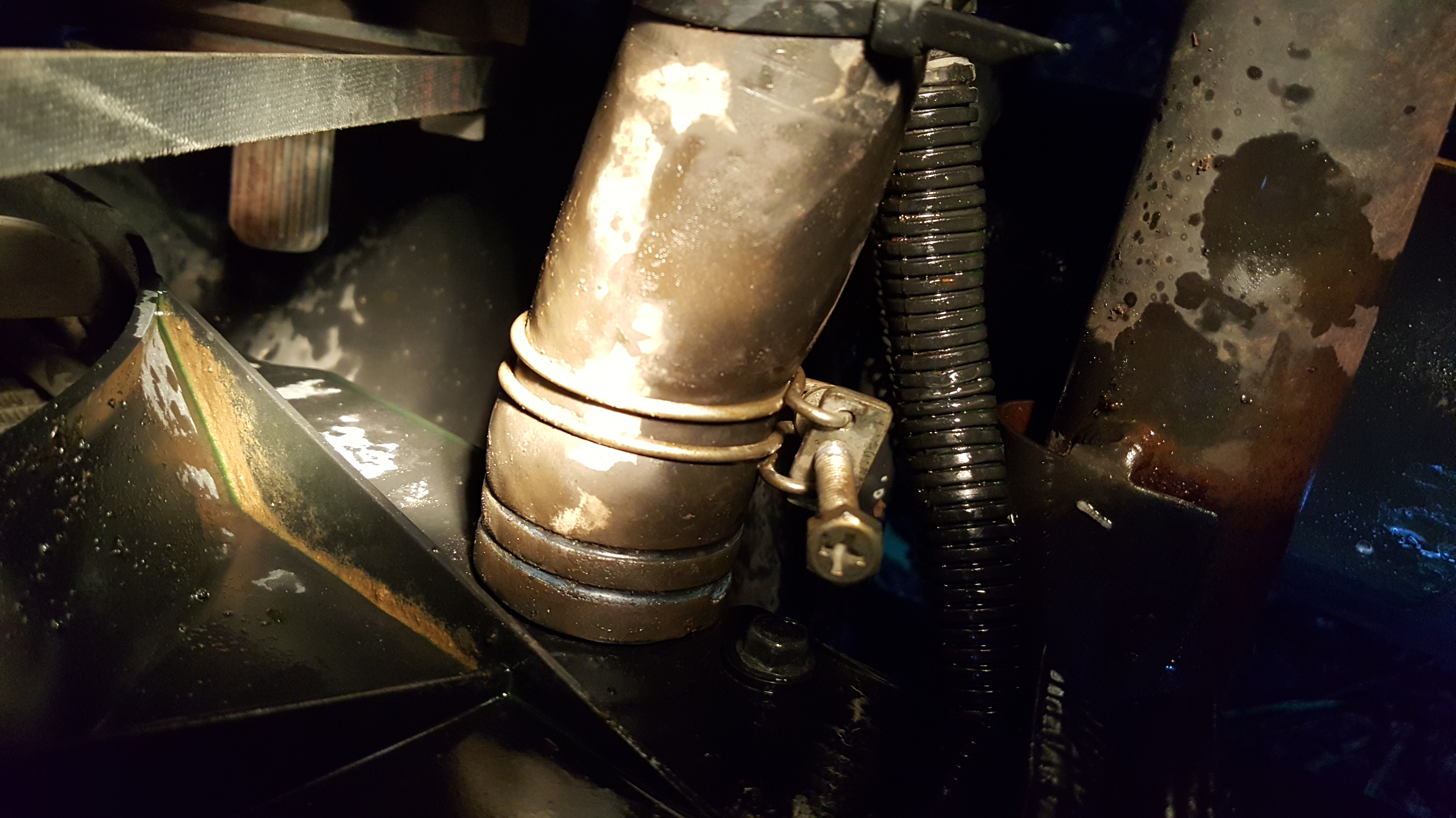

Was out moving some old rotten wood with my loader - heard a noise that sounded like liquid looked on the left side of my tractor and saw anti-freeze coming out of the tractor.
Turned off the tractor and a big stick had shoved off the lower anti-freeze hose - put it back on and refilled the radiator - everything seems OK, will check again tomorrow for any leaks.

I'll take a look tonight at the shielding. Last night in the dark it looked like the only place a stick could go is where it did. Radiator is 385$ - very happy with just adding a gallon of anti-freeze:thumbsup:

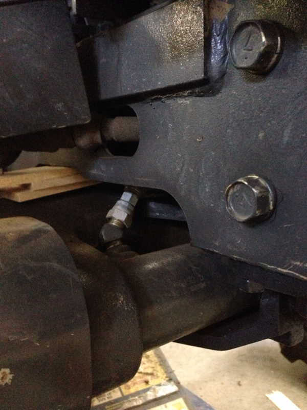

I knocked the power steering hose off my tractor with a stick. The hose was long enough to cut off and crimp a new end on. That only cost me $7. It was pretty challenging to get the hose back on though without a lot of dissembling.
This is where I love in field reusable fittings. Twice the price but if it saves you a couple hours of work and some busted knuckles I say its worth it.
   / Had a big (small) scare tonight using my tractor #10
Here's the fitting I broke. Not much room to play with. The other end of the hose was the difficult one to get off.
