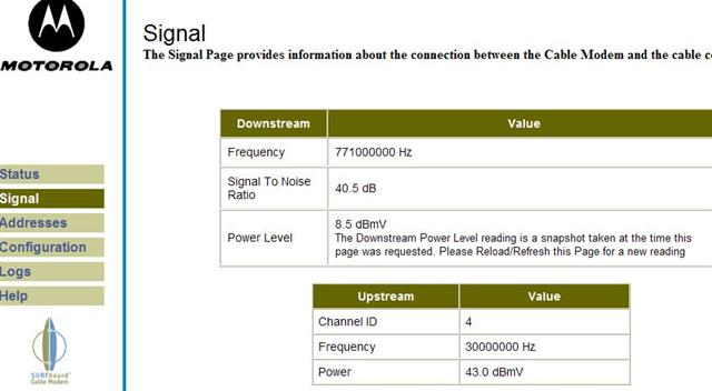

Once you get it fixed you can look at the system performance by typing the following address into your browser which is "192.168.100.1" it will bring up the cable modem status page. Take alook at the signal page and you can see what's going on with the power level on the upstream and down stream when the network goes down vs when it is up.
Here is a screen shot of mine
