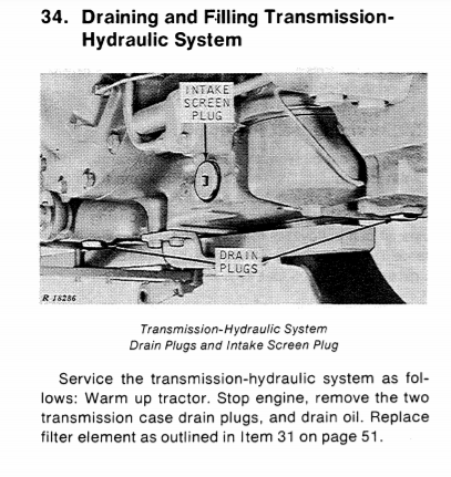

Since you have a newly purchased used tractor 1st/simplest thing to do is change hyd filter(JD part # AR75603) & check/clean hyd oil suction screen. One needs to drain hyd oil or block hyd filler hole with a plastic bag in order to create a vacuum to slow oil from draining. I suggest to perform my suggested maintenance then report back.

Thanks for your reply I changed oil and filter,cleaned the screen. I also opened the flush valve,, on the front hydraulic pump,with no results still got the same problem. Coming to you from Hallettsville,Texas.

I changed the oil and filter and cleaned the oil screan and flushed the front hydraulic pump. I also installed a control valve for the front end loader,closed system.

I changed the oil and filter and cleaned screen and flushed the front pump, still no change.Added a close system control up front for front endloader.

Idid the maintenance on the tractor when I had a new engine installed, cleaned oil screen and changed the hydraulic oil and filter.
