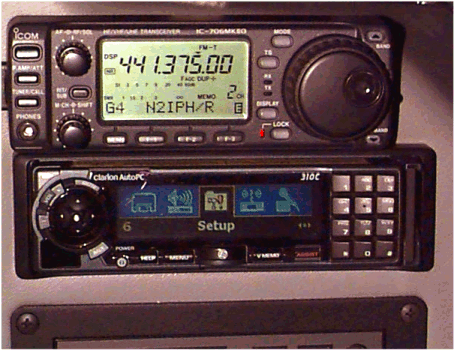

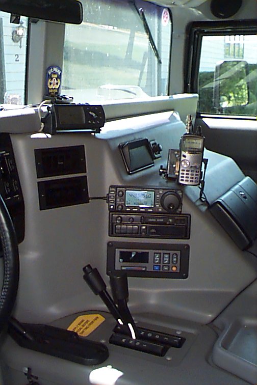

Wondering if anyone has a thread here (searched and didn't find one) about installing amateur gear in newer pickup trucks. My last was in a 05 F-150 and I did not have any issues but it was only a dual band V/UHF rig and I ran less than 20 watts most of the time as the repeaters are close. In my diesel powered Hummer H1 I had a IC-706MkIIg with a variety of antennas (whip, hustler center-loaded verticals, top loaded sticks, etc.) and a remote mounted AT-11 auto-tuner from LG Electronics and that setup worked well.
the IC-706 in my Hummer
But now my rig is the '12 F-350 diesel and the onboard computing power exceeds that used to get us to the Moon by a factor of 100!
I would like to put that same IC-706 in the F-350 and be able to work some mobile HF as well as VHF and UHF but I have concerns about stray RF and what it might do to the onboard computers and also warranty. Is there a paper from Ford on installing radios in their current vehicles? I believe most manufacturers used to put these out BC (Before Cellphones). :)
So if anyone has tips on antenna mounting and routing power to the under the back seat from the battery (and which one? does it matter?), I'd like to hear from you.
