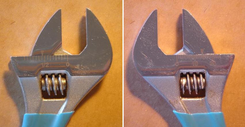

Since Kubota is made in Japan and assembled in the USA, I had always assumed it was 100% metric. Not true. While most of the bolts I've encountered servicing the tractor have been metric, some are in inches. For example I recently had to replace a hydraulic hose, it was 11/16". To avoid rounding off the bolt with an incorrectly sized metric socket or wrench I now check an unfamiliar bolt with my handy adjustable wrench. It's an 8" wrench made by Channel-Lock calibrated in 1/16 increments on one side and millimeters on the other. It's surprisingly accurate. If it doesn't align dead-on with a millimeter marking I turn the wrench over and It's usually dead-on in inches.

Interesting wrench, but since it's a cresent style I guess the measurements are there to tell you what size you have. Otherwise I just adjust it until it's tight. a 17mm is close to an 11/16" wrench. But not as close as a 13 and 1/2" or a 19mm and 3/4" are. Next match if I recall is a 22mm and a 7/8". Forgot the 8mm and the 5/16" match. I don't know any bigger or smaller. 14mm and 9/16 sometimes work depending on the bolt/wrench age and wear.
