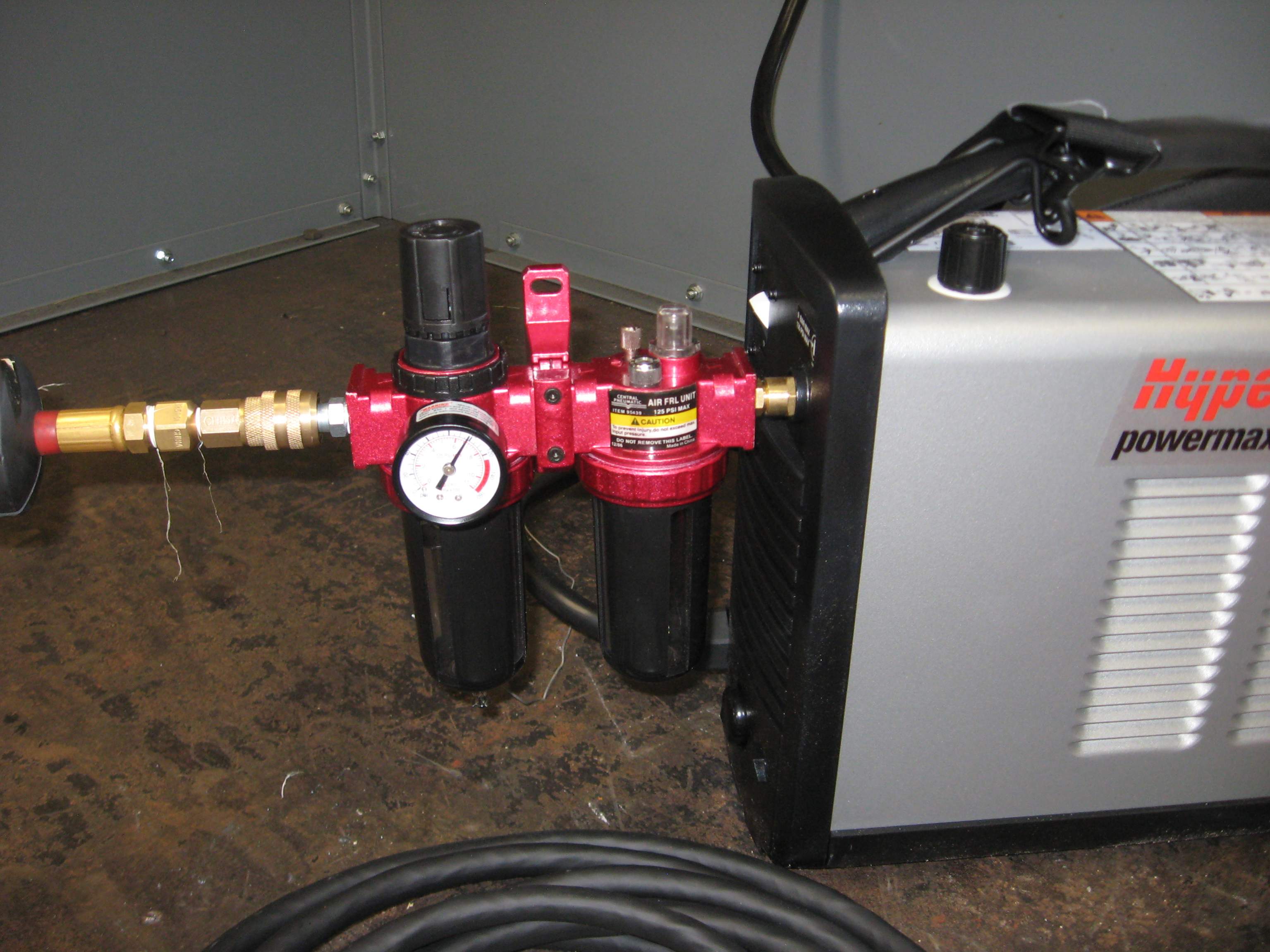

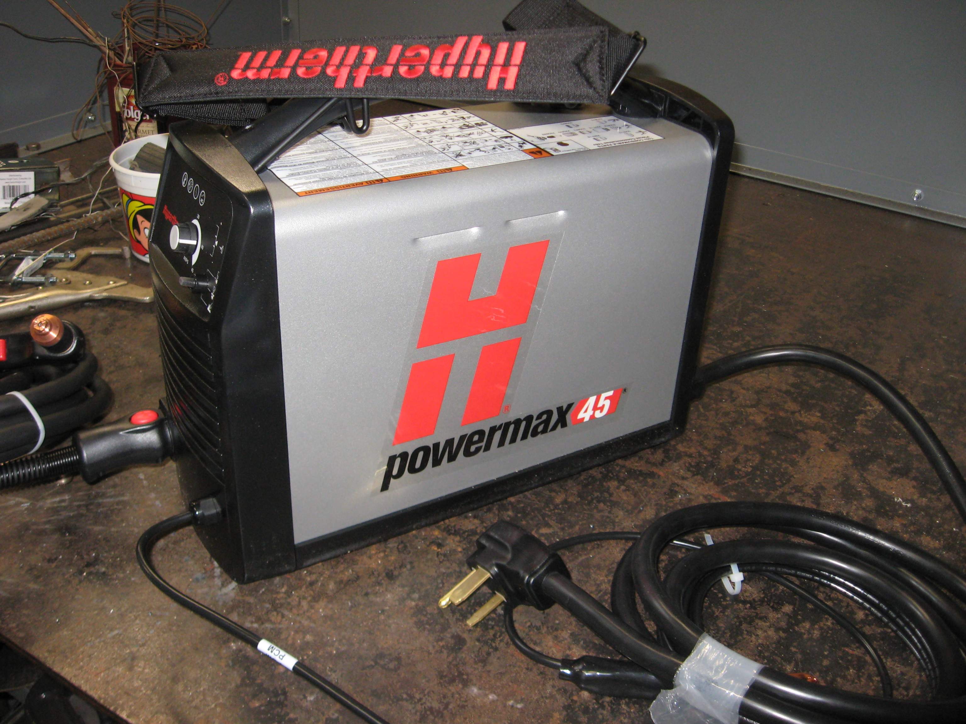

Just picked this up for an early 52nd birthday present. I am anxious to cut something up, but still need to get my air filtration system worked out.

The filter I use for my Lincoln 55 is a Motor Guard filter, and one of those desiccant filters from HF.

Happy birthday! I've been contemplating that very same model. I'm either buying the 30 or the 45. How about a little feed back after you've spent some time with it?
   / Happy (Early) Birthday to Me #8
Feed back don't buy the 30. Buy used 40 amp or more.. there ya have it..

I threw a cheapie HF water trap on it today and took it for a test run. Even though the trap included an air tool oiler, I obviously did not have any oil in it.

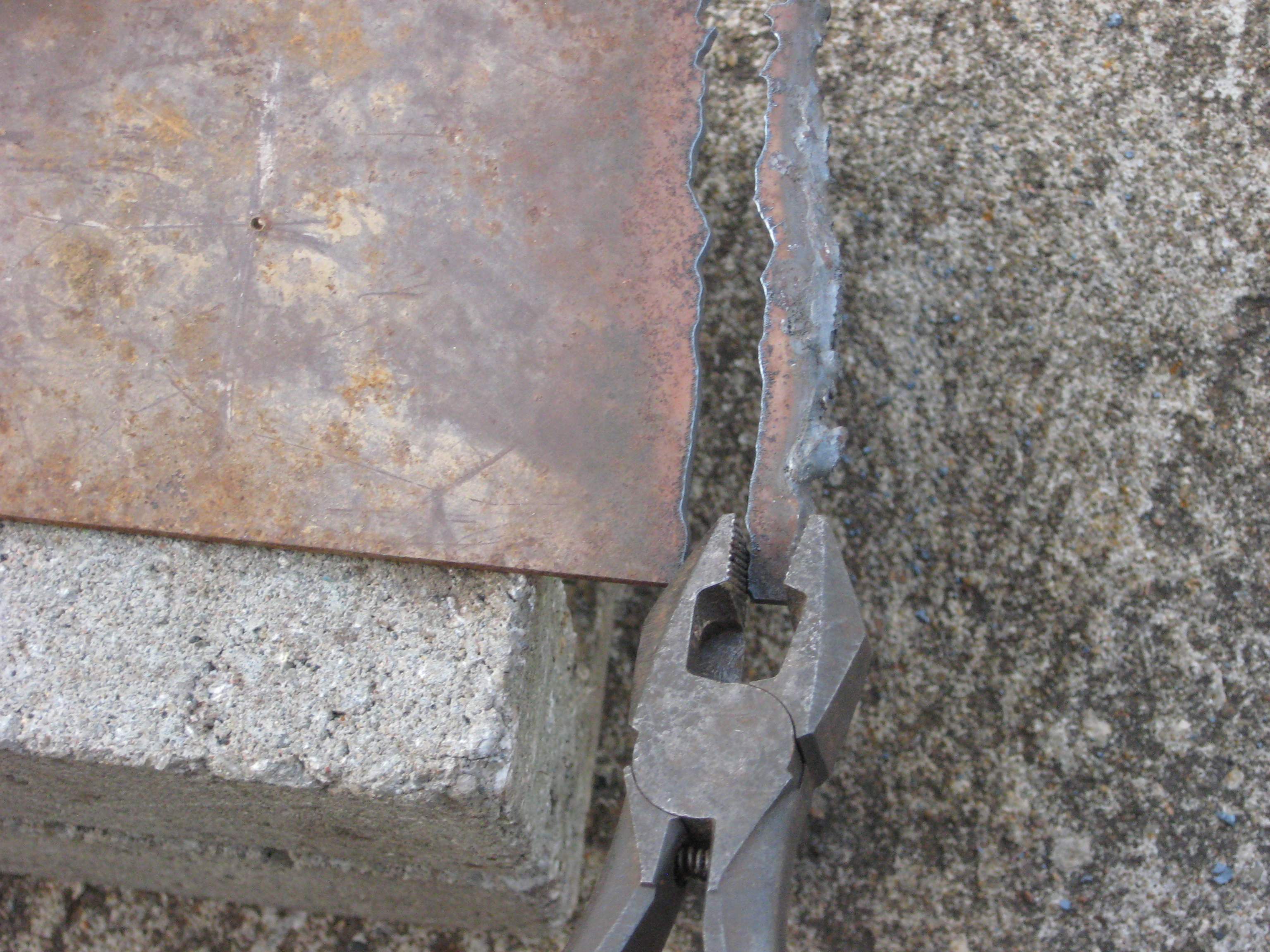

First cut was a piece of 3/32 inch flat plate. Obviously, I can't draw a straight line for nothing. Anyway, it cut it as fast as I could drag the torch across.

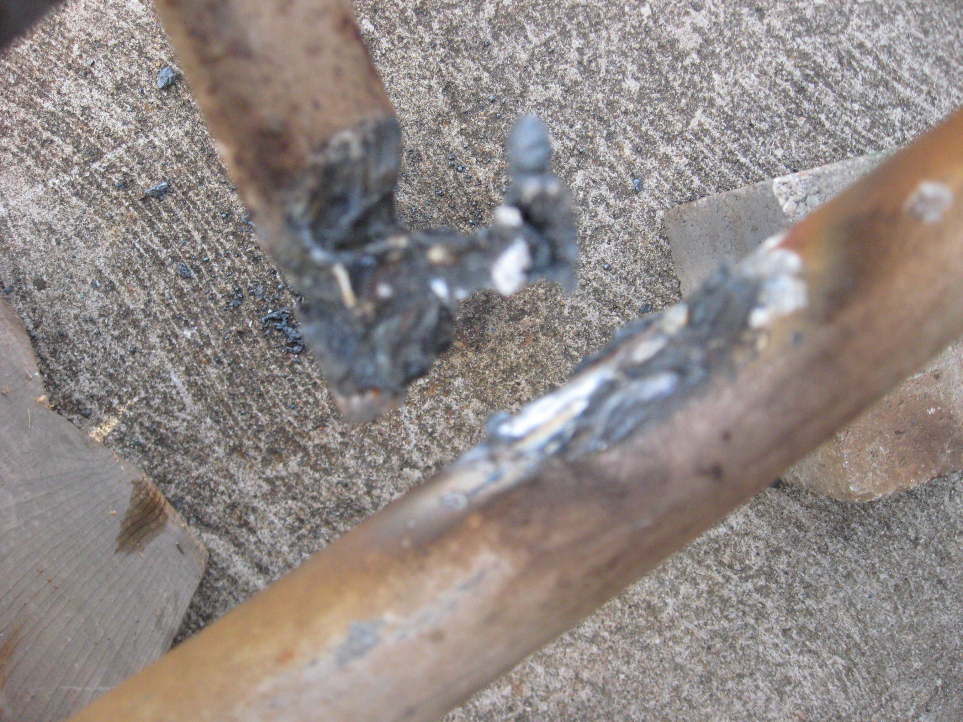

Next, I tried cutting up some scrap iron. Tried cutting through some old rusty, painted welds holding pipe and angle iron together. I used the gouging tip for this because it seemed like the right way to do it, but I'm not sure. It worked but was slow.

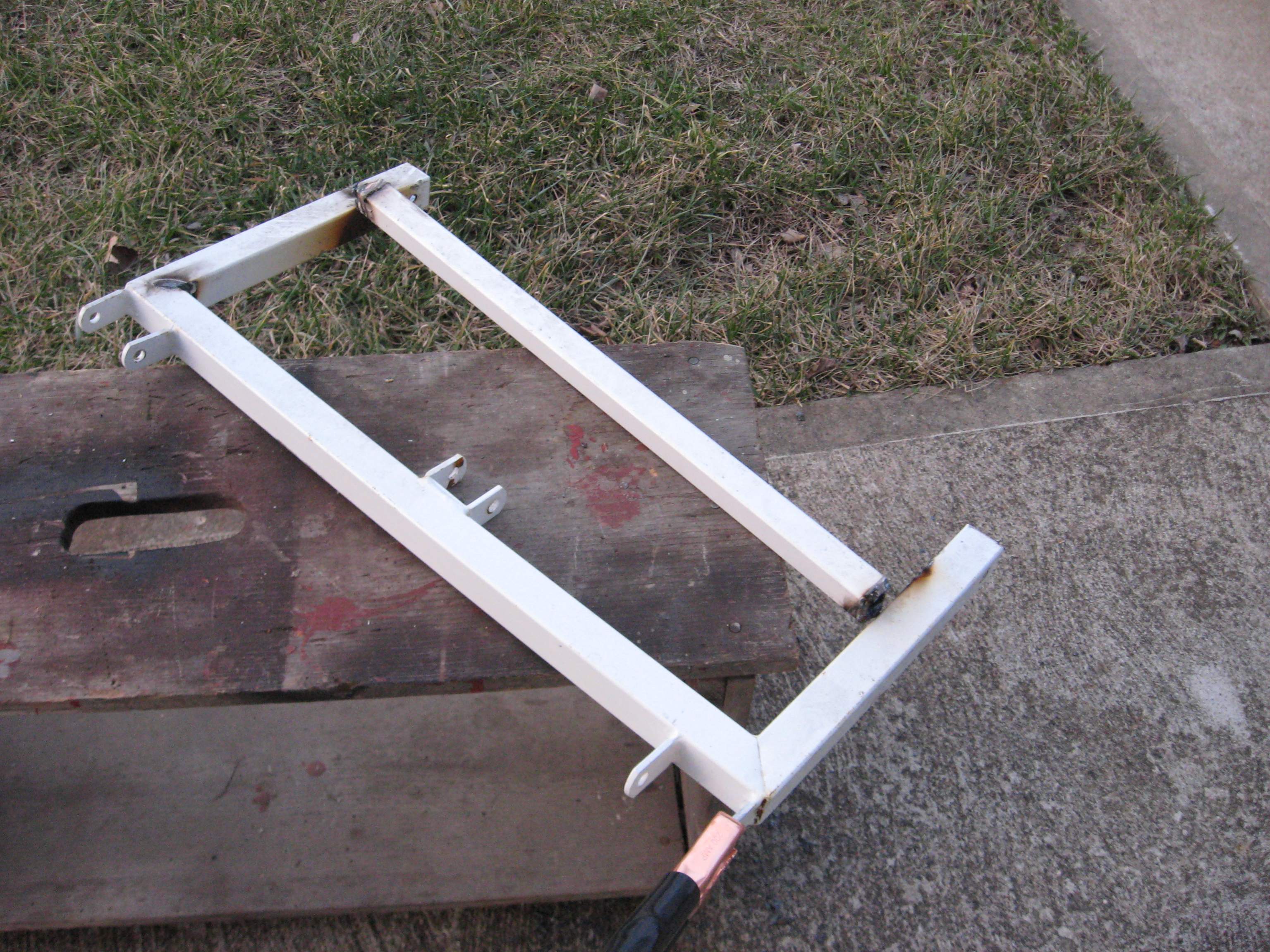

Last, I tried blowing out some welds from an old treadmill frame so I could disassemble it. Seemed to work well once it burned through the paint.

That's a very artistic looking cut...
