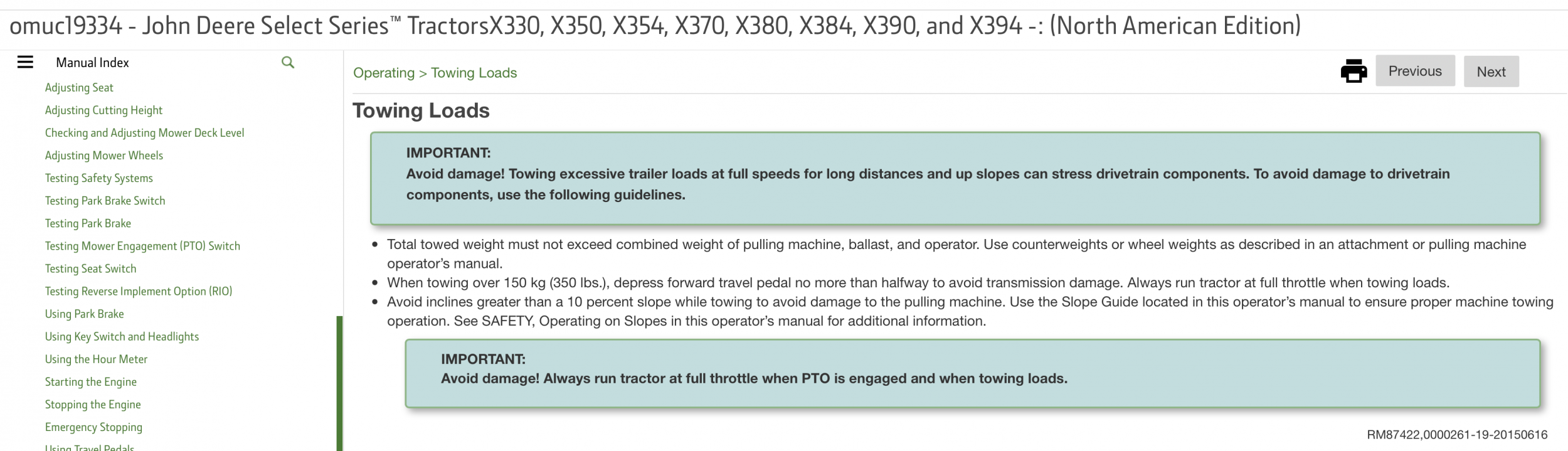

  • Would I damage the transmission or engine by pulling my boat very short distances? When I say short distances, I mean from the carport to the end of the driveway, less than 50 feet. I was told by the dealer it was rated to pull 500 pounds. My boat is nearly 2,000 pounds with a full fuel tank and gear. But I'm talking short distances on level ground, just to get it to the truck to hook the trailer up. It is very tight quarters getting the truck back there, which is why I'm wanting to use the X350.
Congrats on the new unit! You will likely enjoy it.
Regarding your towing question, here's the Operator's Manual:
The X350 is approx. 500 pounds. Add another 200 pounds for you and the mower deck. If it were my first real Deere, I would not tow anything over 700 pounds, especially during the warranty period. Why risk damaging or degrading the transmission performance on a tool that is not designed for towing heavy loads? Just my opinion... :)

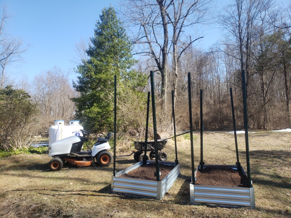

I have had this Gorilla cart 6 years. I use it almost every day. From Wood hauling to planting support and pull behind.
It's been filled with gravel from my tractor bucket and Dirt from landscaping. Still in great shape.
