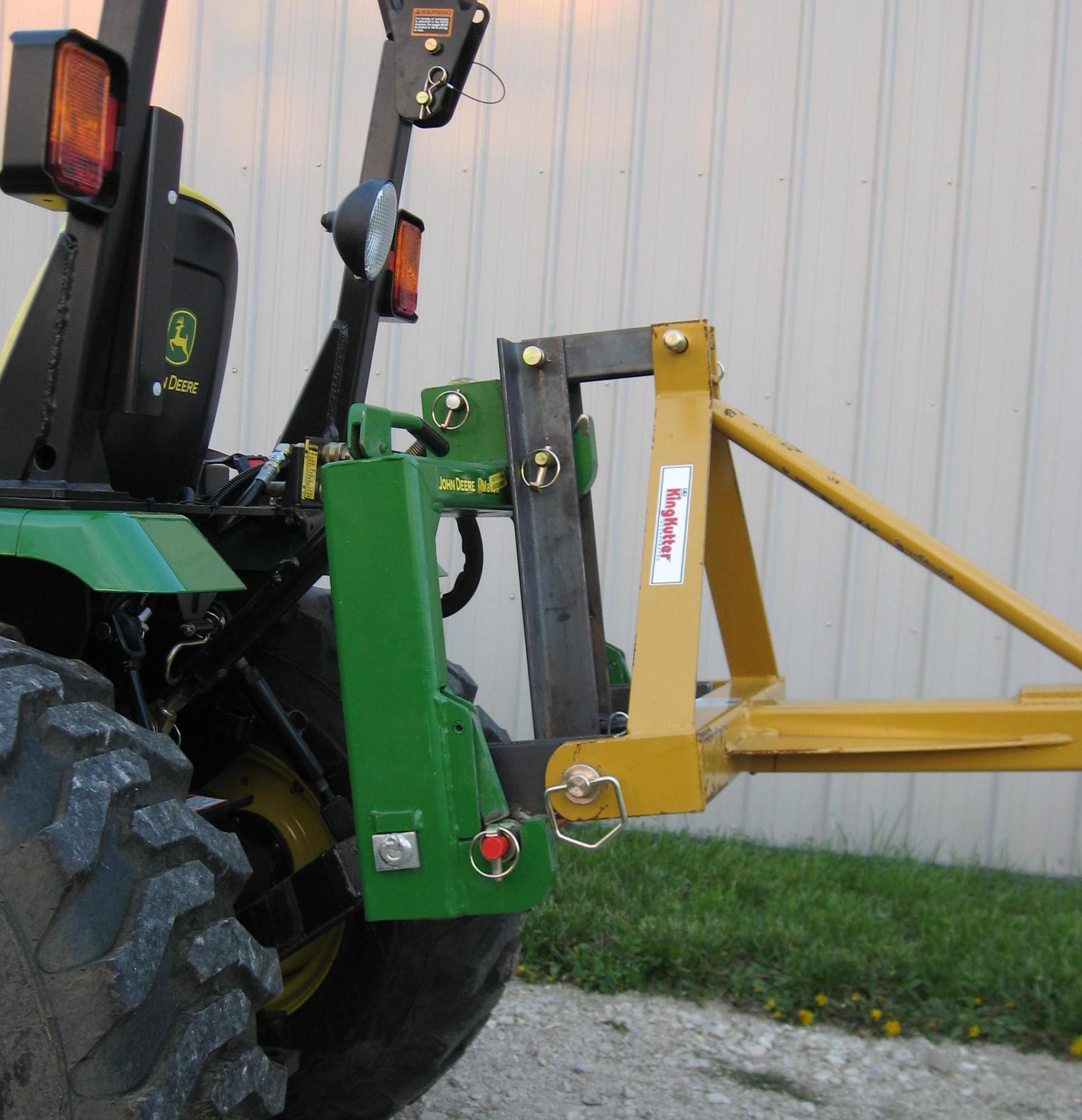

liledgy,
Same problem here with my iMatch. I built an adapter for it:
