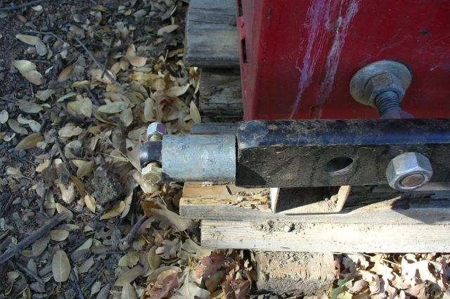

   / Harbor freight quick hitch
Dont they make slide on bushings for bottom hooks--rather than $30 per set attachment bushings,i would like to move bushings from one attachment to another
   / Harbor freight quick hitch #9
Depends on the age of your implements... if they are new enough to conform to standard measurements. Mine are old mis-match implements and the HF QH just became another implement to put on and take off (depending on what I was going to attach.)
I need to try it again... see how it goes!!
You one time modify your non conforming implements so your QH works on everything and you don't have to remove it....
   / Harbor freight quick hitch #10
I cheated.... 1 inch water pipe on my CAT 1 Pins.... This is on my 600lb ballast box.... This is affordable way to have bushings on every implement
And yes its a draw bar bolted to ballast box with 3/4 inch threaded rod...
