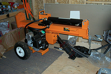

I have had a 30 ton 8 hp Briggs engine splitter for a couple of years. It is very heavily built and performs perfectly. I had considered building one, but for the difference I decided to take a chance and buy this one from Harbor Freight. I'm glad that I did. It will probably outlast me. I have no complaints at all. I paid $1,000 and shipping was free. I think that you can still get them for that price if you catch them on sale.
