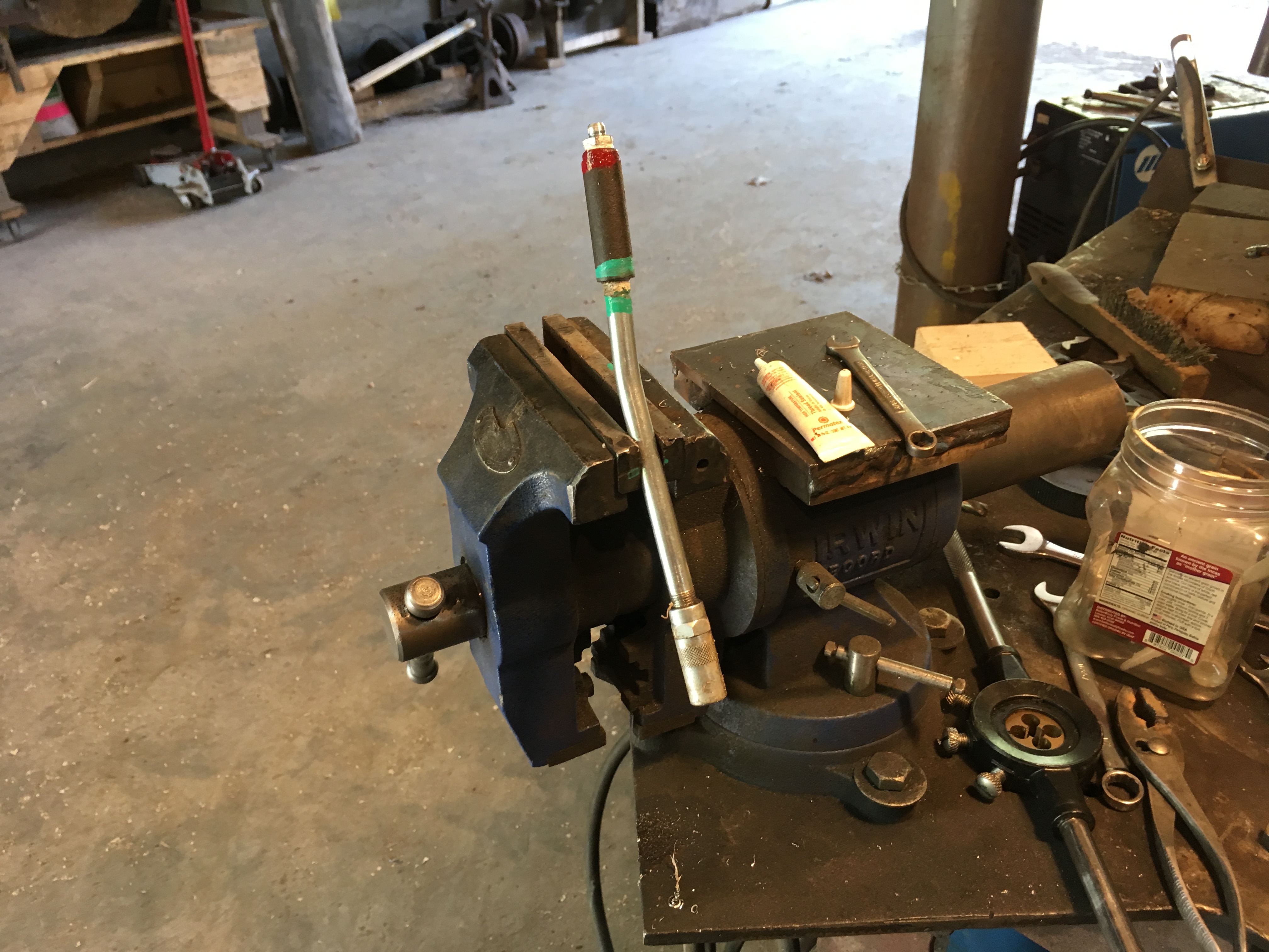

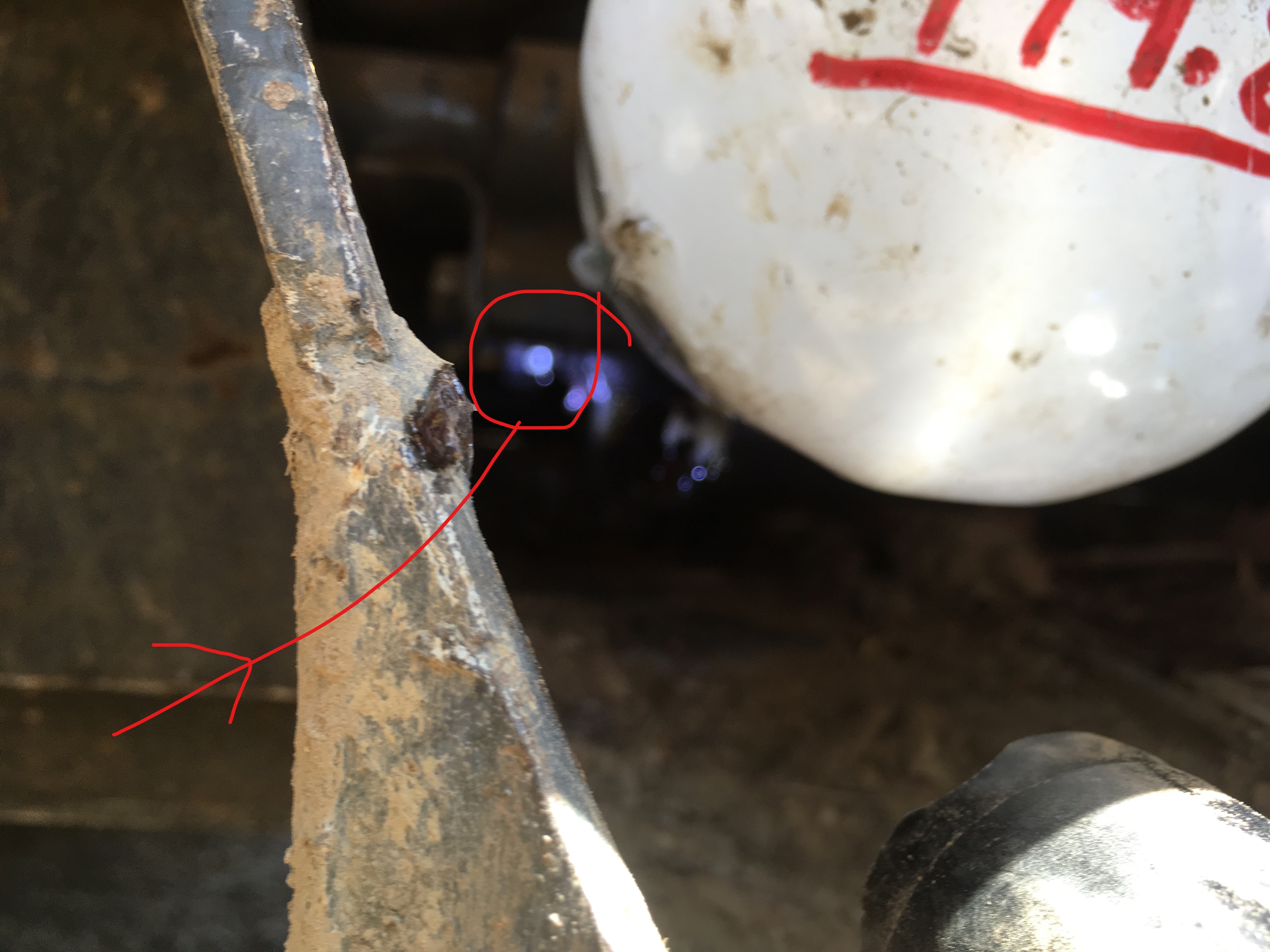

I'm getting tire of trying to grease this one fitting, it became very hard when I put my skid plate on so it's either cut a hole in the floor board, take the hard to put back on skid-plate and or wait for Lock&lube to come out with a 12" long coupling. Well I do not want to cut the floor board, I do not want to struggle with skid plate and I cant wait for some outfit to come out with a 12" grease coupling so I took matter in my own hands and spent 2 hrs trying to make an grease ext, that was harder then I thought, trying find something to screw into something, didn't have pipe thread taps so that made it even harder, for some reason grease fittings dont like regular threads. I did end up with something that works.

Replace the zerk with a small barb fitting or compression fitting. Run hose or tubing to an easier to reach place and add a zerk to the end. That’s basically how we do it on our automation equipment. Offen we run multiple grease points into a manifold so the operator s only need to grease one point on the machine.

On my finish mower, the zerk fittings are burried under the protective metal plates, so Land Pride attached rubber hoses to where the zerk would fit that are about a foot long, then the zerk fitting is attached to the end of the hose. One broke on me and it turns out that the flexible hose that comes with a grease gun is the exact same threads, so I replaced it with that. Instead of trying to get the grease gun to your zerk, why not extend the zerk fitting out farther with either a flexible hose or a solid tube?
That sounds like a novel idea, so re you talking about something like this>>>>>>>> https://www.amazon.com/Anderson-Met...NPT+Connector&qid=1559084366&s=gateway&sr=8-1
I failed to mention that the grease fitting is on my brake petal shaft, I forgot what size it is, but I'm sure it's the small zerk, are there barb fittings that fit the small zerk?

Well you could say that's my fault, the under side grease fittings were easy til I added a skid plate, you know how it is sometimes, when you cure one problem you end up creating another one.
Clever but on my brake pedal shaft I'm quite sure those threads are smaller then a grease gun hose, of coarse with pipe threads it adds more complication.
