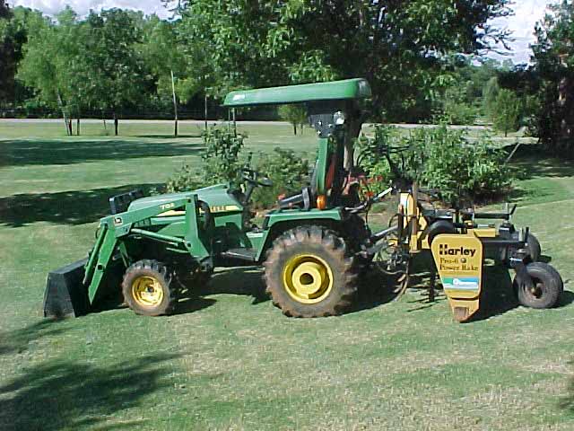

Some might say, even a small 24hp (19PTO) could handle a PRO model 6 footer. Although, it's certainly at, or about at the lower limit for hp.
I have grown suspicious of manufacturer's hp recommendations for their products. Use them a guideline or starting point, but don't use them as absolute. That approach offends the sensibilities of some, but I am unclear exactly where manufacturer's are coming from when they post their recommendations (that's just me talking). Optimum performance is somewhat in the eye of the beholder. My limited personal experience is that the Harley takes little PTO power. You may find a T6 is a better fit for a tractor the size of yours. A 29hp tractor should handle a T6 with ease.

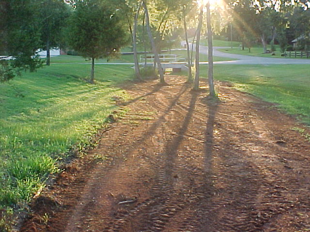

After first brush hogging down saplings, brush and weeds, several passes with the Harley did a good job of smoothing. Ready for seed.

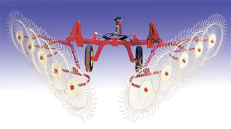

See this one but its not a power rake but its useful in U.S.A

i want to show our carted rake this one is a bigger picture
