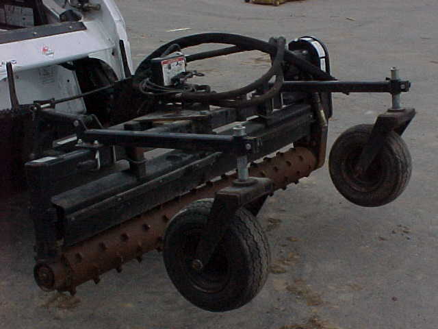

heres a couple pictures,They are incredible for how simple they look

Could someone be good enough to explain how that Harley Rake works? I just can't see it. Does is rotate opposite the direction of travel and kick rocks up out the front or something? Thanks.
   / Harley Rake? #6
It carries the rocks behind the spinning drum and throws the soil through the slit on the to of the rake to create a smooth area. This operation can be reversed to carrying the rocks in front of the drum also. Depends on what direction you are moving. If you angle the rake, it will windrow them. If the rock is too large to pop out of the ground, it will bounce over it. The one that worked at my home, was able to remove slightly larger than basketball sized rocks. Amazing machine, but I can see how they can take a beating if not used properly.

How far into the ground does the rotating drum go? Half the drum diameter? The full drum diameter? Other depth? Thanks.
   / Harley Rake? #8
It skims the surface going about 1 or 2 inches at a time. I believe that it can go down about 6 inches total. On mine, they went down about 3 inches and the amount of rocks that came up was astonishing. If they had gone any deeper, it might have lowered the field by a few inches if all the rocks were removed. They removed about 30 yards of rocks total.
