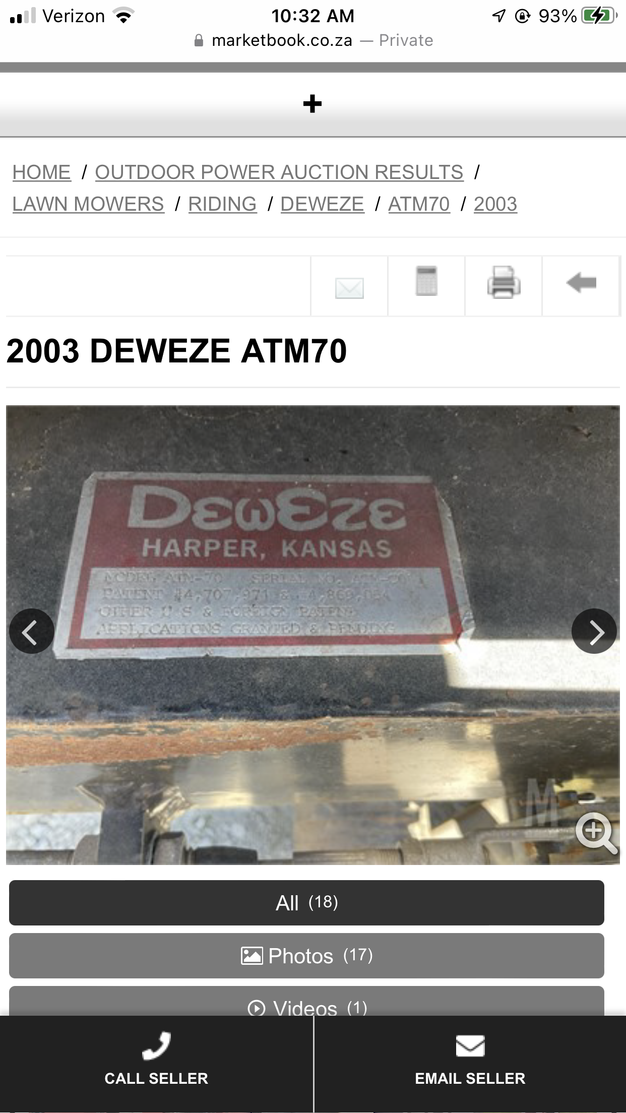

This picture from an auction site on a 2003 model appears to show it facing up on the frame above the steering linkage. Probably not on your though since I am sure you would have noticed it.
For what it's worth.....
Thanks! There are no labels, like the photo you included, on my machine. If there were, it's probably gone by now. I'm hopeful a serial number is stamped into the frame somewhere.
