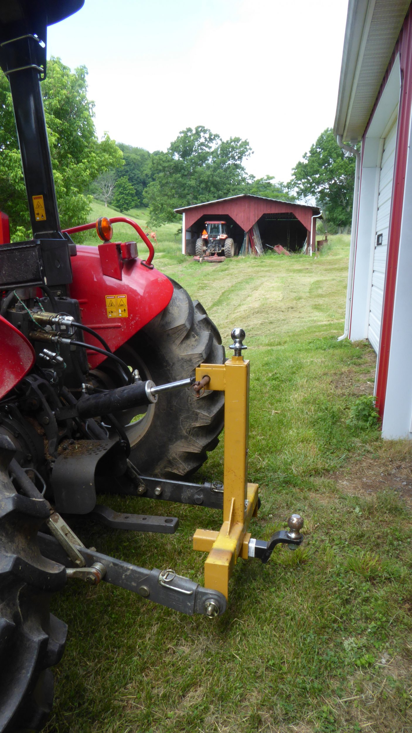

Backing up in the thoughts here -- your main reason to be interested in more 3pt lift ht is moving trailers around ? Hmmm.
I had an adapter made for the front of a smaller Kubota that takes a receiver hitch bolted to it straight out of Tractor Supply. The adapter is nothing but a heavy piece of steel bent into an angle iron around a foot long and 5 or 6 inches each surface. One surface bolts to the front of the tractor frame and the other surface (flat, top) has the receiver hitch bolted on. I have found that to be THE best trailer mover ever. So much better in front of me where I can see what I am doing and far more maneuverable than using the 3pt rear towing/pushing. I was able to do that such that the FEL is not interfering. If you can't do that with your GC configuration I would even consider attaching a receiver hitch to the FEL bucket and use that for trailer moving. I doubt that your tongue loading on the trailer comes close to the capacity of your loader.
If for whatever reason you still want to use the 3pt to do the trailer moving, there are a lot of the triangular trailer mover adapter for 3pt. sold. See yellow one below. And so long as you have something with a receiver hitch in the picture you can get a wide variety of lifts and drops in terms of the inserts into the receiver hitch.
Either front or rear I think you should be able to work out a very comfortable trailer mover without modifying your GC or doing anything strenuous.
I have no picture of what you are using now in your 3pt to do trailer relocation but maybe the cheapest thing is to get one of the receiver hitches like I show on the front of my little Kubota (cheap, readily available, TSC, etc.) and weld that to whatever you are using now ? Then you can use that wide variety of lifts and drops in terms of the inserts into the receiver hitch.
Whatever you end up doing let us know and post a picture if handy.

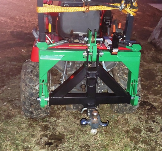

trailers moved a lot yes, but extra lift more for tiller when loading INTO trailer.
I've got the trailer adapter for 3pt mounted, move bunch (2 of my own, 2 of neighbors) of 2" ball stuff, one pintle pin (like lawnmower type) and one 2 5/16" ball 23ft overall length tilt trailer.
the pintle type adapter just sitting on top for picture, had an old 4" rise 1 1/4 reese adapter lying around I just bought a 2 to 1 1/4" adapter bolted them together.
