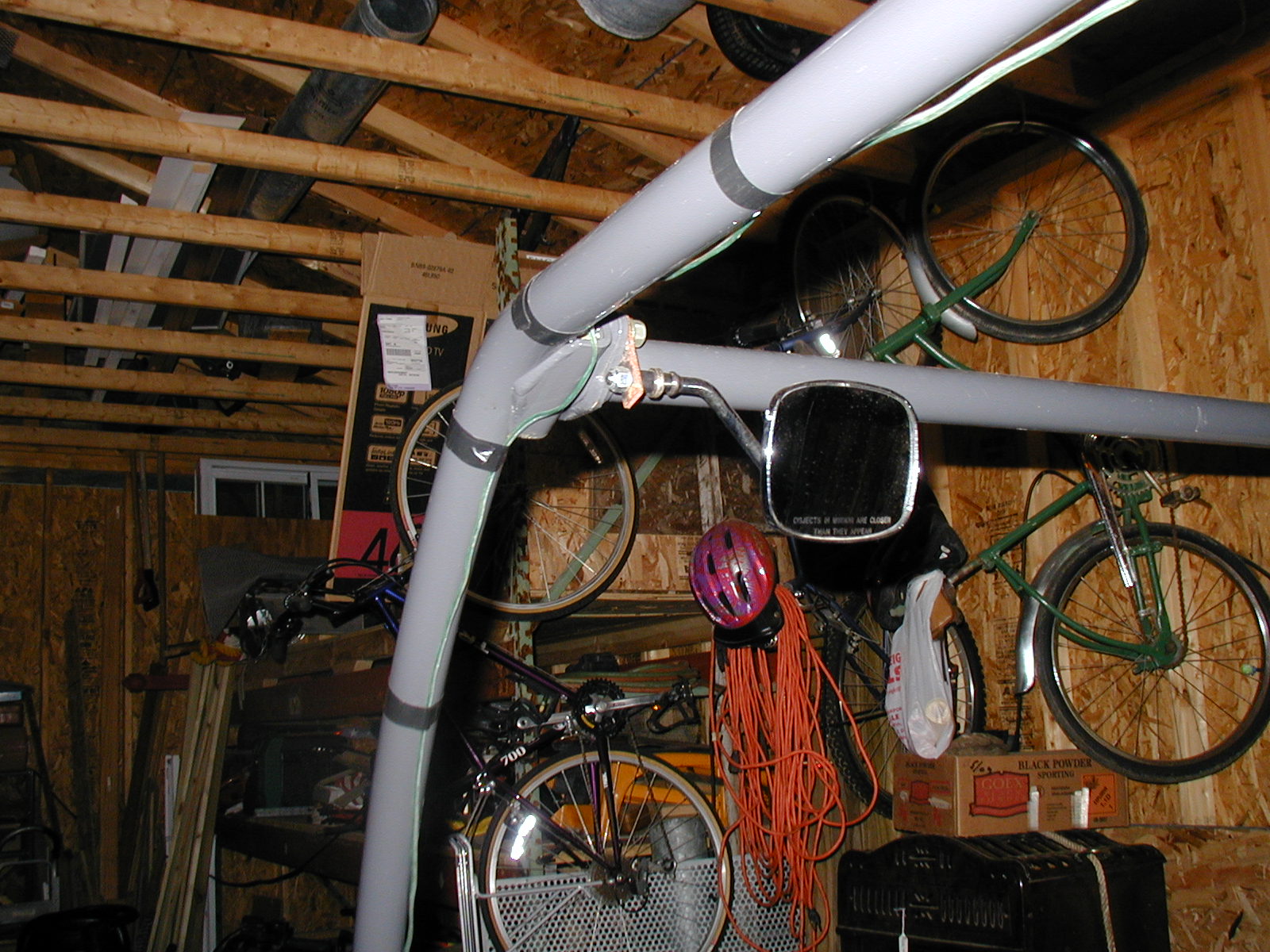

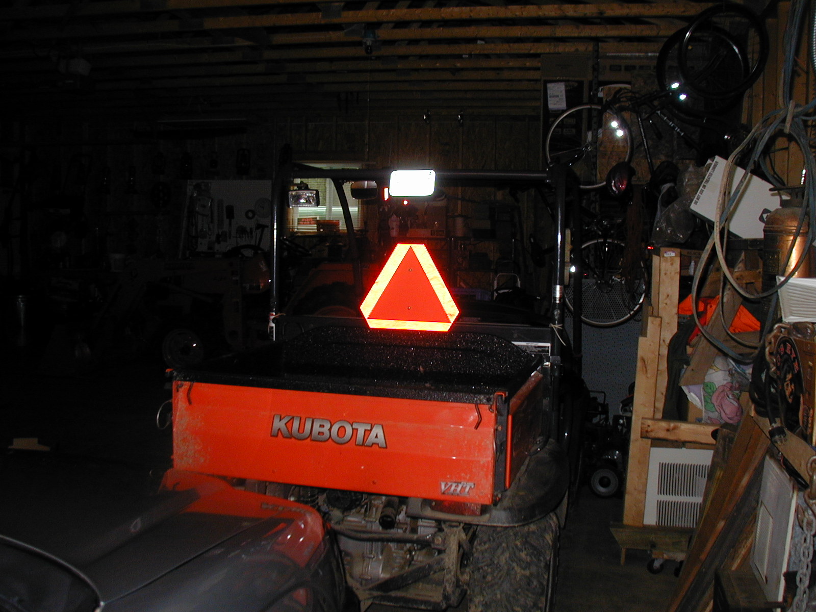

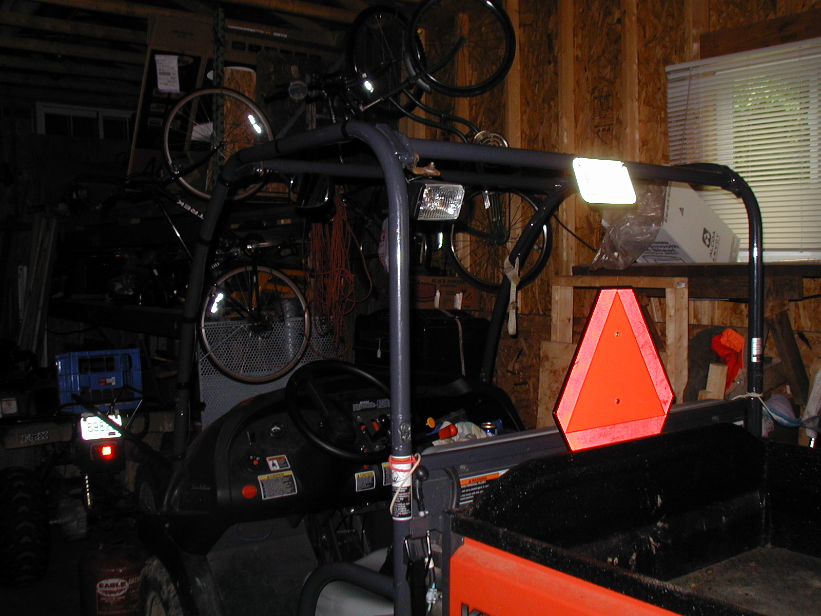

Here is what I came up with for a cargo light, mirror and SMV emblem.
Replace with longer bolts in the ROPS to hold the brackets on.
