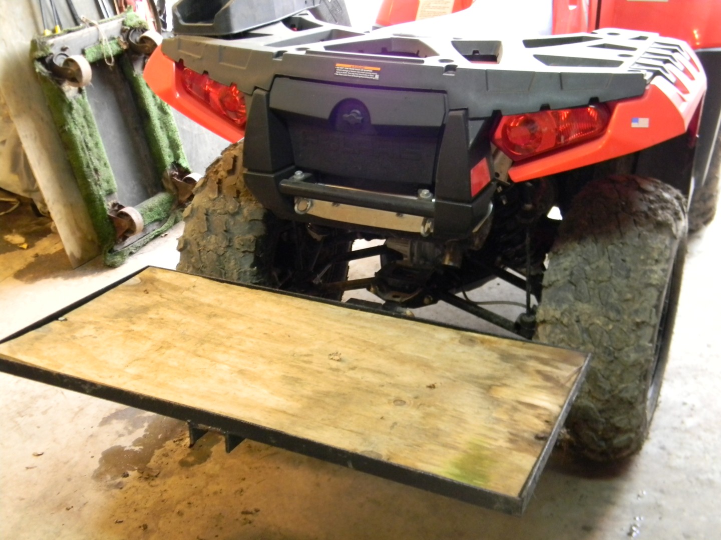

Have a Polaris X2 with a small receiver hitch. One thing I really dislike about Polaris ATVs is the worthless plastic rack system. It is really hard to carry anything or even to bungee loads. I am thinking of building a small tote to quickly plug into the receiver to carry tools, especially my Stihl Kombi pole saw or regular chainsaw. The pole saw just is impossible to carry easily and be able to quickly access it. Any ideas or previous clever ways to carry long tools like that?

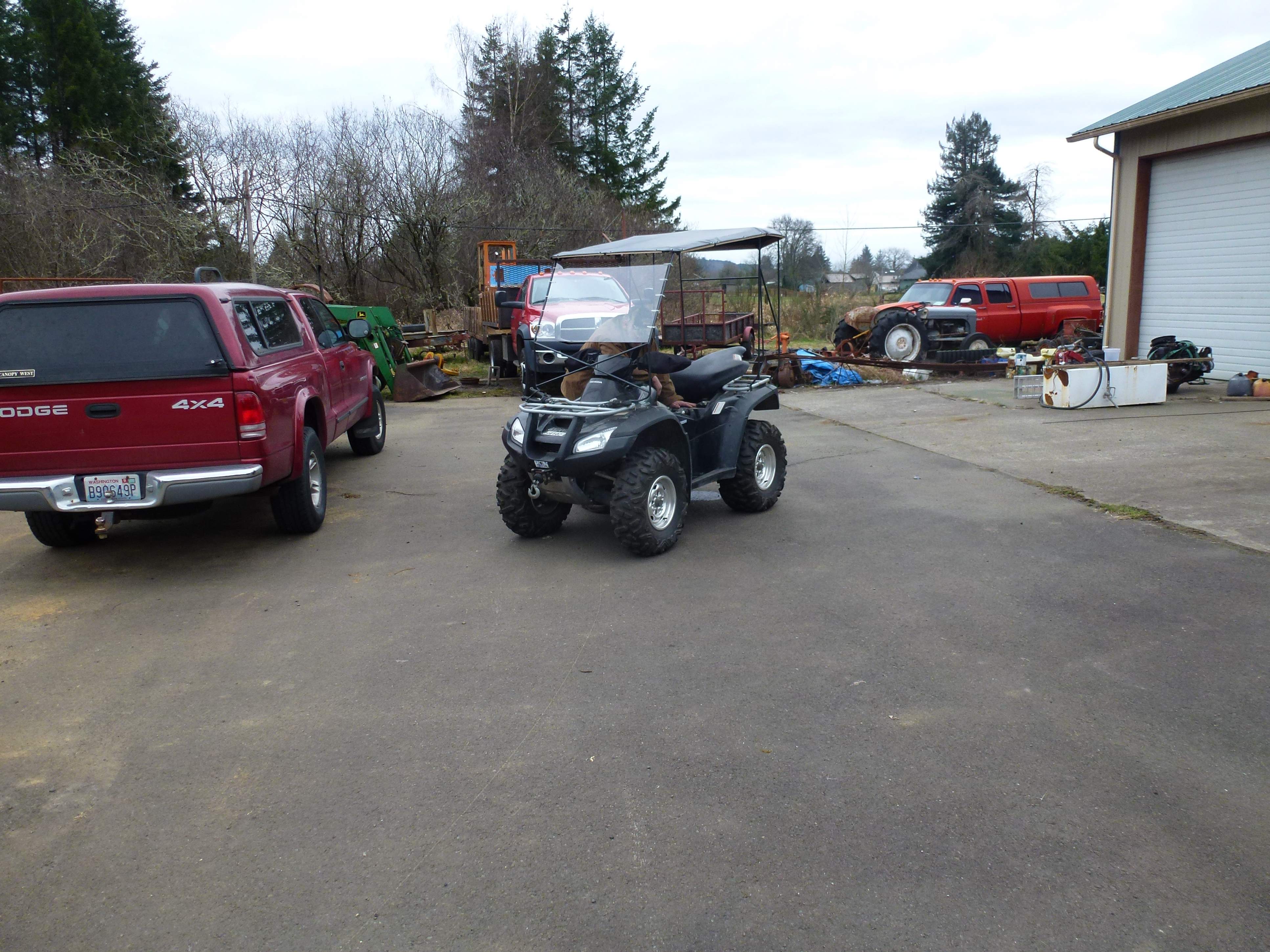

Not familiar with Polaris. I built a box that rides on the front that I can put a chainsaw in plus other tools. alaska and tractor logging 046.jpg
The box sits just below the windwhield and the width of it.

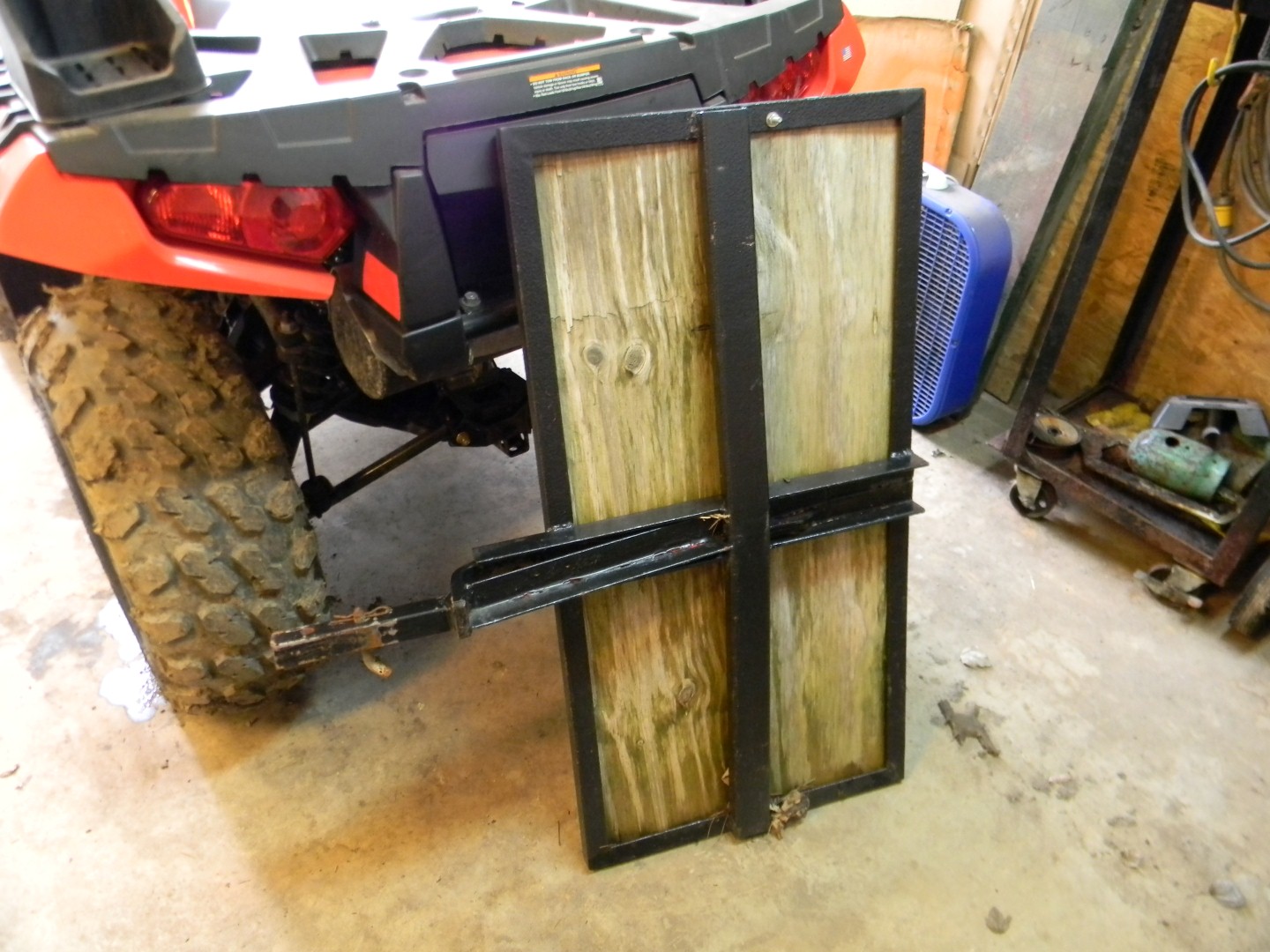

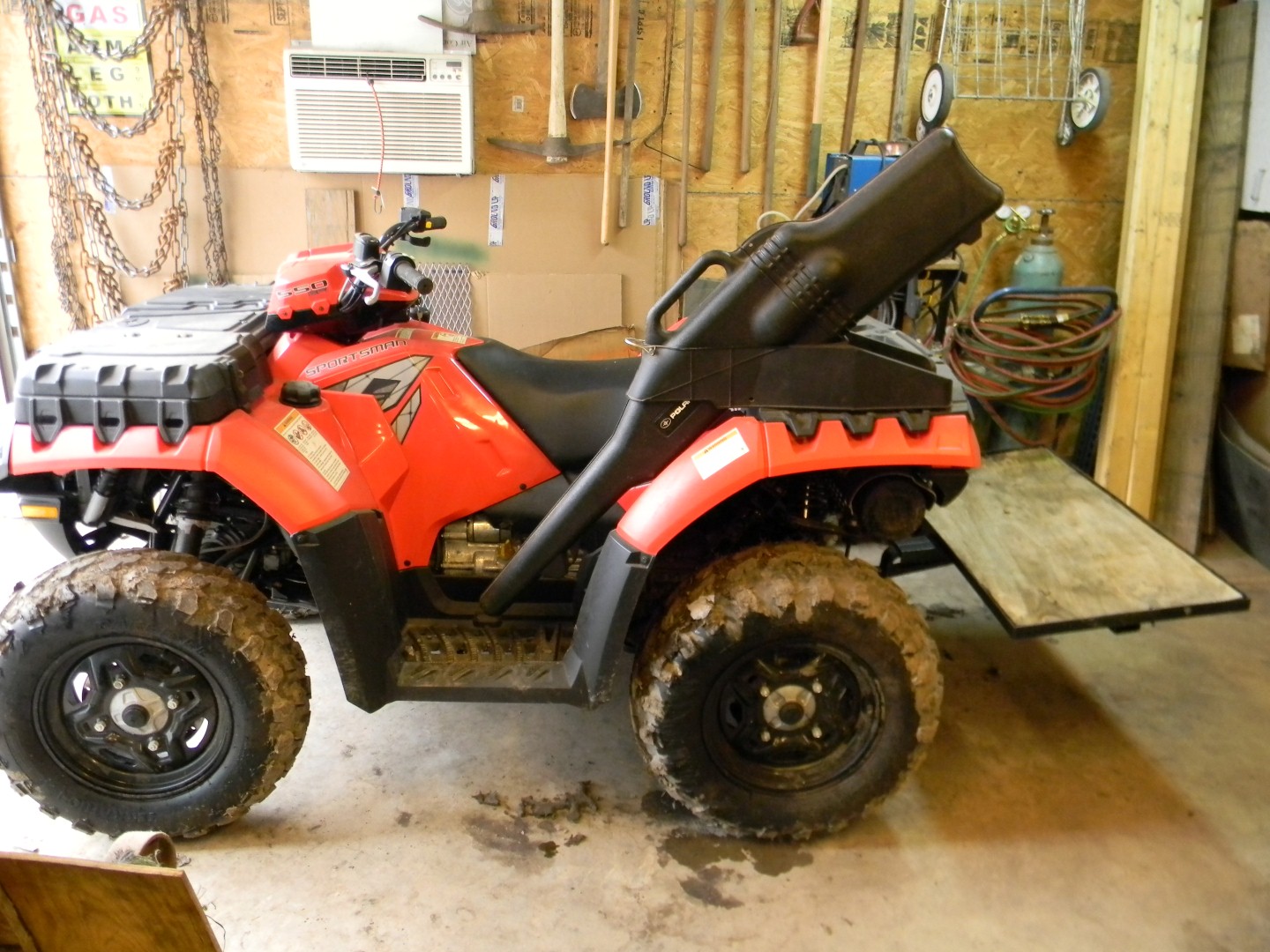

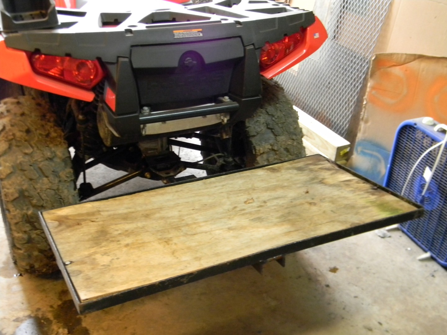

I made a 2'x4' (actually about 44" wide, which is slightly less than ATV wide) rear shelf to plug into the hitch on my Polaris Sportman 550 EFI.
I built it for hauling deer out of the woods during hunting season but could use it anytime by strapping on a large plastic tote to hold tools and things.

Thanks. That's what I was thinking. If you have any pictures, that would be great. The Polaris has the plastic rack that has the 1" holes. They make a rubber expansion "plug" that allow attaching accessories, but it's (in my opinion) a poor design. So I was thinking of making a rack that inserts into the hitch like you did. I carry my pole saw regularly, and I wanted to make a bracket it attaches to quickly. I ordered some of the Kolpin gun racks so those may work. But I use my cover and these will not work under my cover, whereas a rear hitch rack would.

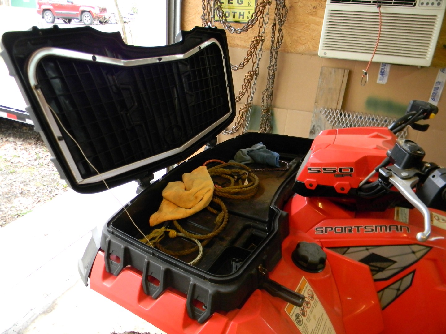

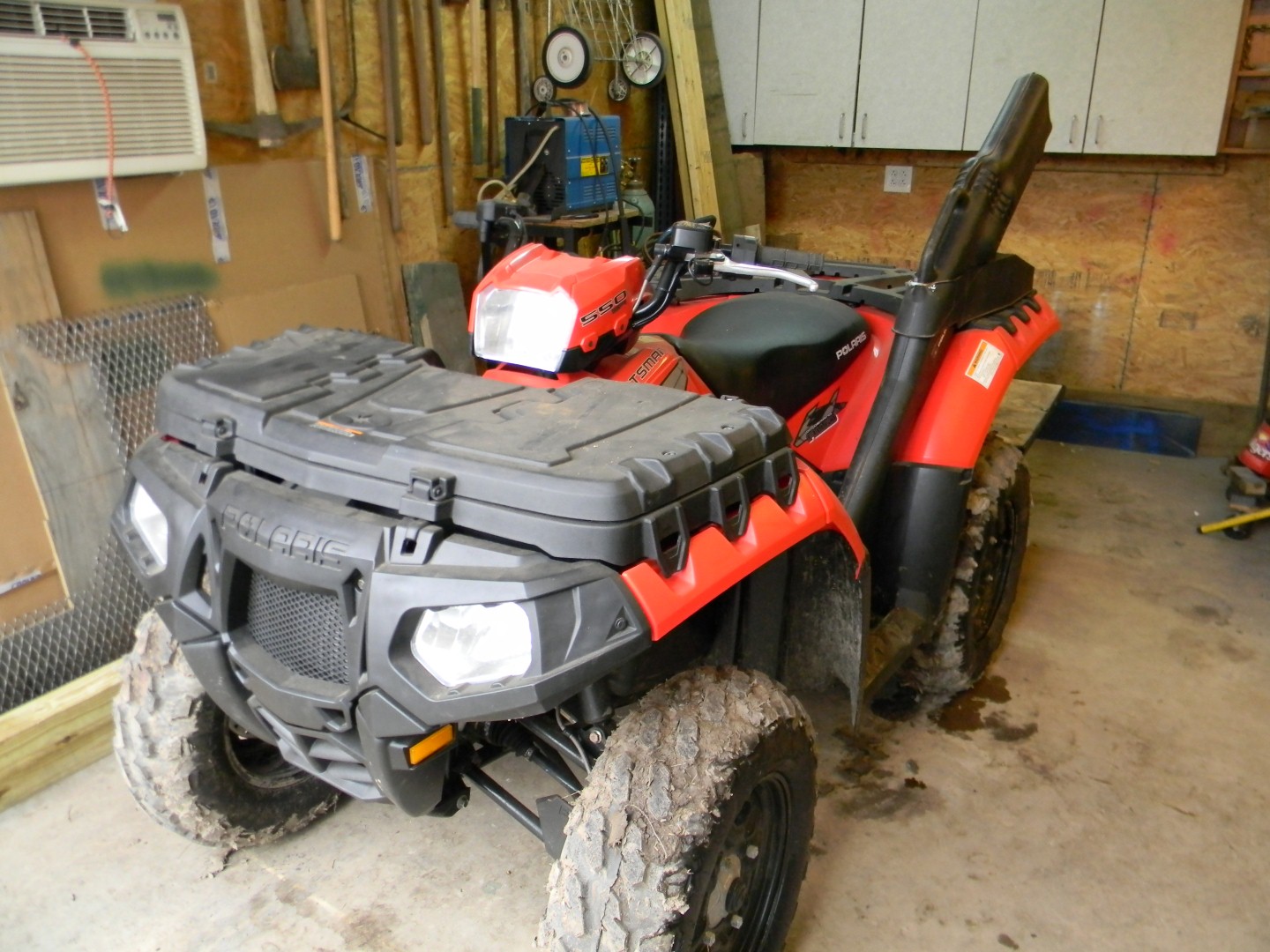

I do have the front mounted storage unit but its only about 4" high. Good for storing rope, straps some tools etc. Also have a rifle mount that u-bolts onto the back rack.
I made the carrier out of scrap metal I had laying around. Some 1" angle, C-channel, !" square, etc. Bolted a piece of plywood in the frame. There are holes drilled around the frame for bungee cords. I can put a large plastic tote on and attach with bungees. The gun rack is a Polaris that bolts to the rear rack with J-bolts. Front storage unit also Polaris with the expanding rubber locks that hold it on. I've had about 300 lbs on the rack with no problem.

Here is the none I built for my four wheeler it folds up against the back of the wheeler when not in use.

Thanks guys! I think I'll make one like yours. Appreciate the pictures!
