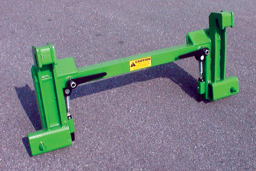

Just bought a Melroe utility/ manure bucket and need to adapt it to my JD loader. I have hooks and pins I could weld on, but hate to mess up the bob tach. So I am looking for ideas to make an adapter that stays on the on the bucket.
Thanks, Jeff

Thanks Mike, looks like something I can get ideas from. The +$900 price they quoted me is little much to spend to make my $100 bucket fit though. :)

Well I got a start on it today, hope to get it finished up tomorrow.

Got it mostly finished, needs paint but I need to clean the barn out.
Tractor side
Bucket side
Looks strong enough

Thanks IntervaleFarms.
It worked great
