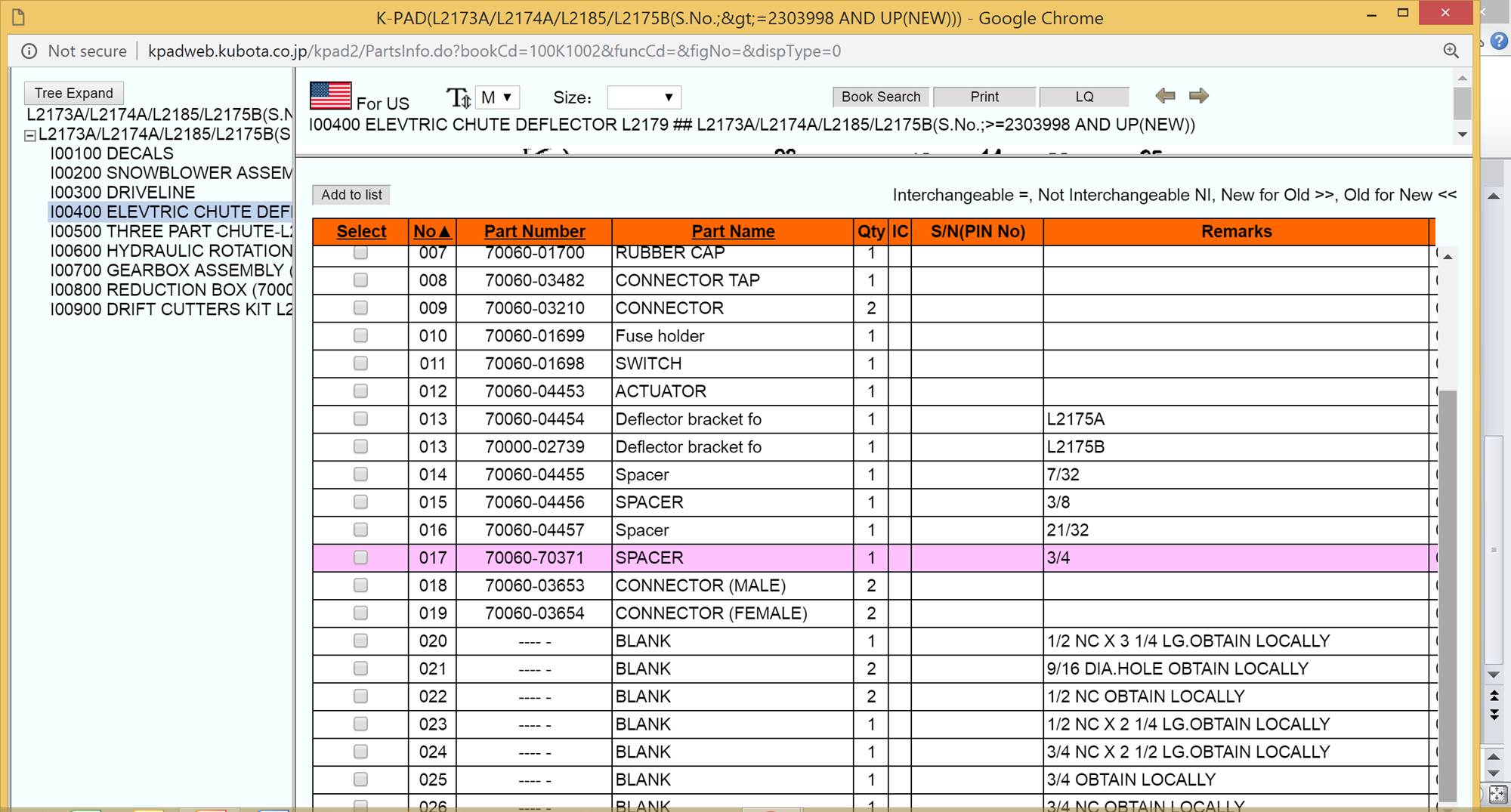

Has anyone installed a electric chute deflector on a L2185A front mount snow blower? If so where did you buy the bushings needed for mounting. The bushings are 3/4" O.D. by maybe 3/4" long with either a 1/4'' or 5/16" bolt hole.

Not certain which spacer/bushing you're looking for, but the drawing for the kubota electric actuator does have one called out.
Part Number 70060-70371
Vendor Kubota
Messick's Price $9.76
It's consider a SPACER
The part fits the 3 models listed below:
L2173 / L2174 / L2175(S . No . ;>=2003368) (62" HEAVY DUTY SNOWBLOWER)
L2173A / L2174A / L2185 / L2175B(S . No . ;>=2303998 AND UP(NEW)) (62" / 72" HEAVY DUTY SNOWBLOWER)
L2179-A (ELE . CHUTE DEFLECTION KIT)

Thanks for the info. I will that a look at that. I'm looking for the spacers that goes in where the manual chute deflector arm goes to mount a electric actuator I had mounted. One of the bolts broke while blowing snow and I couldn't find it and I could not remember where I bought them. If this spacer works it will be the high price. :( I like Messick's but their prices and shipping are a little high IMO. Thanks again for the tip.

You can find a drawings and parts list for the electric chute kit using Illustrated Parts on Kubota's website. (Direct Link to drawings doesn't work or I'd supply the link)
Perhaps the attachments will help.

Thanks to all the help. I ordered two sizes of spacers as my electric actuator as not from the Kubota kit. Also, I deal with Coleman Kubota Parts as their parts price and shipping are below Messick's.
