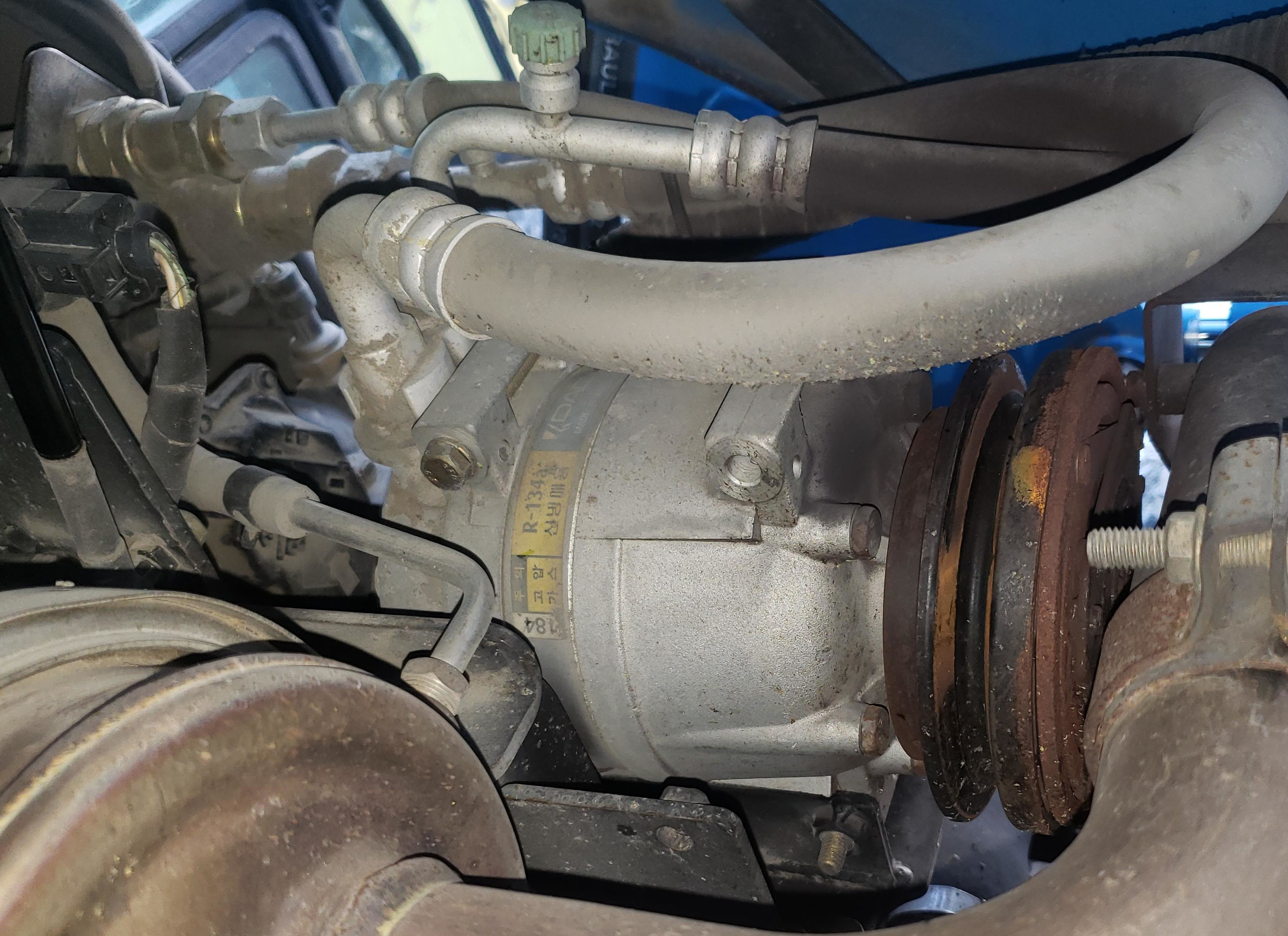

I have an XR 4140 HC and the AC compressor locked up. I was told they use a pretty generic AC compressor, so I don't want to pay the dealer $600 for one and wait on it forever.
Has anyone done this? I would really rather use non-LS parts to fix it.

Take the compressor to a NAPA store and see if they can match up the mounting and shaft with one of their stock units. With their military or fleet discount you are looking at <$300. If it is a common brand used in the auto industry it should not be a problem NAPA has been my go to place for 50+ years.

It a good chance you have metal contamination all through the system if so you will also need the dryer expansion valve along with the compressor and cleaner to clean the system.
   / Has anyone put on an aftermarket AC compressor on their LS tractor?
Thank you all. I will try these options. Here is a pic of the compressor in case someone knows it right off.

The compressor you have, is it from LS or did you find aftermarket parts? I found that the LS compressor is a KDAC and apparently is only available in Korea or something like that.
AC guys say they are not very good and its better to get an aftermarket one, but I can not find an exact match in an aftermarket one. How much do you want for yours?

That compressor probably has a brand name and model number on it you can use to search for a replacement.
I just eyeballed the ports, pulley type, and mount on my NH backhoe and bought a generic Sanyo compressor to put on it. My compressor was missing from the tractor when I bought it. I pulled the expansion valve and drier off so I could blow the system out completely with nitrogen then put it all back together. Ended up having to replace every hose also because they were seeping out the walls. Getting the expansion valve off was a PITA and doing it twice was NOT fun.
I think I got the compressor off eBay for less than $200.
Yeah, the compressor is a KDAC compressor and they can't cross reference it to anything really, but I was told its very close to this one: AP Air Inc - New V5 Daewoo Single Groove Compressor
Its about $300 for that one, but the compressor already has a bracket made for it so that it can bolt on the engine. I am thinking about taking that bracket off and making one to fit like a universal sanden 508 or something. You can get a 508 for like $99.

You might get a Chinese Sanden knockoff for $99 but the chances of buying a genuine Sanden for that price are extremely slim. You may not care, but at least know what you are buying.

BTW, I have found the aftermarket replacement AC compressor for my tractor. Its the same compressor they put on the 1999-2002 Daewoo Lanos. I ordered one on ebay for $120 new.

Pretty much a worthless video. Replace the compressor with an aftermarket one, flush the system, pull it down with a vacuum pump, add some PAG 46 to replace the oil lost in the component change (If your tractor takes PAG 46 that is), recharge with R134a and call it good. I'd add some fluorescent leak detector as well. When you replace the compressor, renew the 'O' rings as well. Not just any 'O' ring either. Refrigeration systems take specific 'O' rings.
You will have to determine the correct amount of 134 from LS, too much and it will destroy the compressor or rupture a line. Too little and it won't cool properly. Because the compressor locked, I'd say you also have metal in the receiver dryer to. replace that as well. That compressor is a piston compressor. Scroll compressors are smaller and not as long physically.
I'd be cleaning the rad and the evap under the hood as well and probably the condenser under the cab roof too.
