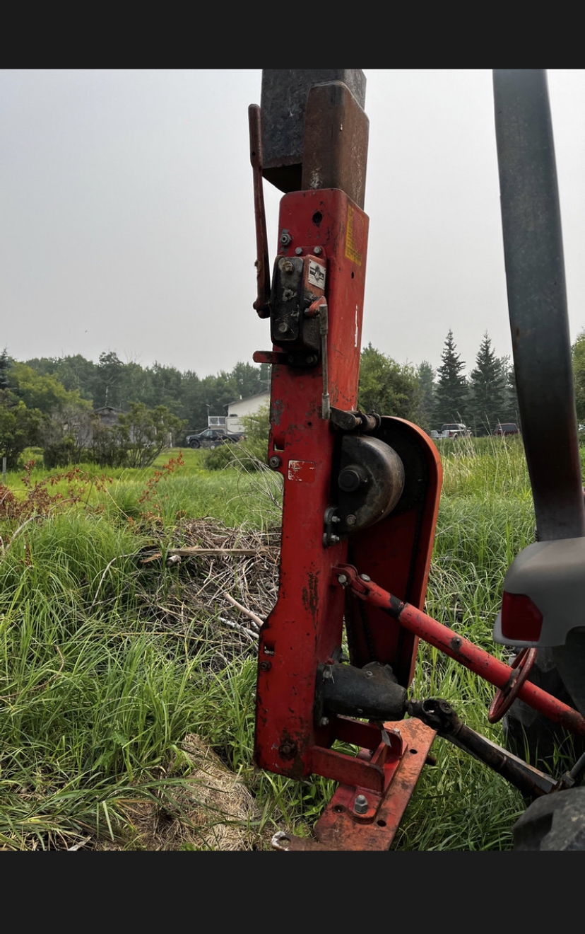

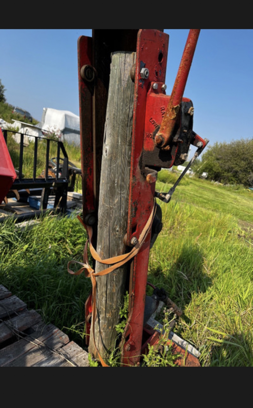

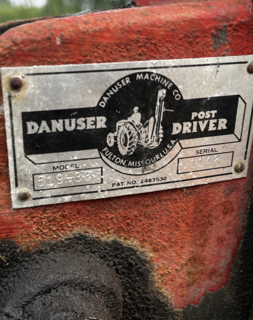

I’m considering buying one of these post pounders but I’ve never seen this style before and can’t find any feedback about it online.
Is anyone here familiar with this brand and/or make/model?
It’s a 3-pt hitch mount and looks like it would be very handy. I’d just like to find out more about it before buying it.
It’s a Danuser, model# 519-33

We had one years ago on the farm. Wish I had kept it. But it was sold when my dad stopped farming. I like it better than a hydraulic model. The biggest maintenance issue is the drive wheel and I do not know if parts are available for it. We never had problems and drove a pile of posts with it. It does not have the lateral & tilt adjustments like a hydraulic unit can. W.Jones

Hmmmmm… not sure how I feel about the lack of tilt adjustments?!?
I’ve used a hydraulic one quite a bit and was always adjusting it.
You didn’t find that much of a deterrent?
Thanks.

I had one years ago also. Got it at an auction pretty reasonable. Lack of tilt adjustment on rolling land made it nearly impossible to drive a post in straight. The drive wheels were made of laminated belting like material. Being used the drive wheels had weathered and wore quickly. Got frustrated with it and sold it
10 years later, bought a good, very little used Shaver HD-8 with hydraulic tilt. My neighbor had boughten a HD-8 with manual adjust tilt. Watched him drive around 100 posts and was constantly cranking on it. He told me if he had to do it over, he'd have gotten the hydraulic tilt, so that is what I looked for when I got mine.
I mounted it on my little '65 Ford 2000, being it was a one man job, wanted something easy to get off & on when aligning the line of posts. I'm pretty particular having a straight fence line. I drove around 400 5" posts with it through a mild winter when the ground was softer, had to in the shaley clay. Used 6" posts for braces and corners. Drove a little slower, but sure beat digging/tamping in by hand. Once lined up, kept it straight using a pocket level to keep it plumb. Only maybe 6 or 8 were not straight due to hitting larger rocks down a couple feet in the glacial till. Found out soon you're not bring it back to being plumb when that happens. Directions for them back then said not to sharpen the posts to make them drive easier. I did a couple tests posts before starting, sharpening one. The sharpened one did take off on its own driving crooked, and I had the point pretty much centered. The flat bottom post drove straight.
Only broke one spring on it during that time. A local John Deere dealer handled parts for them but was pretty expensive. Looked on the internet and found them for half the price at Kencove fence supply. I bought 2 figuring the other side may go at any time. Never needed it as the other side lasted through that job. Glad I did, just checked Kencove, and that $80 spring is now $292.00.
I still have it stored in the barn for just in case someday. It's not eating anything. If I never use it, it will look good on the sale bill someday.
