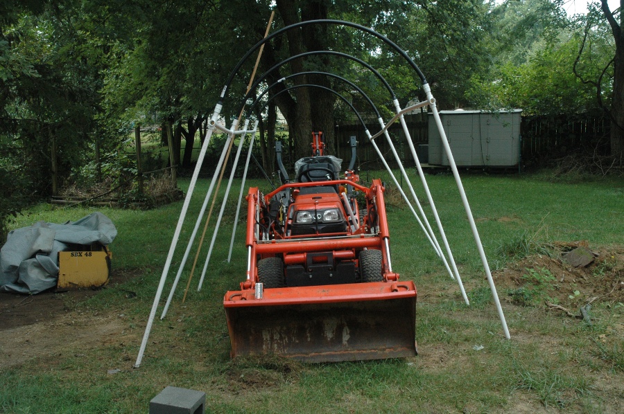

I had a "home built" and then a Shelter Logic, both for my B7610.
The shelter logic was great until a real strong wind gust picked up one end, twisted and ripped it.
But before I got the Shelter Logic and for about the same cost I built a frame out of white PVC plumbing pipe, 1x2 pine, ductape, black plastic coil pipe, rebar, and HF tarp. I built it along the lines of an Iroquois longhouse with a curved roof.

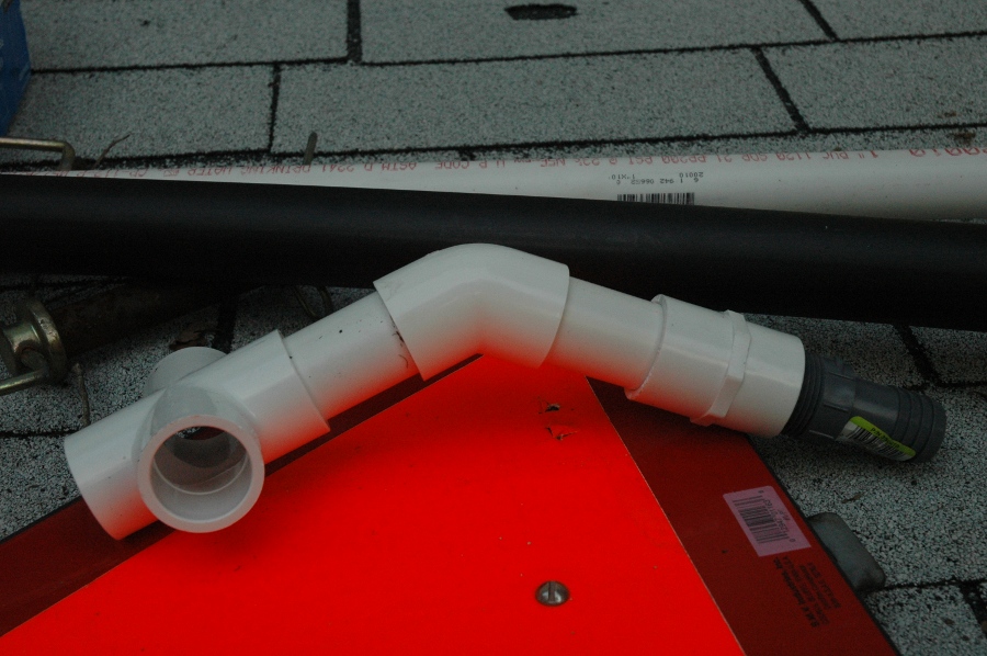

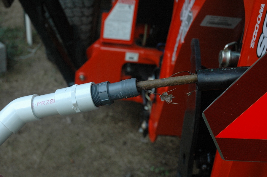

At the top of the "wall" I put a cross T, a very short section of pipe, a 45 degree elbow, an adapter to go to black pipe and a barb for the black pipe.
attachment.php
For the roof I used the black pipe (to form the correct curve) hooked into the 45 degree elbow. I jammed a section of limb into the pipe to help maintain structure.
attachment.php

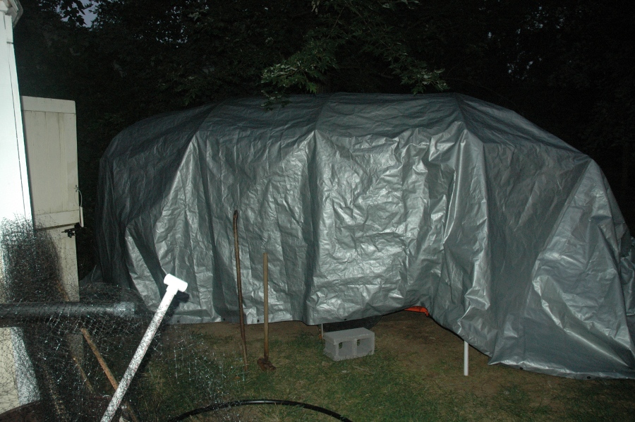

I then used a heavy HF tarp stretched tightly across the frame.
attachment.php
Worked well, shed rain well, seemed to take strong wind, was extendable. But I was on travel often and a one time extremely heavy wet snow stuck to it, nobody brushed it off, a second snow came along and it collapsed. Total damage was 2 or 3 broken pieces of pipe.
Engineering the structure involved setting up a few pieces, shaking it, deciding it needed to be closer together or farther apart, repeat.
Based on my success with that SWMBO authorized the Shelter Logic and I've been reusing the pipe, rebar etc. for years.
