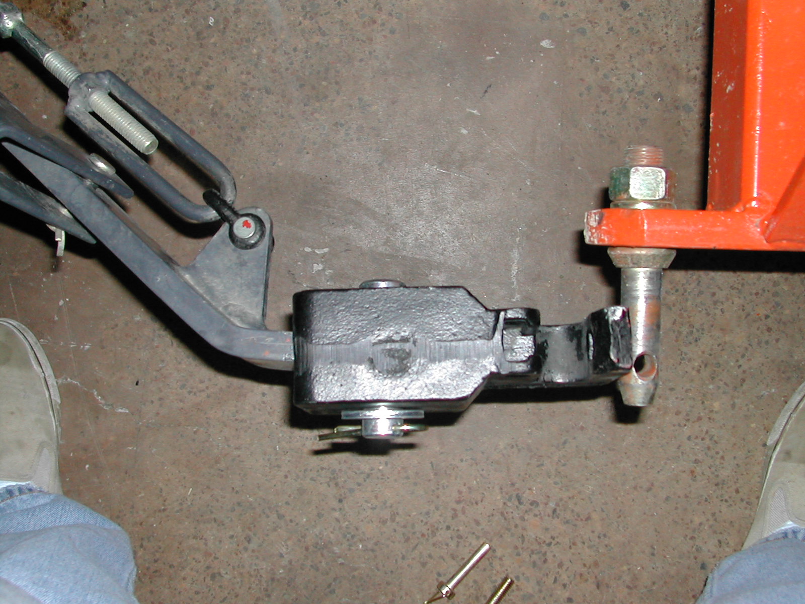

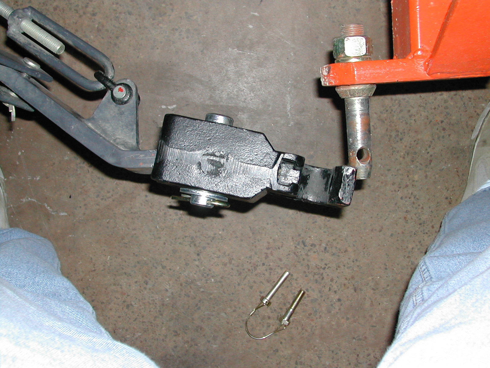

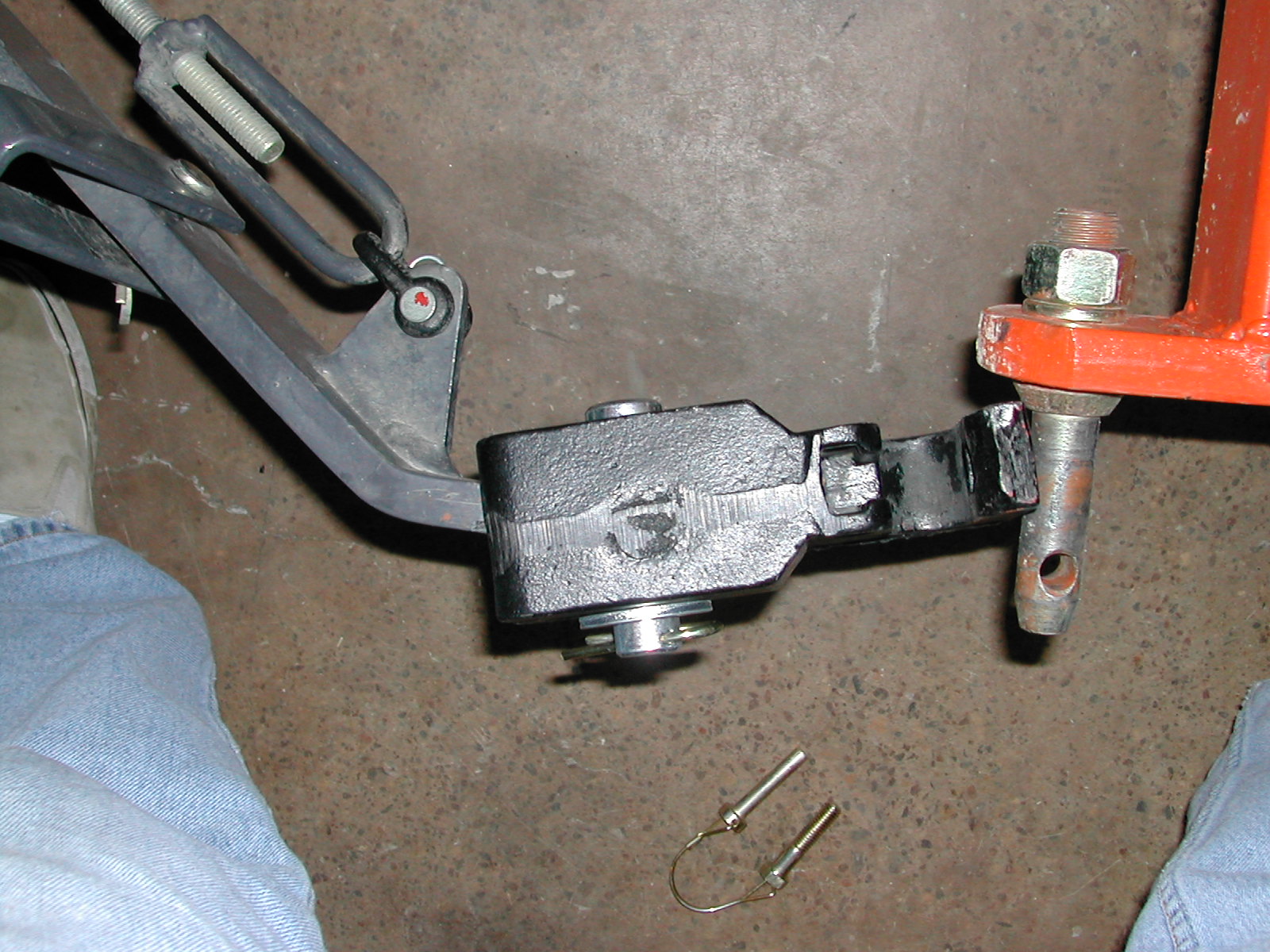

JJPP said:
I bought these last month and they work OK. With a some modification they can work better.
Take a look at these photo's. Out of the box they sway side to side and tend to hang down about ten degree toward the implement.
For the money there not bad, but then again I was hoping for a little better fit.
