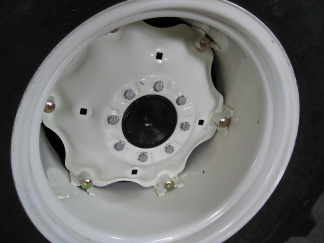

Roto,
The specifications section of the owners manual gives you the wheel tread settings for each axle and type tire. Depending upon which tire you have there are multiple positions (e.g., R1 AGs have 6 available positions and about 20" min/max diff.) along with the nominal change per position (usually about 4").
This pattern on my R4s is probably similar to yours and gives me a width of 33.5" inside to inside (513/8" center to center).
I helped a neighbor swap his fluid filled R4s (sorry no photos available) and it is definately a two MAN evolution to avoid letting those monsters get away from you.
You can see the bolt pattern on the dish allows additional width positions besides just swapping sides of the tractor to keep the tread pattern the same.
Good Luck and get a strong buddy.

MadDogDriver Quote: This pattern on my R4s gives me the narrowest available width of 33.5" inside to inside (513/8" center to center).
Looks like there is one narrower position available if the tires dont hit.

Yeah, it looks that way to me also, but not from the inside. That's as close as you can get with R4s, plus that center to center distance matches the operator manual's narrowest setting.
Mike, didn't mean to imply that you weren't aware of the positions or the manual, sorry. I realize we have a wide array of expertise as TBN member and guests, just thought the photo/info would help those that were interested. We've used the BH as well, nice floor jack huh? Still found it usefull to have someone keep that tire balanced while playing with it, cause once it starts leaning too far, as you know, it easily becomes a losing effort to hold on to it. Wish I had a photo of my neighbor's tires, cause I think they'd be what you were looking for. He flipped the fronts as well as the rear.

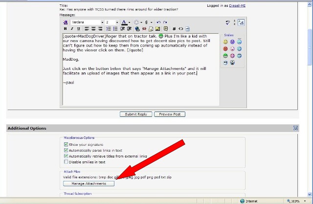

Roger that on tractor talk. :D Plus I'm like a kid with our new camera having discovered how to get decent size pics to post. Still can't figure out how to keep them from coming up automatically instead of having the viewer click on them. :confused: Wish there was a discussion section that just gave the gouge on how to use all the features and sections.
Being that your 55 is much larger than my 40 I can see where you get the 8/7 settings vs my 6/5. I can't use those last two positions that you can because they'd be way too close together. Since your tires aren't loaded, do you use wheel weights when you need the additional rear stability/traction?
   / Has anyone with TC55 turned there rims around for wider traction? #10
MadDog,
Just click on the button below that says "Manage Attachments" and it will facilitate an upload of images that then appear as a link in your post. See my attachment for a pictorial :)
~paul
